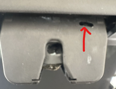

Hi all,
is there a way of manually opening the boot on my Tourer when the battery isn't in the vehicle?
The normal method isn't working.
It's a non electronic open and close system.
cheers.

Yes, in the handbook I remember it shows how to release the boot lock....you have to get inside the car to do it.
Like this...slightly different if I remember correctly but basically similar :)

Thanks for that. I shall give it a try and report back :)
