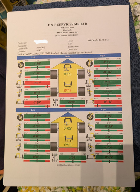

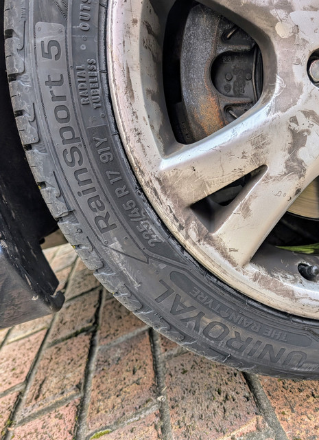

Finally!
Immediate and marked difference to how the car drives. It's vastly more stable in a straight line now, rather than needing continual corrections to keep it pointing the right direction.
If you'd told me a few years ago that I'd need to get recommendations from someone in the trade to find somebody who can set wheel alignment properly I'd have laughed. These guys are primarily a Jag specialist, and is one of those buried in an industrial estate types of place you'd never find unless you knew it was there.
The vibration at speed is (unsurprisingly) still there. Looking closer though there's no point in getting the wheels balanced prior to putting new tyres on. Both offside tyres are down to the wear bars on the outer edge, as is the nearside front. What I hadn't spotted until today and the car was up on the ramp though was that the nearside front is *really* close to wearing to the cords on the inner edge. There's also a fair ding in the rim on that wheel. Nearside rear one has clearly been replaced at some point as it's less worn and a different tread pattern to the others.
Anyhow, new tyres have been ordered and will hopefully be fitted on Monday. I feel bad that I'd not spotted how bad that nearside front one was. I guess that's one of the curses of such wide tyres on a car where they fill the arches so much - seeing the inner edge properly any time other than when the car's in the air is near impossible.
The nearside rear tyre still has some life in it, so that will be offered on here for cheap if someone has use for a part worn 225/45 R17 tyre. I could keep it, but I always prefer a matched set wherever possible.
Hopefully that will finally restore smooth, vibration free cruising.

Great result, they clearly know their business, how much did it cost and how long did it take Zel?

Was actually on the ramp just over an hour - which is the big difference to the 15-20 mins most places would give to the job. Think it was £99 including VAT. Yes dearer than a fast fit sort of place, but I'd far rather pay that for the job done right than £50 for it to be vaguely waved in the direction of an alignment rig, which looks to be what was done last time.mickthemaverick wrote: 05 Oct 2024, 07:29 Great result, they clearly know their business, how much did it cost and how long did it take Zel?![]()

That sounds like b****y good value to me!! Well worth seeking out the people who really understand their job!!

Exactly my take on it. I'm always happy to pay properly for a job to be done right.mickthemaverick wrote: 05 Oct 2024, 13:11 That sounds like b****y good value to me!! Well worth seeking out the people who really understand their job!!![]()

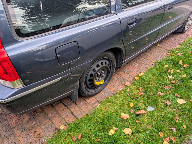

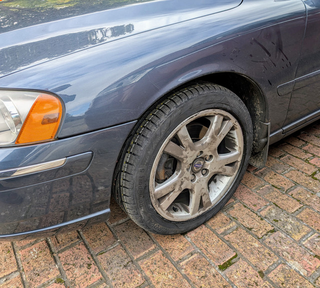

With the alignment finally sorted it was time to get new tyres fitted to the Volvo.
My usual choice.
Wait a minute, what's this nonsense?
Nothing is ever as simple is it should be is it? Turned out we found a crack in one of the wheels. Given she's a heavy old bus running on 45 profile tyres on these roads, I can't really say I'm massively surprised. Of course this isn't the same wheel as we've found a buckle in is it as that would be too convenient.
The guys in the garage however have been really good about it. They're adamant that they can't prove it's not damage they've caused while changing the tyre (though how you'd crack an alloy changing a tyre unless you do something spectacularly ham fisted with the machine I've no idea). As such they're insisting on getting the wheel repaired at no cost to me. They really didn't have to do that. Hopefully we'll have the wheel back either end of this week or early next week with the new tyre on. They really didn't need to do that, so I appreciate the gesture. Guess there is something to be said for being a very low stress repeat customer!
To be honest, getting them all refurbished is something that's been on my radar for a while now as they are a bit scabby up close. Not that you can usually see that for the half inch thick layer of brake dust (seriously, I've never known a car as bad for it as this).
Does mean I've not been able to ascertain if we've dealt with the vibration though as I'm limited to 50mph on the spare, and it doesn't turn up until past that speed.

What an excellent company and service Zel

Quite unusual for a business to step up like that.
