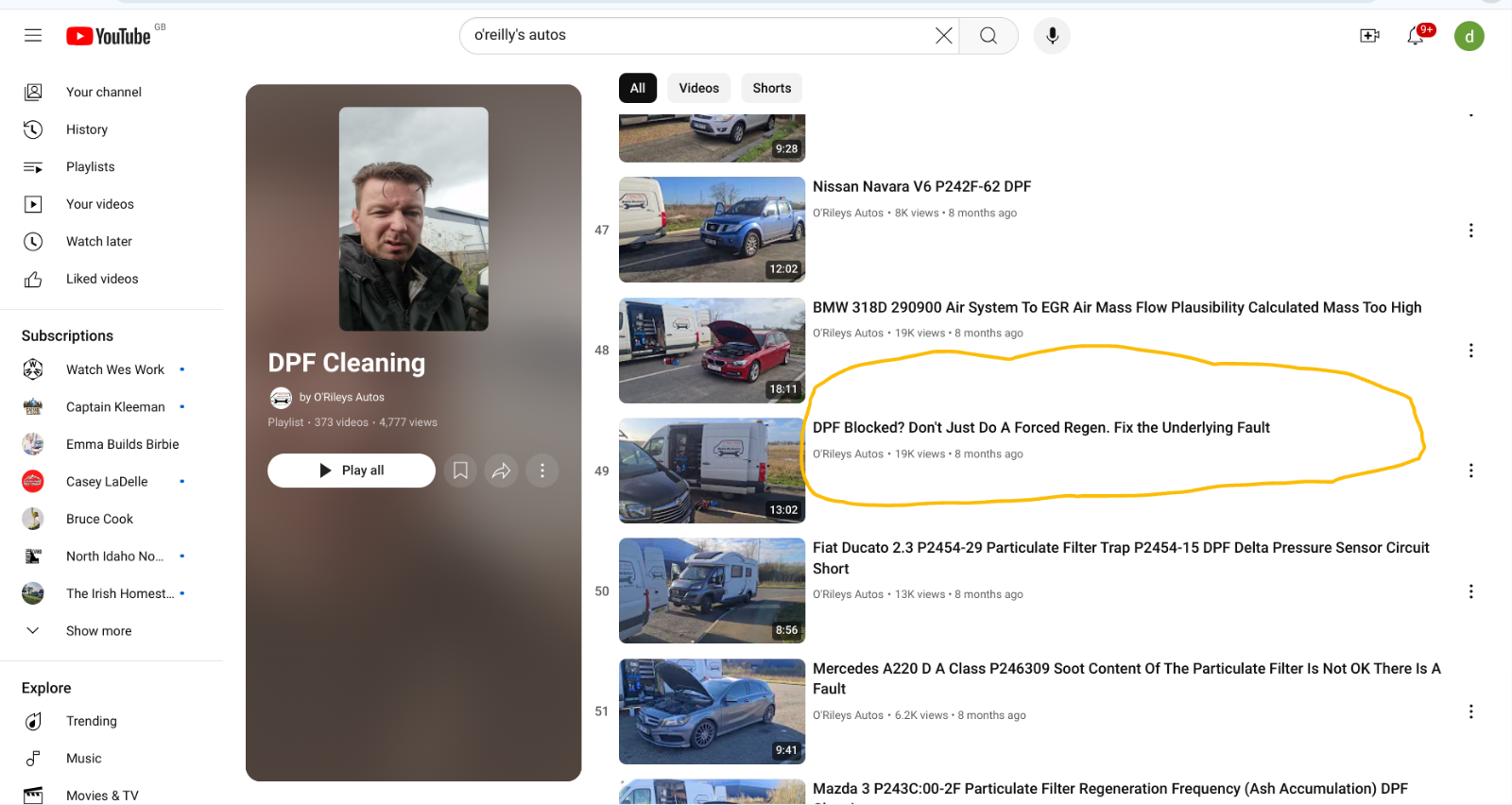

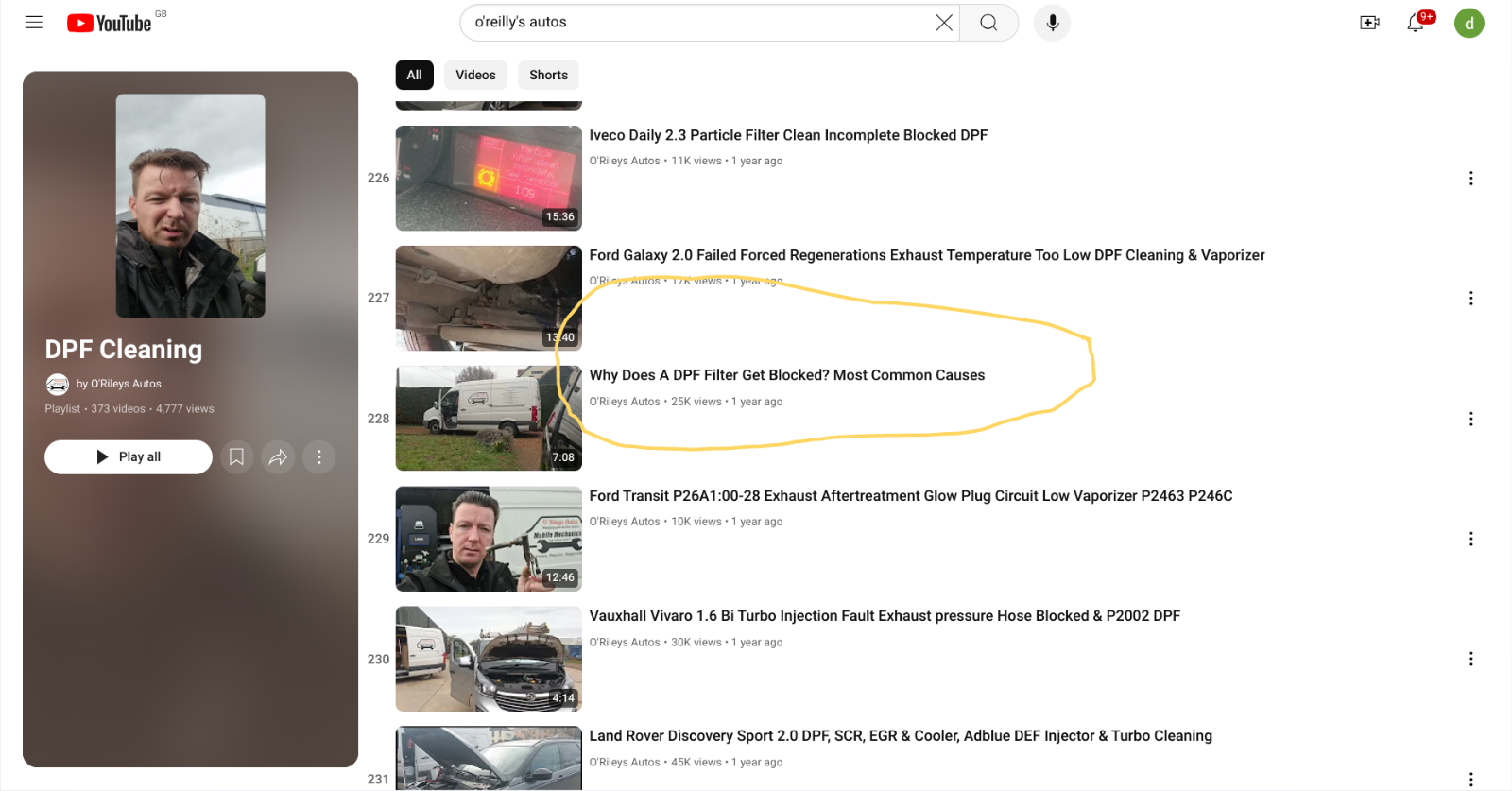

O'Reilly's Autos on YouTube has 373 posts on DPFs alone. While many of the videos are bit "samey", he does give some tutorials on the whys and wherefores of Regens and Cleaning. But there is one thing he stresses above all.
He has some nuggets of information in his years of Mobile Repairs and Servicing.
There loads more - how to's, general discussions of methods and outcomes, specific model videos.
Can be a long watch to find little or nothing sometimes, but I keep finding interesting snippets every now and again.
