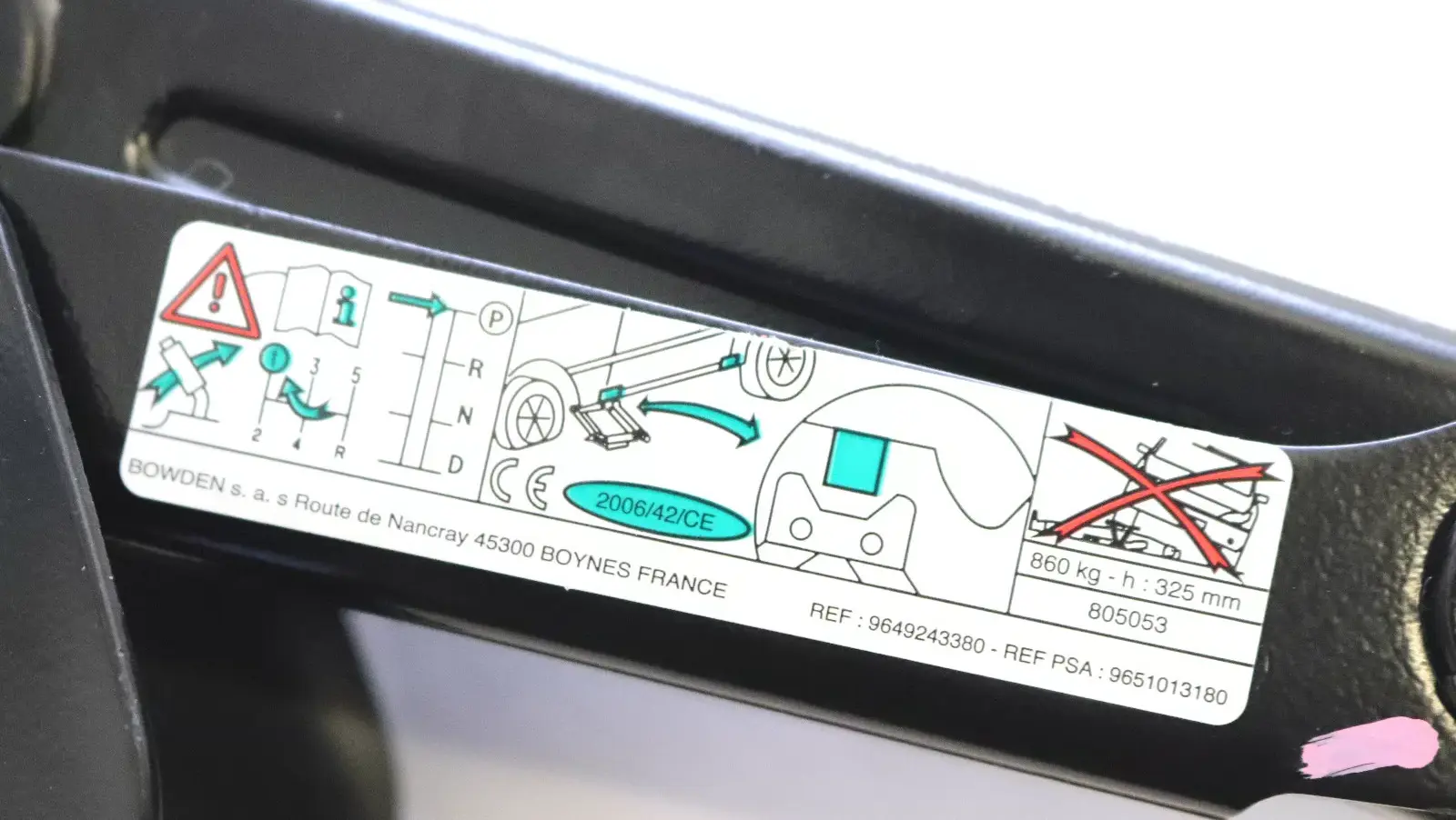

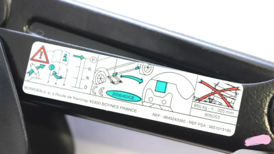

Diagbox says the lifting jack for my car is part number 6725.94
Searching ebay for this jack I found one that has this photo: So it seems it is rated at 860kg and a height of 325mm
- Posts: 42019
- x 6955
Re: lift jack - Grand C4 Picasso
Yes, that's the correct one for a GP with rear pneumatic suspension.
