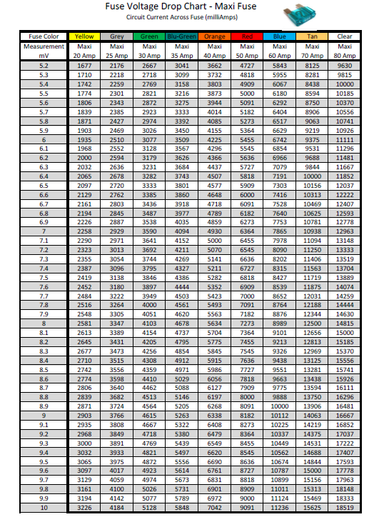

I attach a voltage drop chart for Maxi Fuses for reference. These are surely definitive in terms of load and voltage drop. Are these charts not the Holy Grail of voltage drop testing? I'd be very interested to hear your further thoughts on this, Wheeler.
Perhaps these actually over-complicate things?
