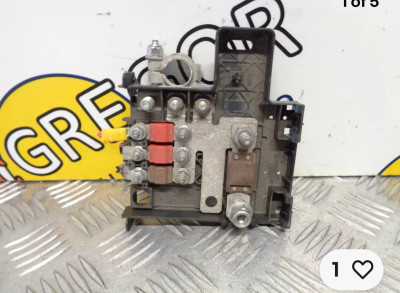

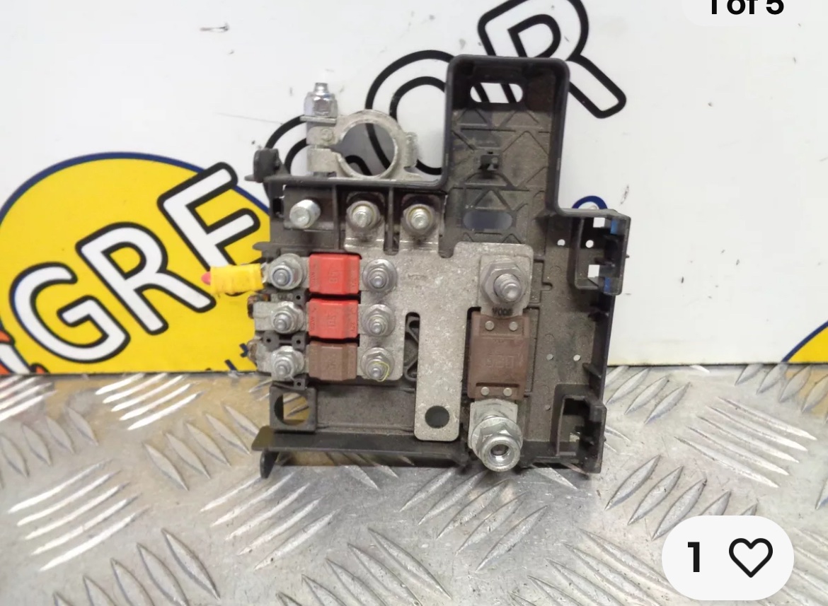

Re: Citroen relay fuses
Its on a little fuse box attached to the battery positive terminal, looks like this.
How can you tell which 1 blew?sorry for the daft question
wheeler
- Posts: 7894
- Joined: 21 Sep 2002, 19:07
- x 1044
Easiest way is to use a test lamp or volt meter on either side of it, If one side lights up/shows voltage & the other side doesent then the fuse is blown.
