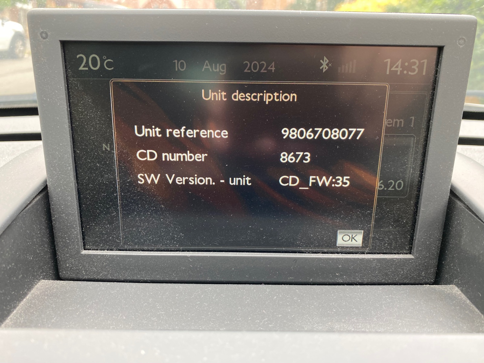

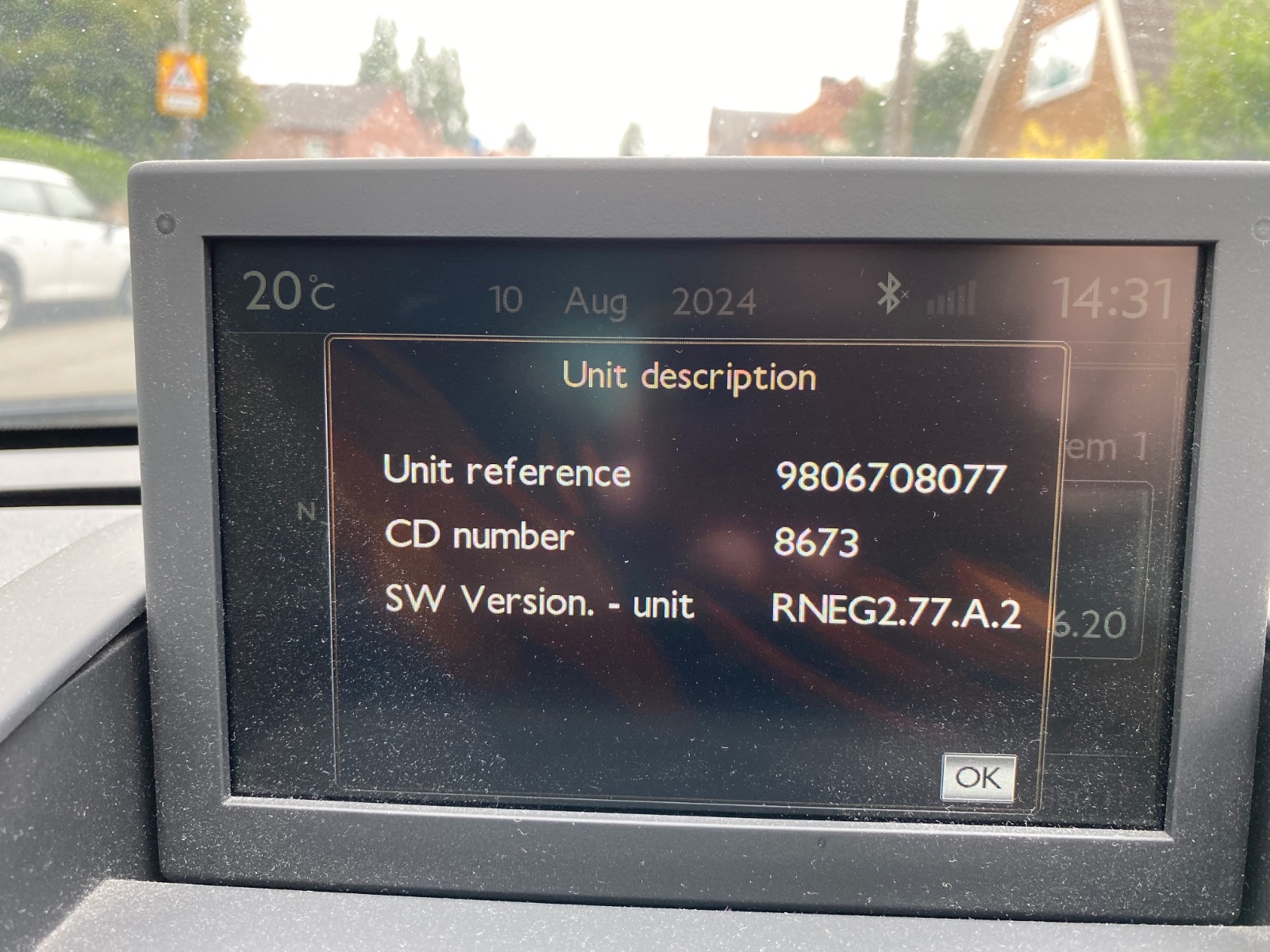

In case this is inportant, I think the head unit is on 2.77?
