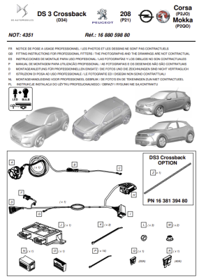

Ok, so I have the towbar - which is fine, but the wiring kit is incorrect. There is no part (1656244280) coming up as valid for this vehicle.
The correct part is 1688059880 (TOW BAR WIRING LOOM 13-TRACK ERICH JAEGER), which as you can see in the Sales Statements, specifically mentions the correct operation of parking assistance when towing.
VEHICLE COMPATIBILITY
- Compatible with caravans and trailers fitted with LED lamps or bulbs.
- NOT compatible with electric vehicles.
- For vehicles pre-fitted with the towbar option at the factory: The towbar harness accessory is not compatible. Please order the harness set out in the replacement parts catalogue (document/technical).
- Electric 208 not compatible
- 13-way towbar harness with blown bulbs detection.
- Harness compatible with all types of towbar (tow ball that can be removed without tools, swan neck).
- The electronic module supplied in the kit interfaces with the vehicle CANs.
- Use of the aftersales diagnostic tool is essential.
- This harness takes into account vehicle design rules and guarantees safety, reliability and durability for the customer.
- Easy to fit (connectors pre-installed in the vehicle).
- This harness uses a secure, reliable and durable electronic module to inhibit the parking assistance functions (camera or reversing sensors) when the vehicle is towing.
- This module complies with the regulations in force regarding detection of blown bulbs (direction indicators, brake lamps, reversing lamps etc.).
- This module supplies power to light the caravan and run the fridge.

Hi, yes, 1631689180 is the SIARR (supplier) for the towbar that can be removed without tools and is officially listed for your model (amongst other towbars too).
However, the part number for the electrics you have are NOT listed on Peugeot's site as compatible (it's just not listed).
The correct one listed for this vehicle is: 1688059880 (Erich-Jaeger)
Compatibility:
Technical characteristics
Compatibility:
