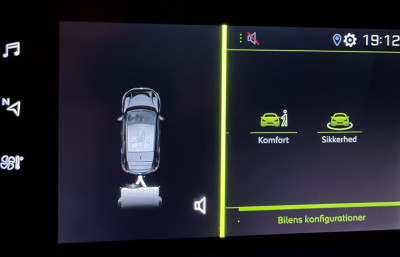

I have installed OEM tow bar and electric kit on 208 II from 2021. After installation and connection to the trailer the lights of course didn't work.
I hooked up Lexia to the car, bought a token, used oficial Diagbox, and activated the trailer unit. Yuhuuu, trailer works! (wasn't really able to test the fog light as it was missing on the trailer).
However, later on, while driving without a trailer, I have noticed that in a rear gear I don't get any image from the back camera or feedback from parking sensors, as if the trailer is connected, see attached picture.
Now I am confused what can be the reason for the above mentioned behaviour.
Questions I have:
1. How does a normal behaviour for the rear camera/sensors look like? I would assume both of them should be working with a disconneced trailer.
2. Is there a switch in 13-pin socket which somehow controlls whether trailer is connected or not?
3. Any ideas what can be the issue and how it can be solved?

Excuse me, I wrote the wrong part number installed as I had installation manuals open for both parts. The correct part number I installed is 1688059880 as you stated. So I have a right part installed in this case.
I can of course double check if I wired connectors right tomorrow as it's relatively easy to access them. What can be the other issue causing probelms with operation of parking assistance?

Well, my assumption would be that I shouldn't see trailer displayed on the touchscreen when it's not conneced, which indicates that car detects the trailer somehow.
Are there any pins in the socket responsible for detecting the trailer?
I configured trailer in diagbox using automatic car identification by VIN. The path I followed is Delivery - Accessories - Trailer control unit - Installation. There was no really other option than install or uninstall trailer control unit.

On our cars, the 13 pin socket does incorporate a microswitch to register the presence of a plug. If you have one them maybe it's sticky?

Paul-R wrote: 18 Mar 2024, 20:20 On our cars, the 13 pin socket does incorporate a microswitch to register the presence of a plug. If you have one them maybe it's sticky?
How exactly does a microswitch look like? Brief search on google is not helping my understanding where exactly to look :)

I went to the car this morning to see once more whether parking assistance is turned on in the settings. It was. However, to my huge surprise when I turned on the engine and put it in reverse, the camera and sensors are working as usual! :rofl2:
Well, I cannot explain what exactly could have changed besides car being turned off over night. Now I will monitor the behaviour and if it was just a glitch (or sticky switch which unsticked over night?)
Thank you all for help! ;)
