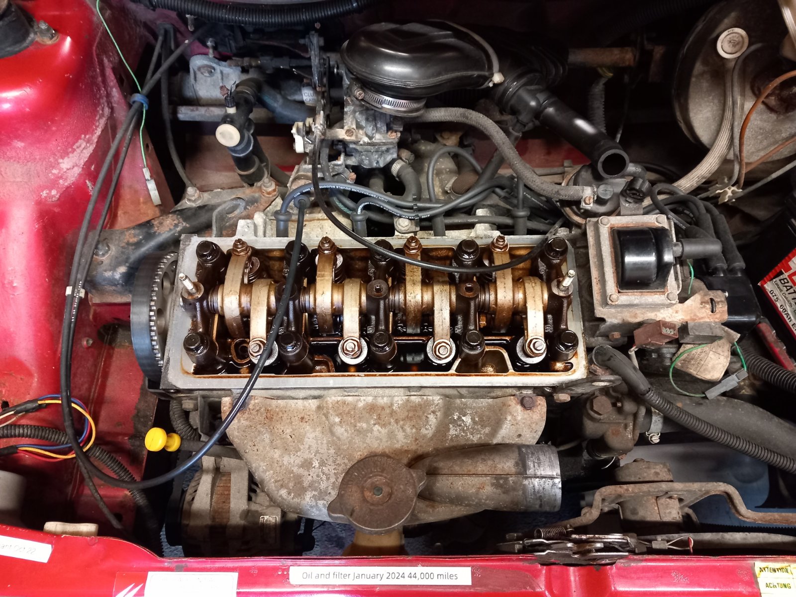

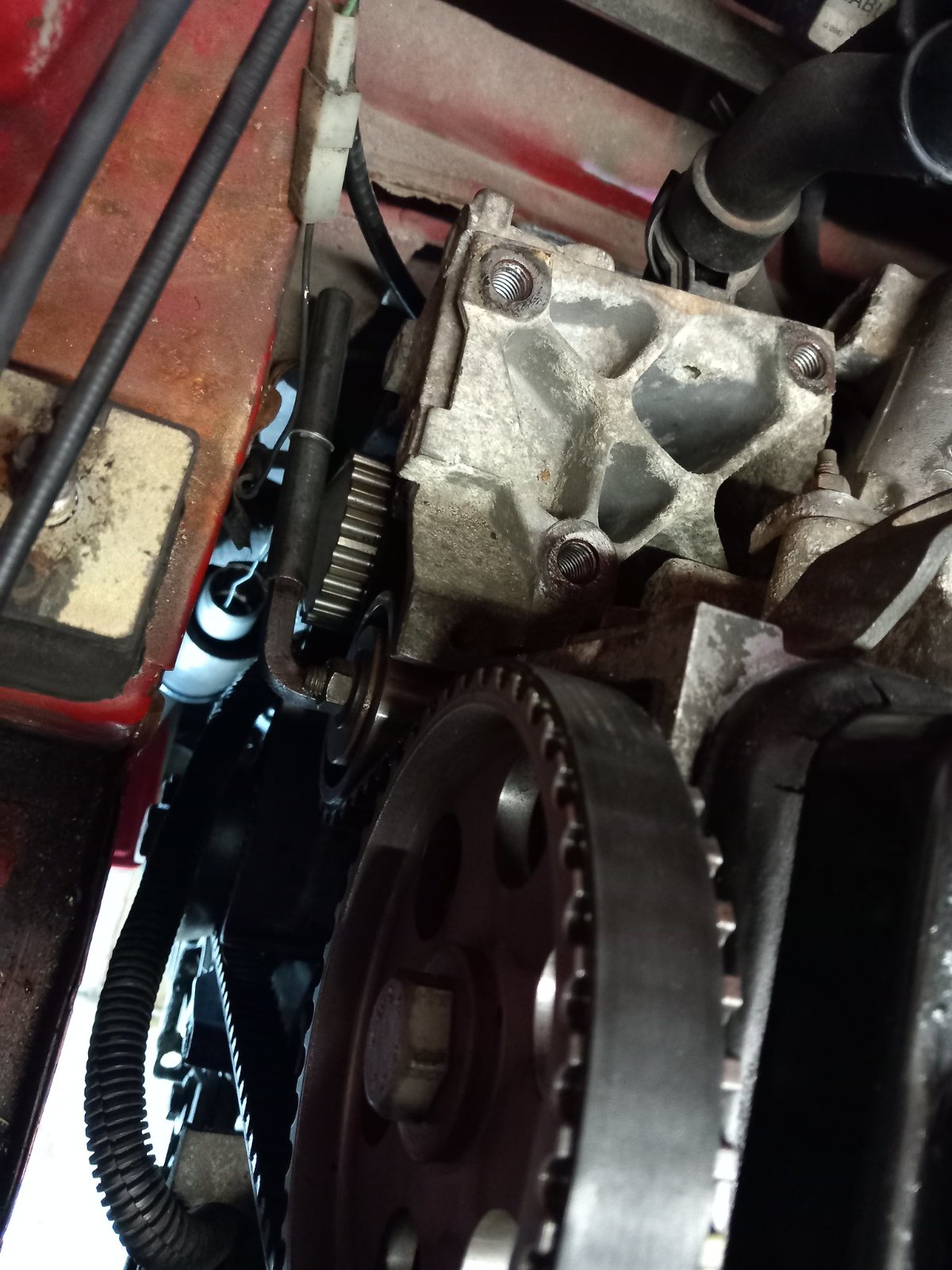

A bit of good work on Strawberry today, in amongst other essential work...
Valve clearances checked and all OK :) And all nice and clean up-top :)

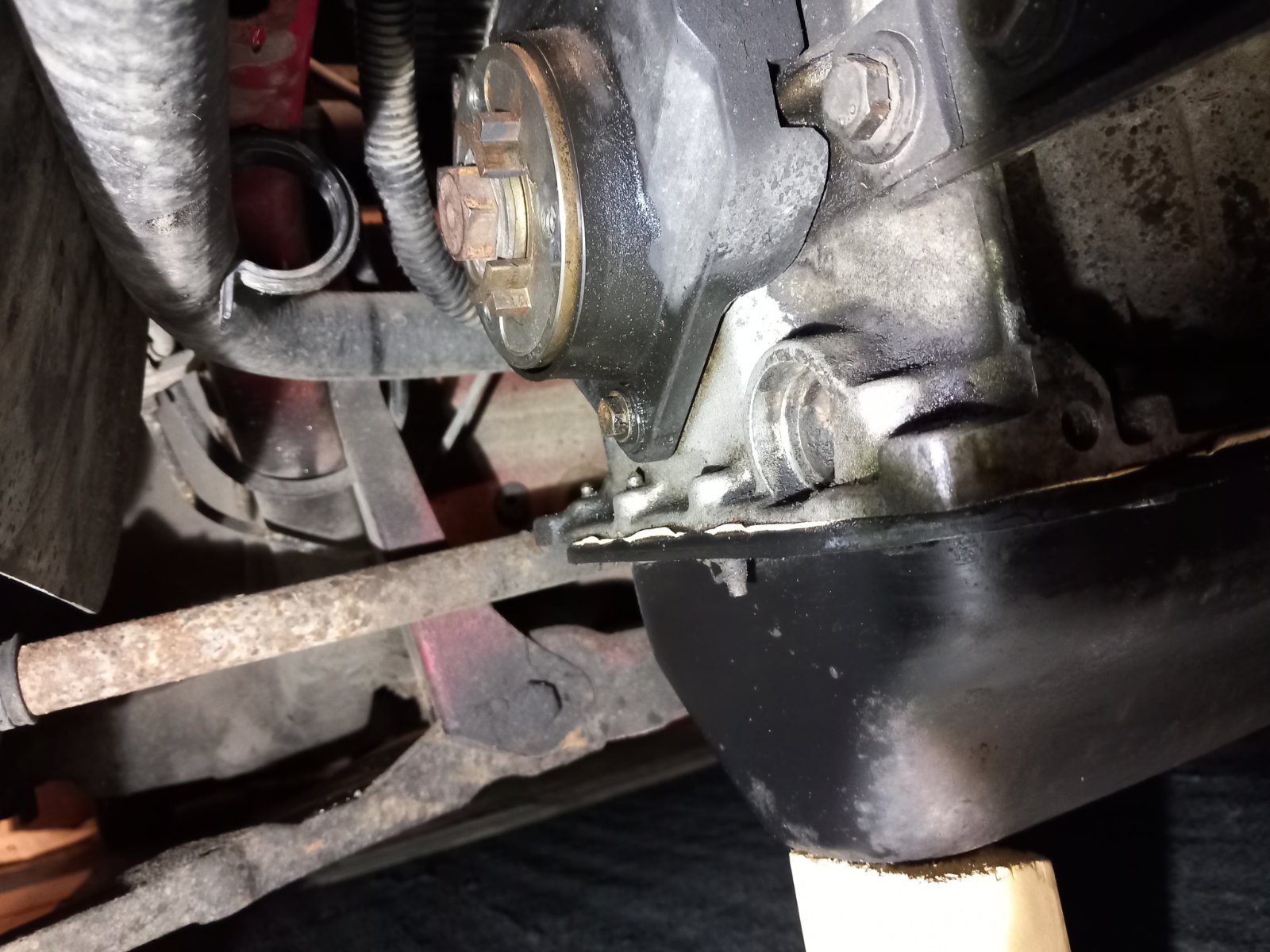

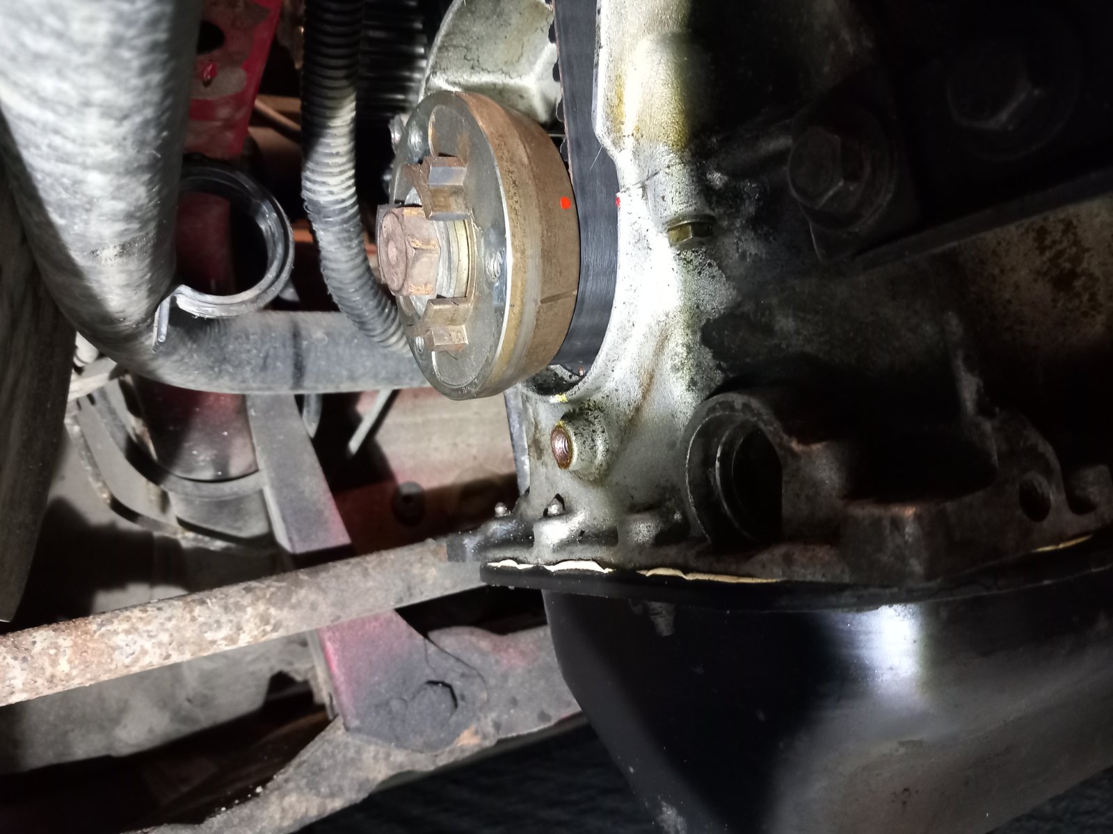

Removing the cambelt covers revealed a bit of oil on the sump and around the crank pulley. This means the crank oil seal is stating to fail - a very common problem with the TU engine and fairly straightforward to resolve. I last did the job on my old Saxo.
Removing the lower cambelt cover shows it's not yet too bad and can wait until I replace the cambelt and water pump in the not too distant. Happily, there's no oil on the belt itself.
Tomorrow I'll check and properly reset the belt tension. I can already tell, using the 'rotate through 90 degrees using finger and thumb' method, it's a bit tight...

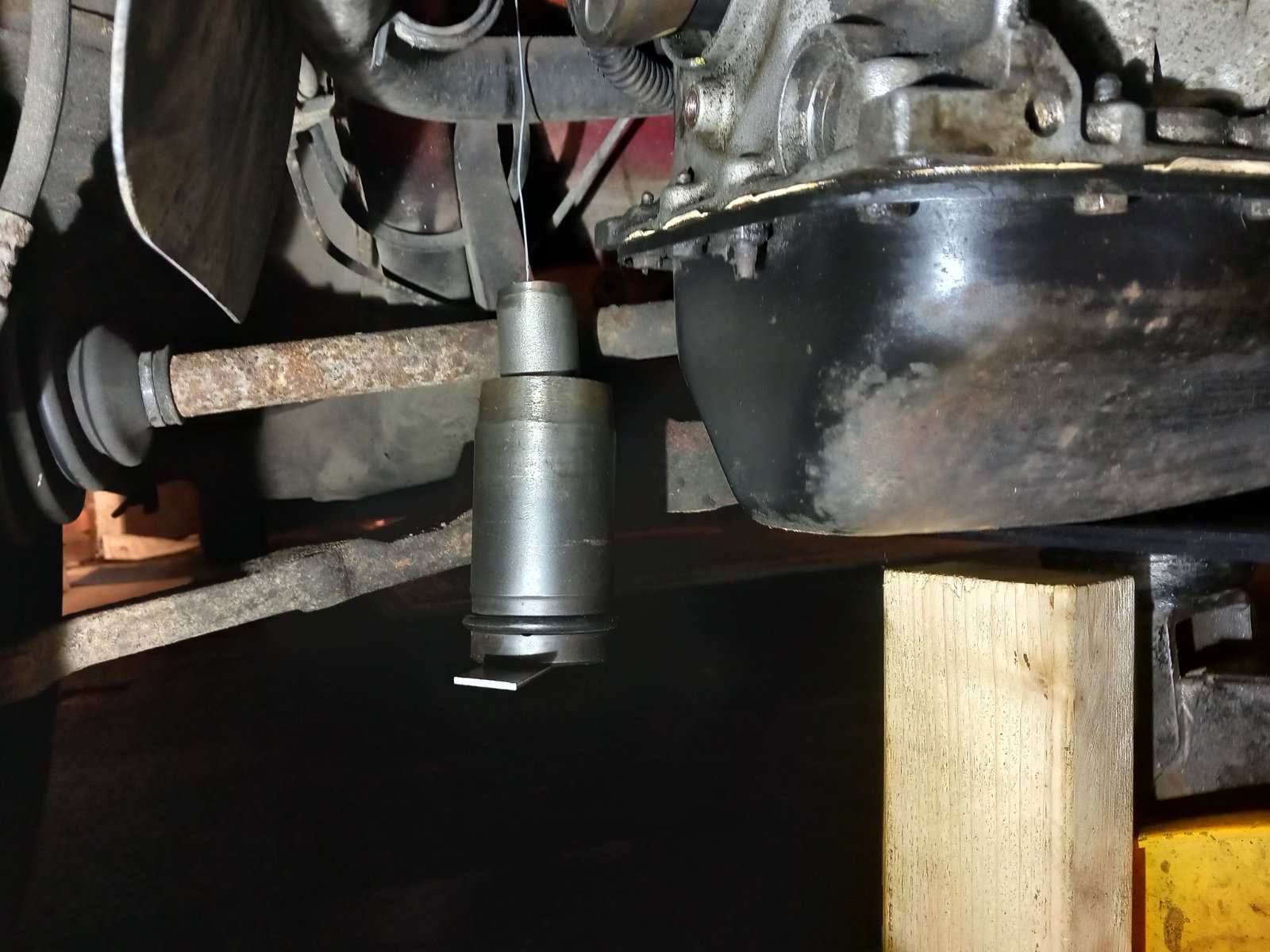

Happily, Strawberry no longer has a whining cambelt :D

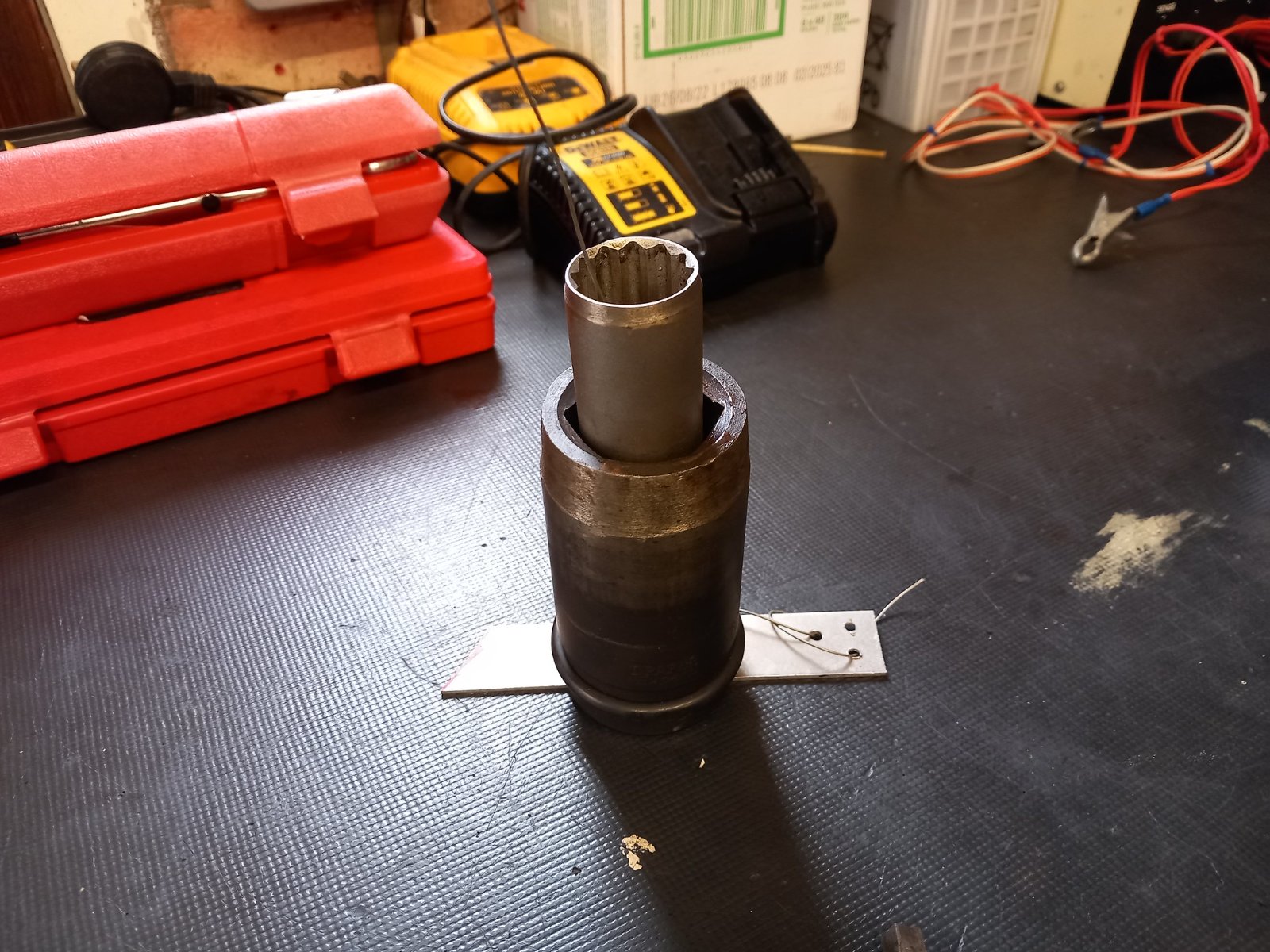

I properly tensioned the belt today using the 'dangling weight' method and is, in my experience, the only way to set tension on an early 8V TU..
Here's the calibrated weight on a wire. It's exactly 1.5Kg and fabricated from a selection of sockets weighed out on kitchen scales...
Hang it off the tensioner, as per:
A square-section right-angled tool fits into the tensioner and has a groove at the prescribed distance from which the weight hangs...
Loosen the clamp nut on the tensioner, allow the tensioner to settle and then re-tighten the nut. Torque up to 200 Inch Pounds...
Inch Pounds because that's what my little 1/4" drive torque wrench is calibrated in... It has a nice, slim head and will fit where a bigger one won't, such as here.
Conversion is easy... Multiply foot pounds by 12...
Here's the weight hanging from underneath...
Simple and elegant...

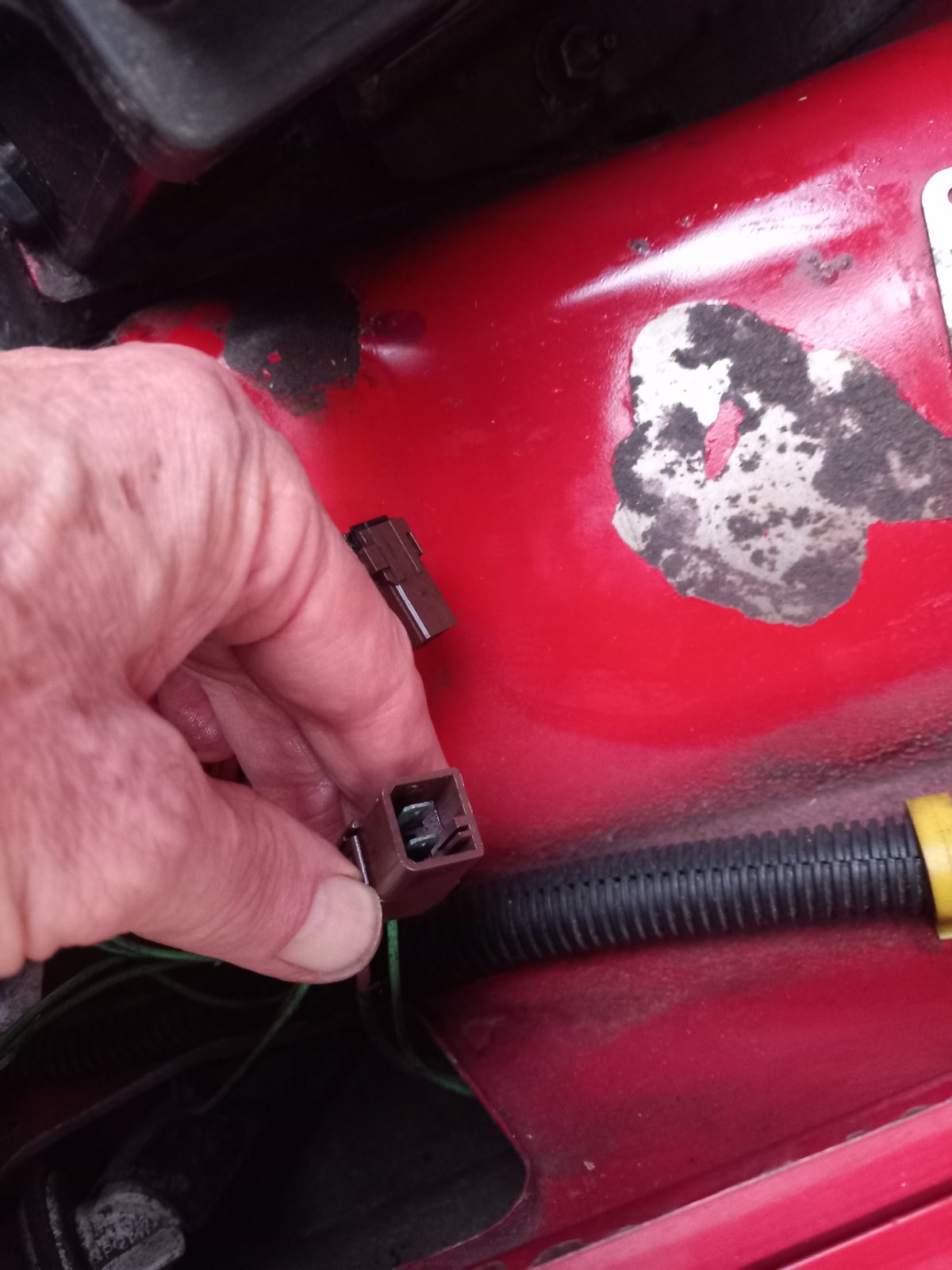

Strawberry was a bit troublesome on the way there. Her left front indicator and repeater ceased to work...
It was caused by a manky connector under the bonnet...
A bit of cleaning with fine emery and a bit of preventative lube soon had it all good again :D

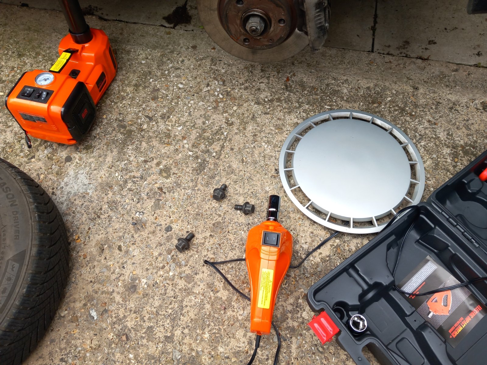

Both Mick and I purchased one of these a while back:
The 'Chinglish' of the label did not inspire huge confidence! :lol:
I tried all functions on mine today and it all works well. The tyre inflator gauge is a bit pessimistic. The impact gun undid some unbelievely tight wheel studs on Strawberry and the electric jack does the job :)
Ideal to carry in the back of the car, just in case ;)
Here it is in action:

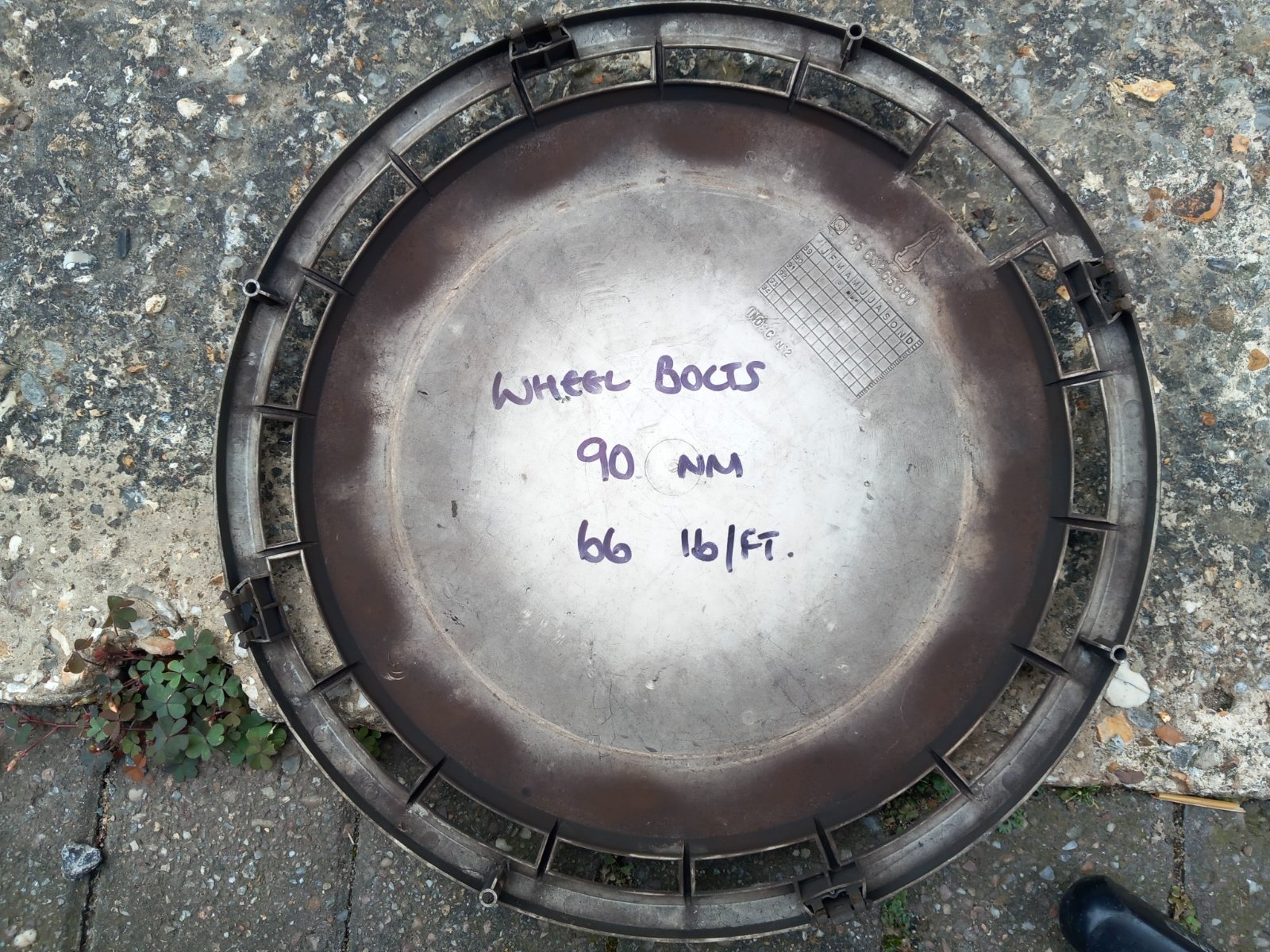

When I pulled off Stawberry's wheel trims, I was pleased to see this :)

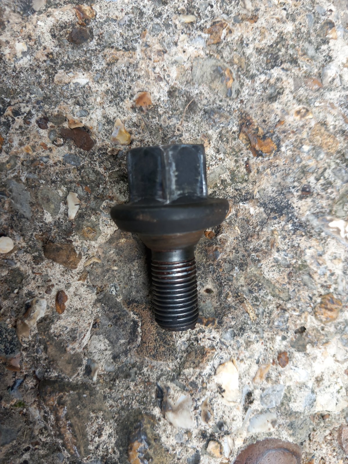

Shame the monkey last there interpreted it as 666 ft. lbs :evil: The studs were very seriously over-tightened and one was slightly damaged :evil:

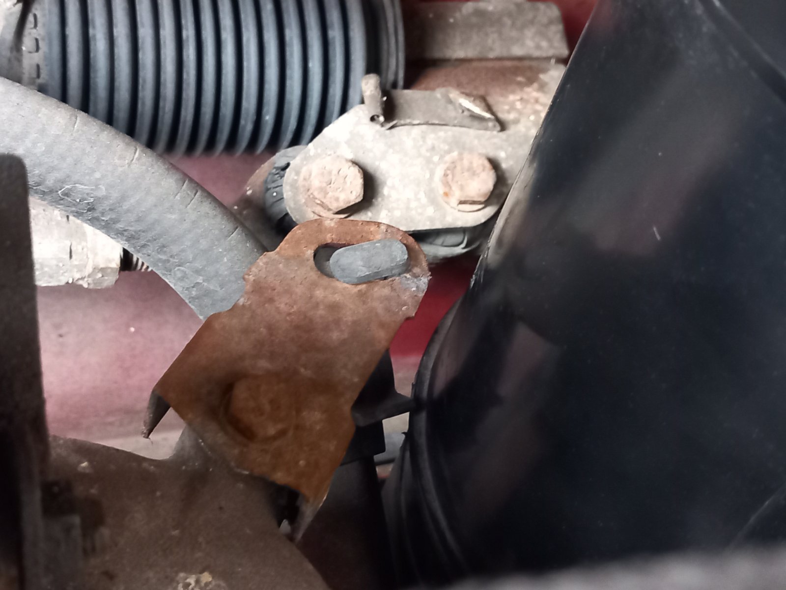

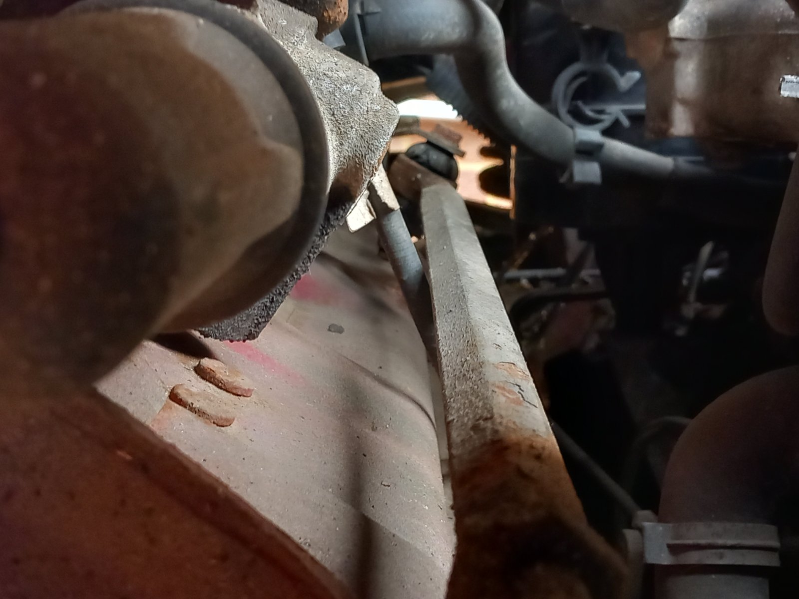

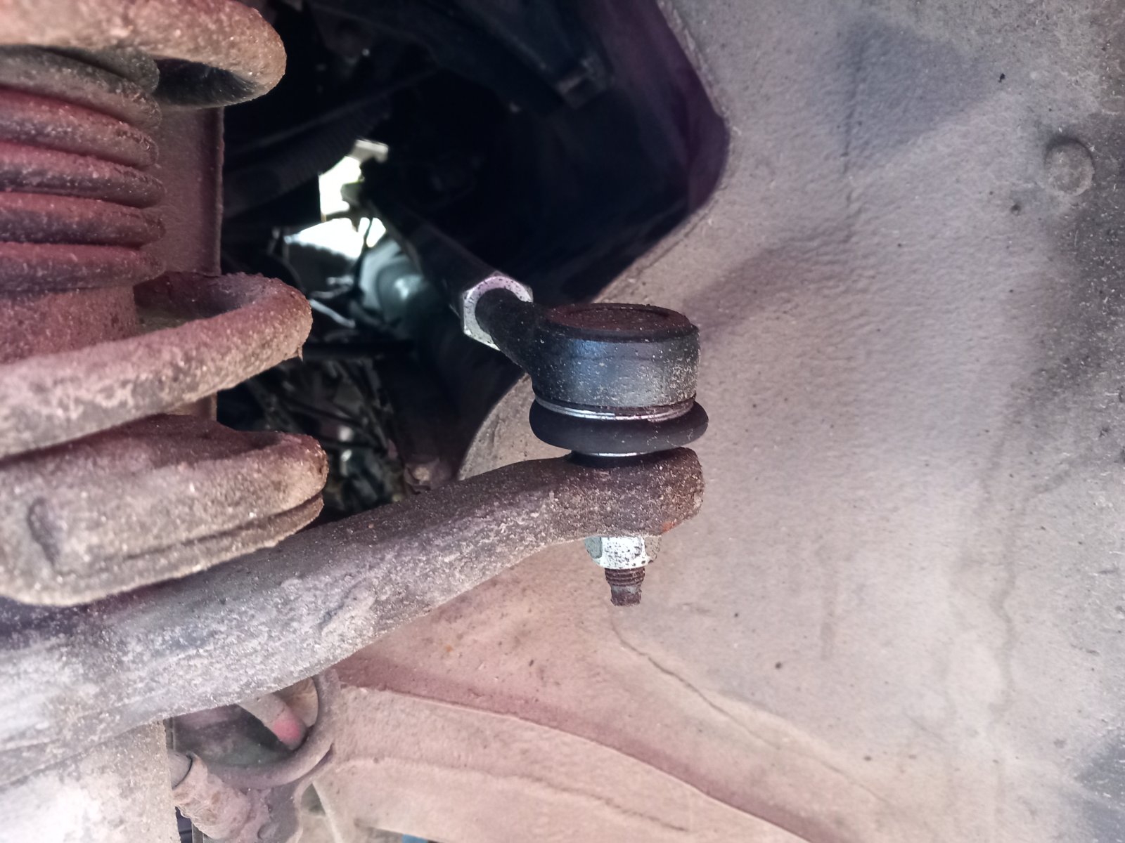

So, to work. Strawberry's track rod ends were fine and one looked very recent:
The problem came down to the rubber bushes at the rack ends of the track rods being perished. The AX has a bit of an unconventional rack with both track rods meeting in the middle of the rack...
Bluebell's aren't very good either, which is maybe why I never noticed... I need to source some new ones. NFP I expect, although the Saxo used them.

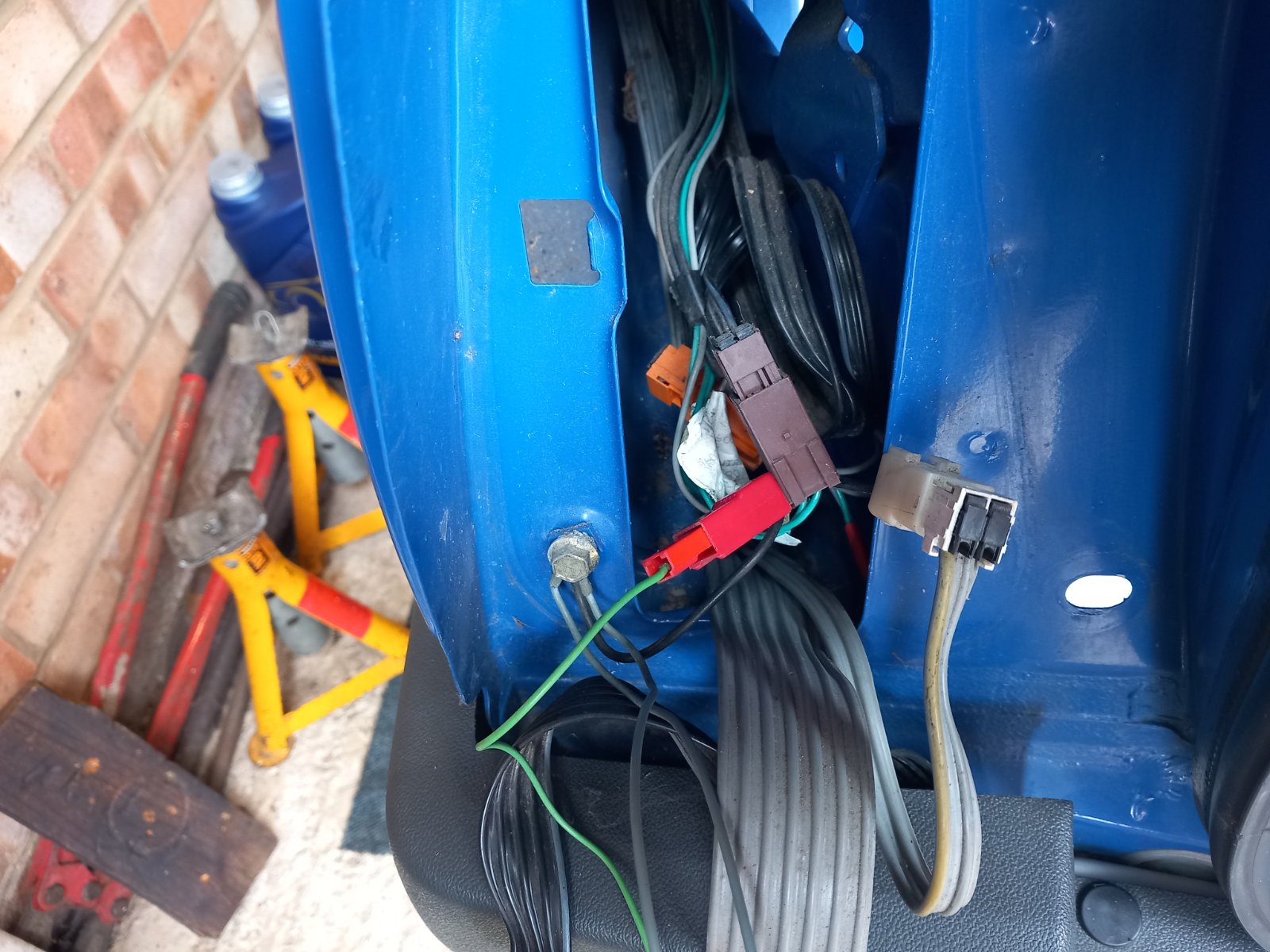

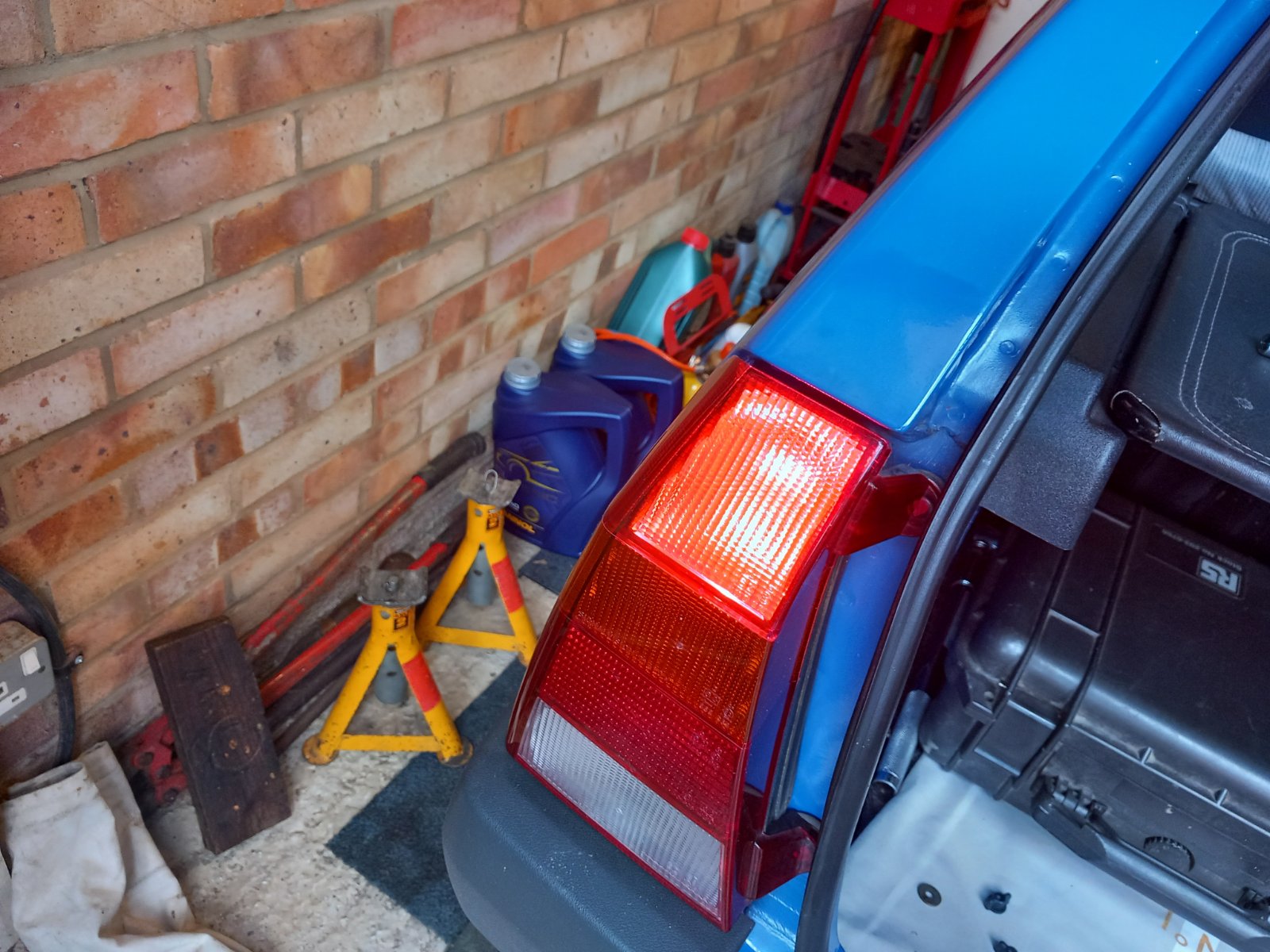

Bluebell's rear lighting problems were all down to a bad earth...
A bit corroded and covered in paint!
Cleaned up and all now good :D
Whilst I was at it I did the same job on Strawberry.

Small world. It is a bit of an odd arrangement having the track rods running all the way to the centre. A certain other small car I know does this though. Here's a couple of complete Trabant 601 racks and track rod setups out of the car.
In this case attaching to a tiny arm which bolts onto the inbound end of the steering rack itself.

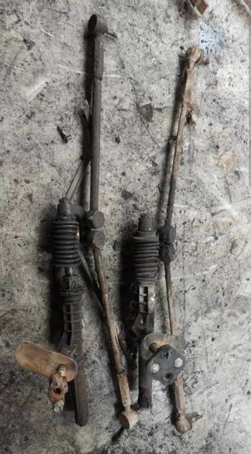

Only sensible question now is it a case of:
Work out if is an upgrade to fit Trabant inner rack bushes to an AX....
.... Or AX bushes to a Trabant!
(Suspect answer is likely "either, to either" so long as replacing knackered with nice fresh rubber!!) :)

MattBLancs wrote: 09 Sep 2024, 20:41 Only sensible question now is it a case of:
Well I know which is likely easier to get hold of...
I keep meaning to see what the ratio on the rack on the Trabant is. It's something daft like 1.5 turns lock to lock. Yet because the engine is so light it's still lighter than many cars I've driven with power steering.
Current fleet:

That's interesting to see the Trabant uses a very similar rack!
No, it looks like the Trabant rack has balljoints on the inner ends of the track rods whereas the AX has rubber bushes...
This eBay listing give some good views of the arrangement...
https://www.ebay.co.uk/itm/315692518385

2CV also uses a rack with centre track rod connections - although in that case the front suspension leading arms are mounted on the ends of it!
