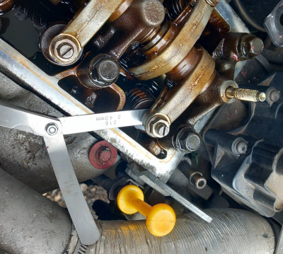

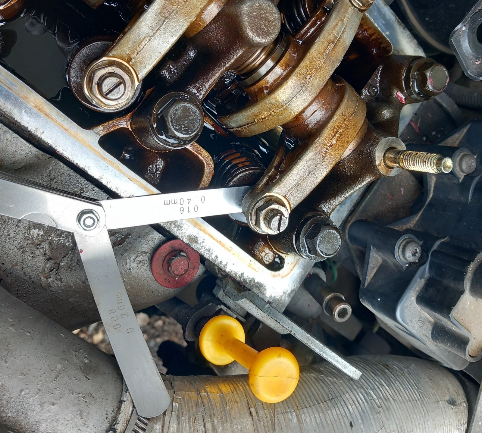

Whilst Alasdair fought the Xantia steering rack, I happily did a bit of work on Daffodil the AX
Her engine was making two distinct noises: a very typical TU tappet sound and a rather different sort of metallic ticking sound...
I can recognise a TU tappet from miles away but the other one was a bit more mysterious. It seemed to be coming from the vicinity of No. 4 cylinder and I had my concerns.
Firstly, I checked the valve clearances and found all were fine except No. 4 exhaust. It was a bit wide of the mark.
After adjusting and resembling, the tappets were beautifully silent but the ticking remained.

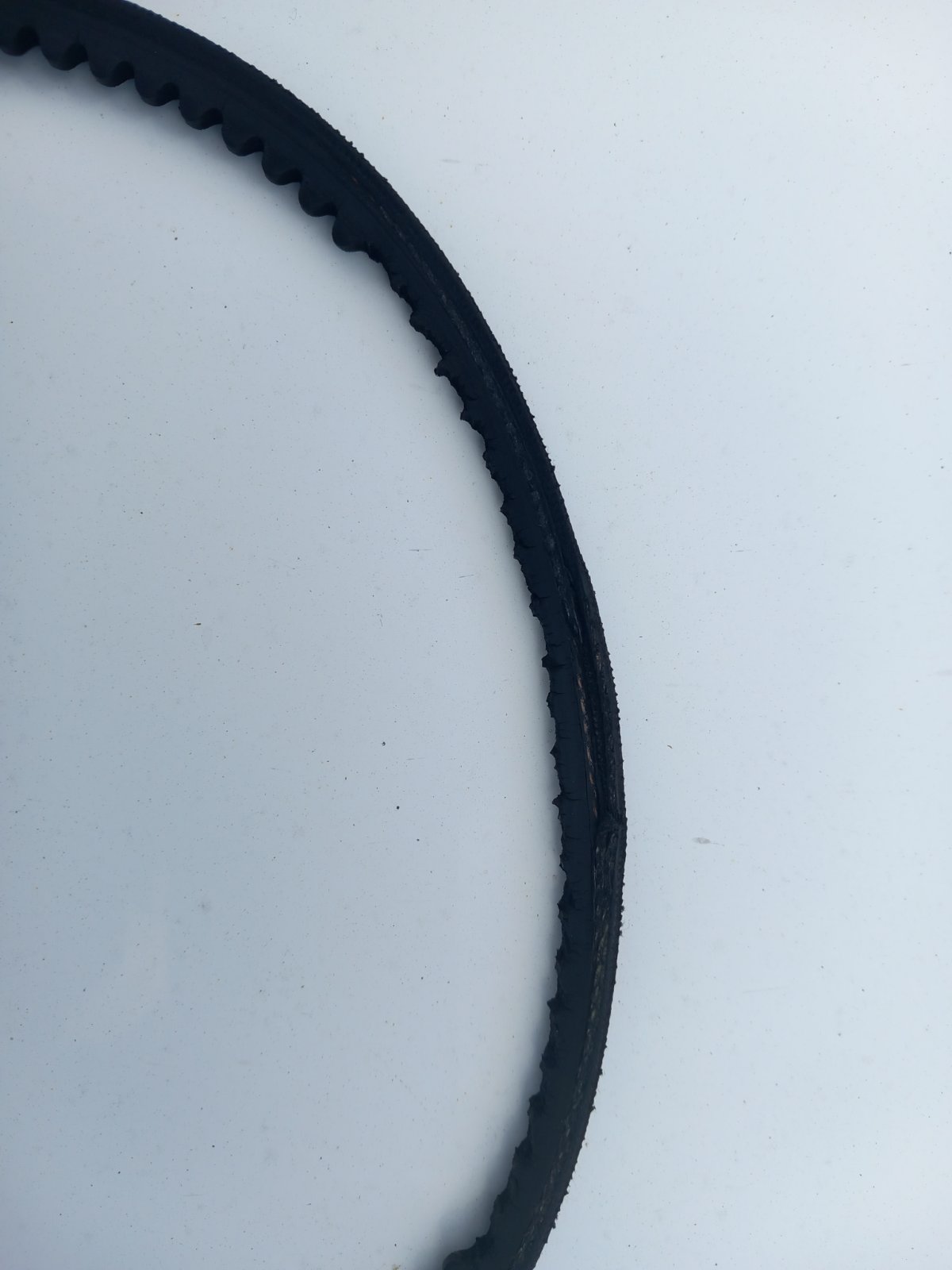

Then I popped off the alternator belt and the noise disappeared... Ahh! Alternator bearings or slip rings... But no, bearings felt fine and spinning it by hand revealed no worrisome feelings...

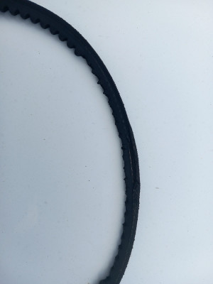

Then I looked at the belt..
It looked a bit care-worn and had a big tuft of rayon escaping from one side...
This was trimmed off with a small flame and the belt refitted...
Noise gone
How odd that a worn belt with a bit of stray cordage could make such a noise... A real 'first'.
Daffodil's engine was back sounding like a fine Swiss watch

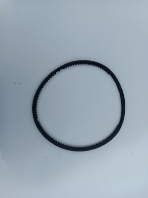

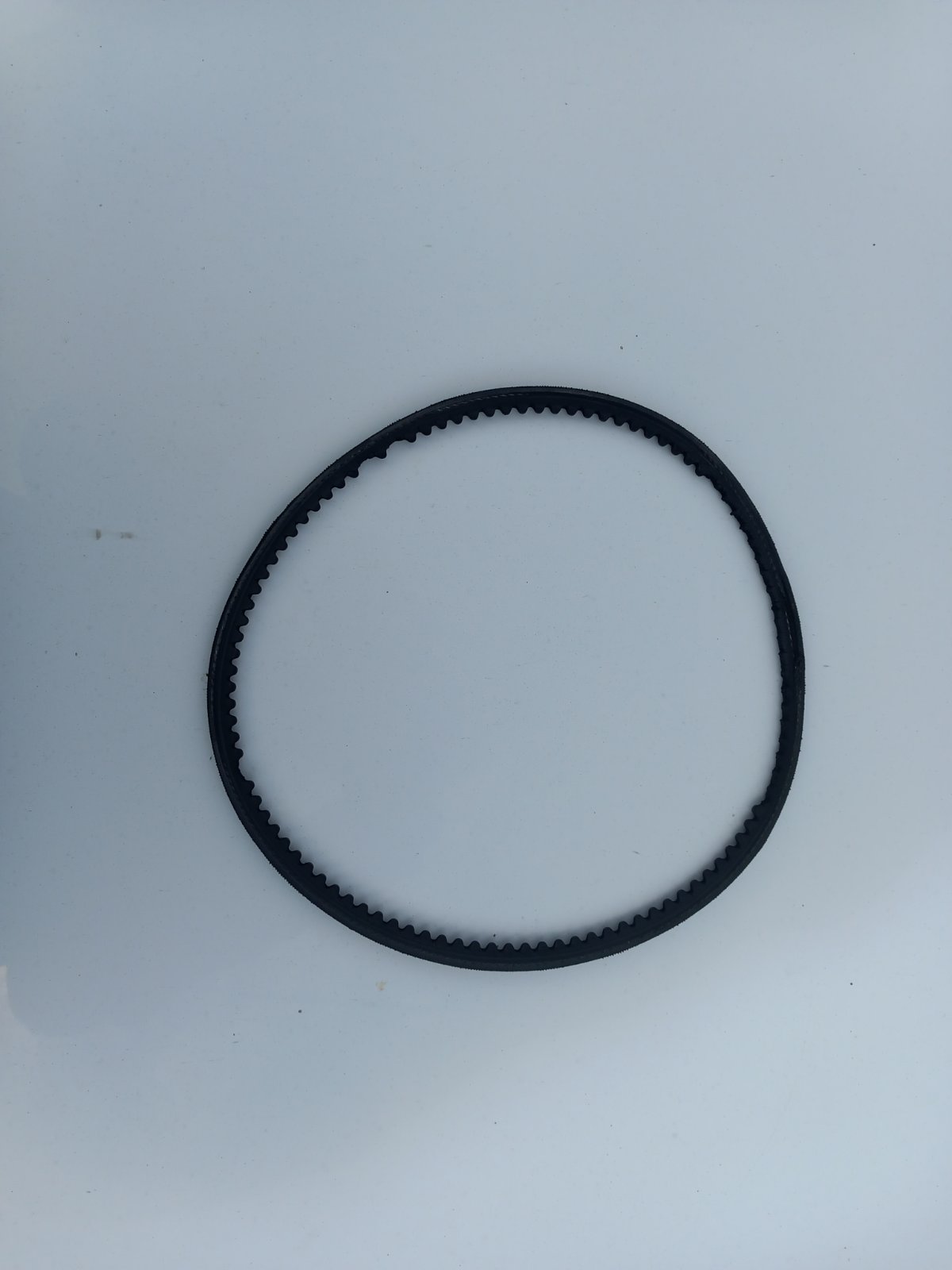

I was relieved it was just the belt. The noise sounded like it could have been a little end or broken ring...
A new belt is on order... The old one has definitely see the best of its days...
The quickest and easiest way to obtain one was to visit a local agricultural engineers. We ordered three as both mine could do with a new one.
Alasdair should have them tomorrow...

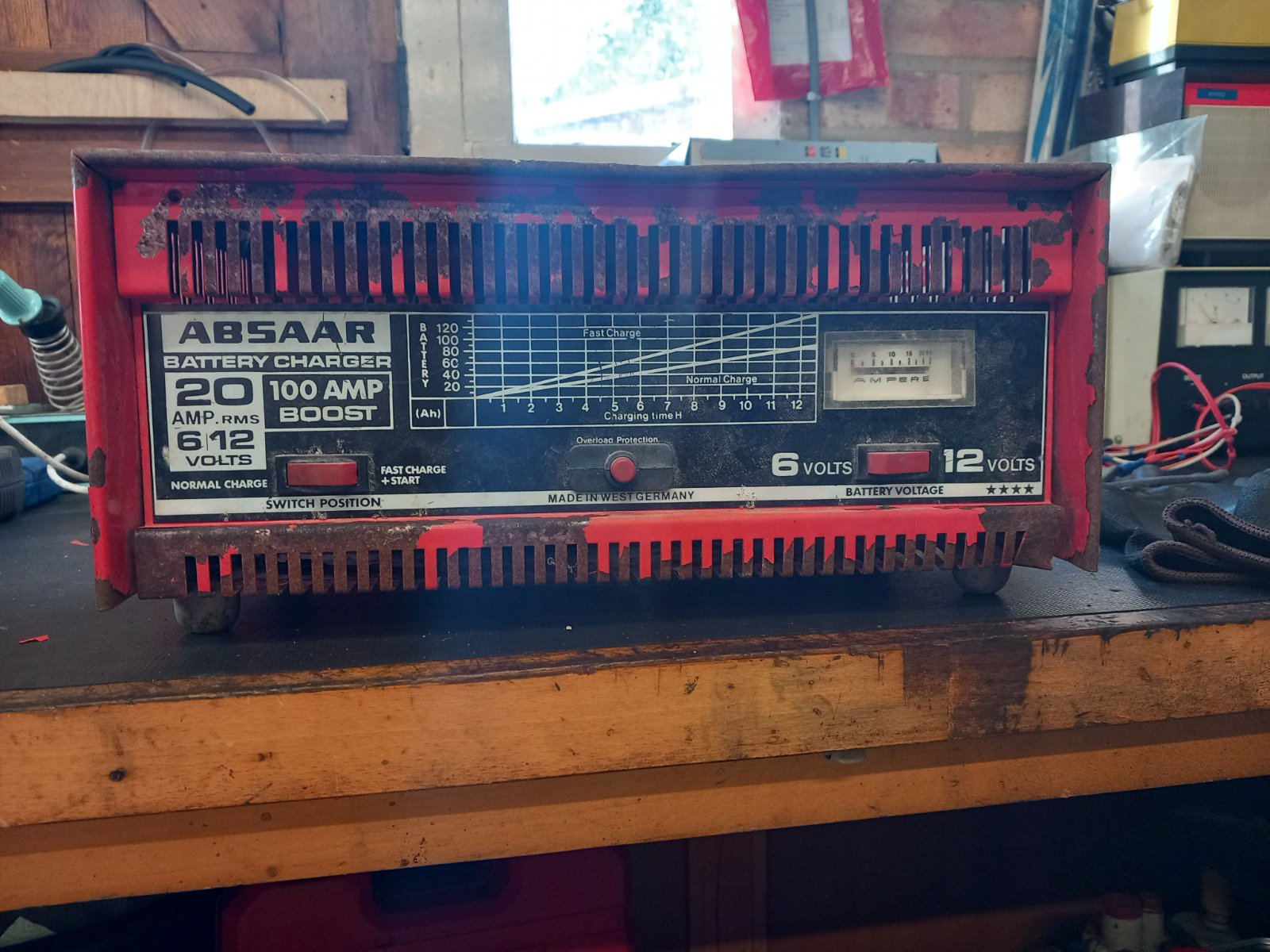

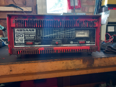

In the back of my car was another item rescued along with Alasdair's Rat Xantia. This big battery charger:
Alasdair tried it but it did not work...

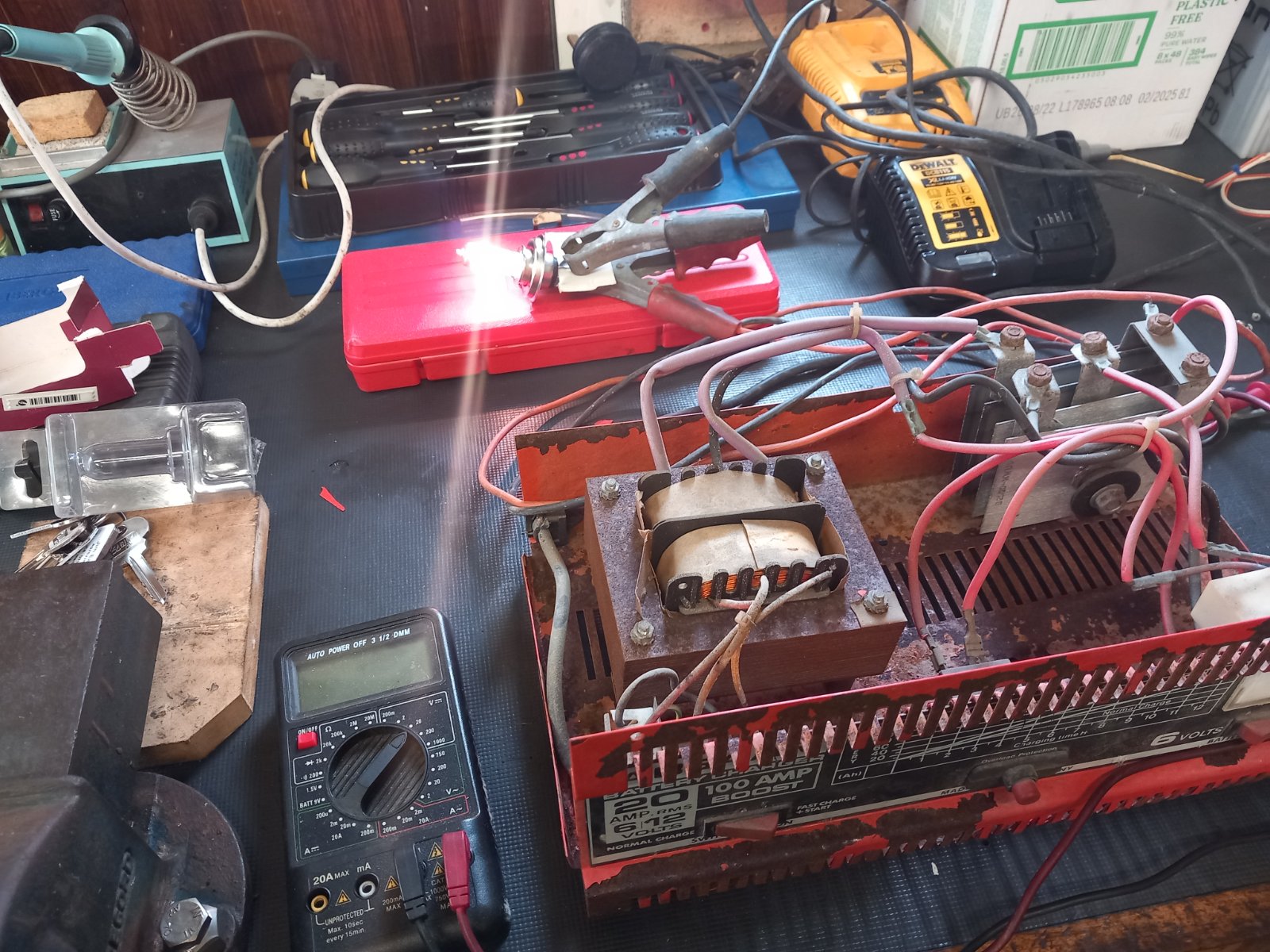

I had a look at it today. It's very beefy , albeit a bit crude. Just a transformer, a bridge rectifier, a cut-out and ammeter.
Despite being a bit rusty and cosmetically scruffy, it does basically work. The transformer is good but under load the output voltage sags badly...
It lights an H4 headlamp bulb but the output voltage drops to about 8V in doing so and current is limited to about 1.5A.
The rectifier elements appear to have gone high resistance and this would be likely be as a result of 10 years of being in a damp atmosphere and old age. These rectifiers do deteriorate over time even when well looked after.
And this charger is old. Keen eyes will see it was made in West Germany!
As the transformer is good, the charger is well worth attempting a repair... I'm going to have to source a new bridge...
And here's a bit of devil in the detail. A modern silicon bridge rectifier will have a forward voltage drop of around 0.6v across each diode whereas the metal oxide rectifier as used in this charger has a forward voltage drop of around 0.1v across each diode. If I use a silicon bridge then the resulting output voltage will too low. By about a volt...
I've not looked yet but hope a suitable bridge can be found... Watch this space

I have some doubts on the specification of that charger.
The rectifier looks much too small for the stated current rating, and a metal rectifier would have required more plates due to the low reverse breakdown voltage (per plate).
The general appearance (and fonts) of the charger looks like something from the late 60s or early 70s, which would likely have originally had a silicon rectifier.

Oh yes Mike, it's very optimistically rated! 100A boost - no way at all. Not even into a short-circuit...
It's definitely not a silicon rectifier...

I was thinking that the rectifier may not be the original...
Without adding complicated control electronics, probably the best you can do is use power schottky diodes similar to https://befr.rs-online.com/web/p/schott ... sS7pOn6dIR .versions are available with slightly lower Vf, but nothing below 0.4V.
Is the original rectifier full-wave or bridge? I can't quite follow the wiring in the photo.

Looks very original to me Mike... And indeed, it is a full bridge... The transformer has a primary tap for normal and boost charge settings and a secondary tap to swap between 6V and 12V batteries.
The use of power schottky diodes is a good call

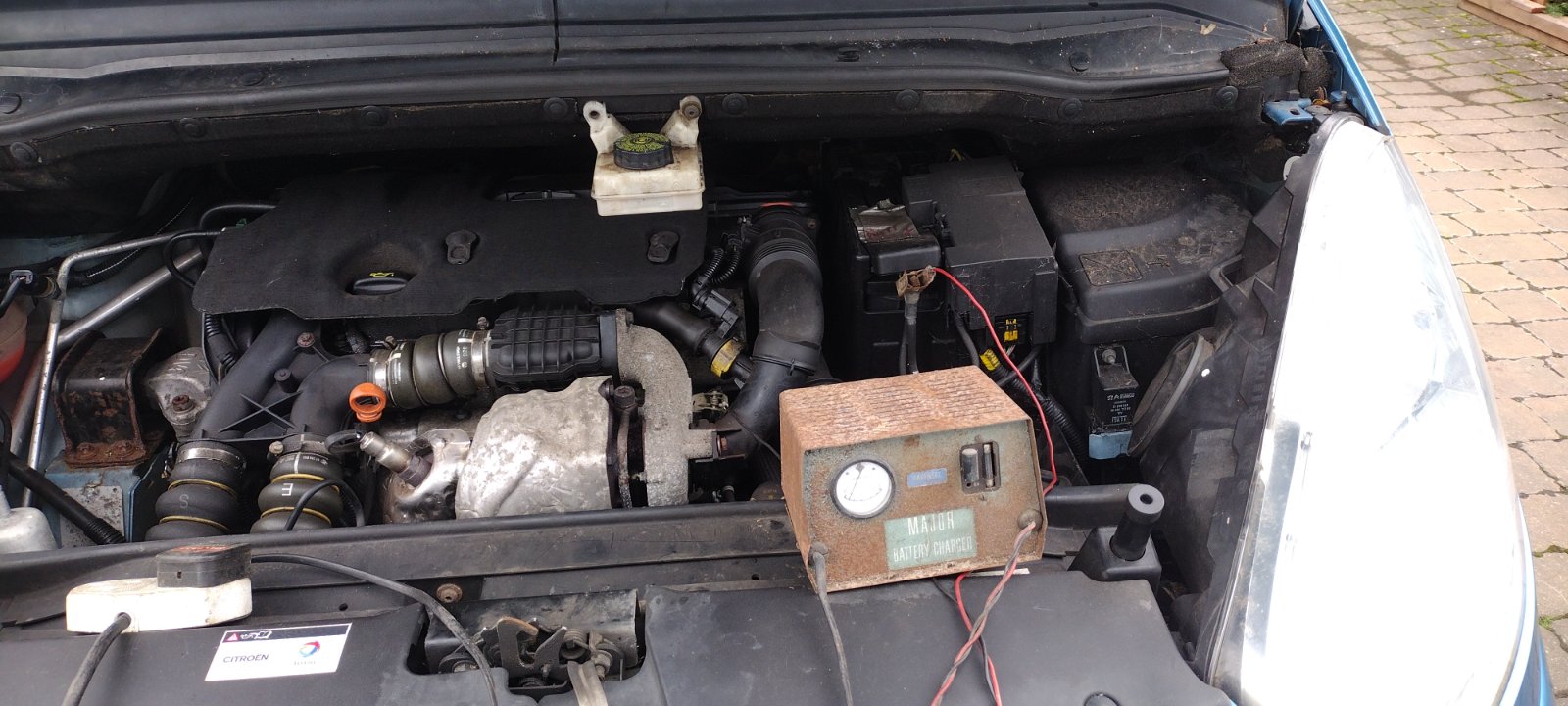

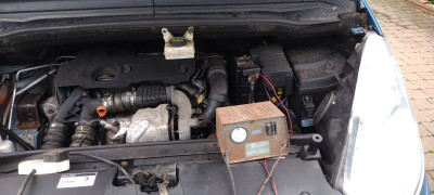

Here's mine, charging the battery on my Sister's old Picasso. I've had it nearly 25 years, inherited from my Grandad, must be 60's or perhaps even earlier...

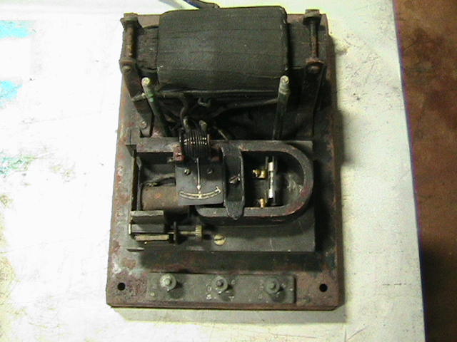

I have a battery charger which is more than 100 years old. It is in NZ, so I can't take a photo right now, but it has a mains-synchronous vibrating reed rectifier.
It looks something like this American Valley Electric charger (but not the same model):
There are a couple of design tricks necessary with a mains synchronous reed rectifier, if the reed is excited directly by the 50 Hz AC, it will vibrate at 100 Hz which is useless for rectification, so IIRC the AC electormagnet acts against a permanent magnet to excite the reed at 50 Hz. The other issue is that the switching contact needs to vibrate 90° out of phase with the applied voltage, which requires a carefully tuned resonant system.
My dad got part way through restoring it about 50 years ago, and I believe that the transformer was OK, it just requires reassembly and tuning.
I will fish it out in a couple of months and take a closer look.
