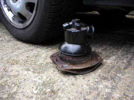

I did the job today and put two new strut tops on the Xantia.
No problem at all. It's a straightforward job in all respects as you said it would be Malcolm (Citronut)! 2 spanners in BOL Speak, nooo. 1 I reckon.
I took a picture of the worst of the two. It looks bad but is in fact still very sound. It was a long way off failure I think. No cracks, no distortion, just rust but I was not going to take a chance...

jim your car must be of the none activ/activa as you said have two 3.5 pipe seals ready as both of the for mentioned do not have any pipe seals at strut top joint,i found no prob with gaitor replacement as i fitted it with strut in vice,but you must smear sphere seal with LHMso as not to damage it when replacing the sphere regards malcolm

Yes, absolutely Malcolm. Mine is the non-Activa, non-anti-sink with the little thin pipes into the strut tops.. Looking at your picture of the white one you had with the popped strut I see a much thicker pipe. Was that an Activa then?

nop its an activ not activa regards malcolm
