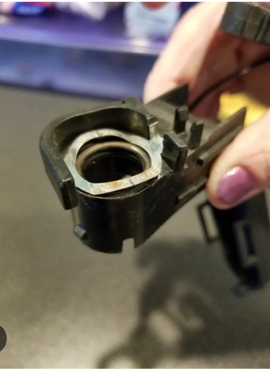

Can’t remember if the Nemo is the same but some older Fiats (this van is just a re badged Fiat) they have a weird connection arrangement of the main cable & solenoid cable. One kind of goes over the top of the other, hard to explain but i will try find a picture.
wheeler
Posts: 7893
Joined: 21 Sep 2002, 19:07
x 1043
Re: Citroen nemo not cranking starter
Unread post by wheeler »
This is from a Fiat 500, not sure if its the same on the Nemo but it could explain why you think there is no solenoid trigger feed. The big metal eyelet is actually the feed to the solenoid, a plastic insulator is on top of it then the main battery positive is bolted on top of it. Yes its a stupid design.

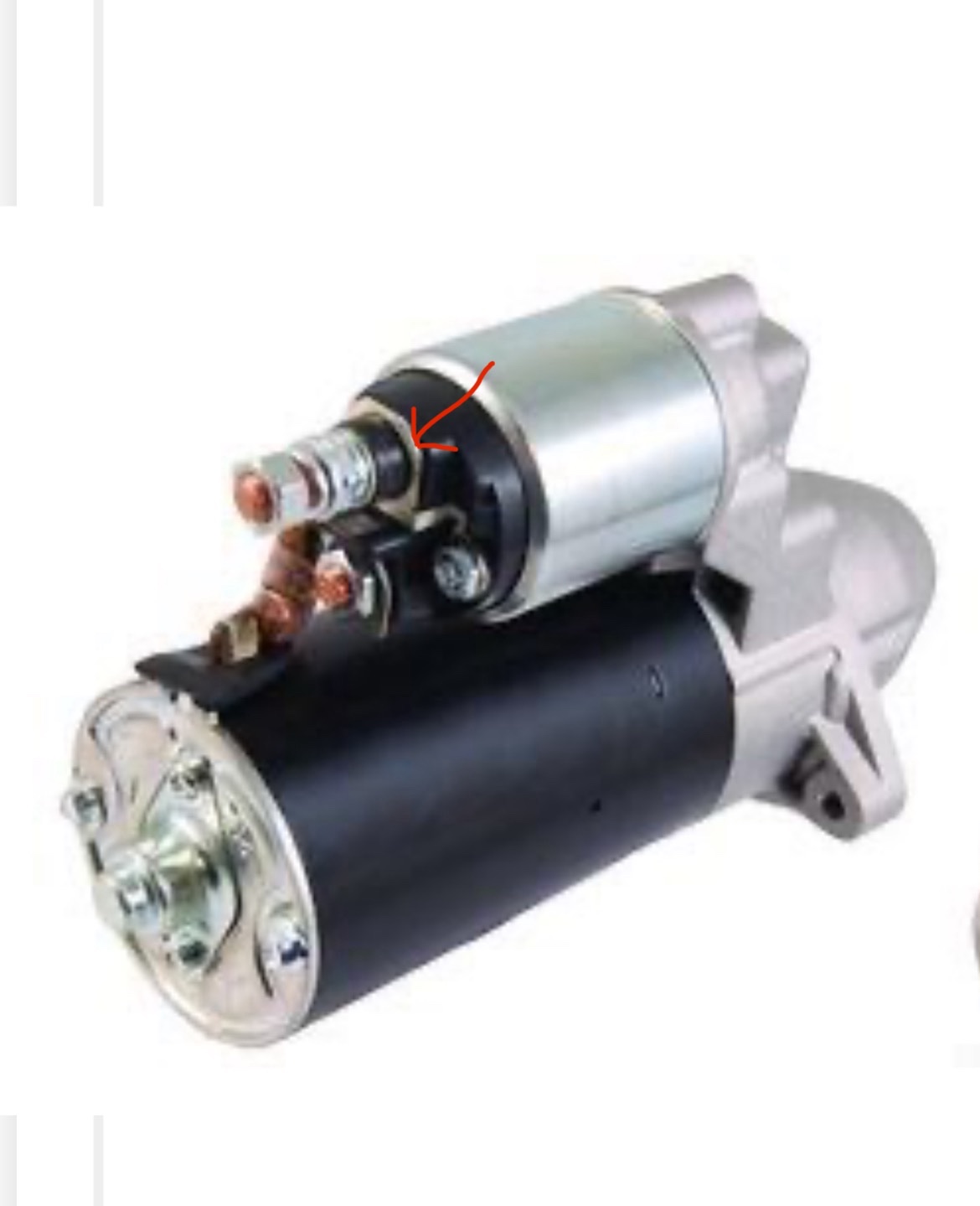

A quick google of a nemo starter suggests it has this stupid setup, if its the same as this then the metal ring highlighted is the solenoid feed connetion,
Tintin1062WJ
Posts: 3
Joined: 26 Aug 2024, 20:31
Unread post by Tintin1062WJ »
I think this IS my prolem.thank you very much.Will look at this .maybe tha solenoid connection is rusted a bit.It also means both cables,the battery and the ignition,are housed together in what appears to be the battery cable.
