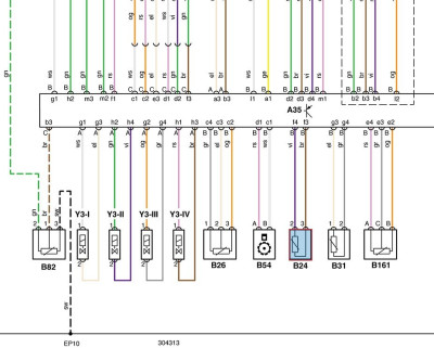

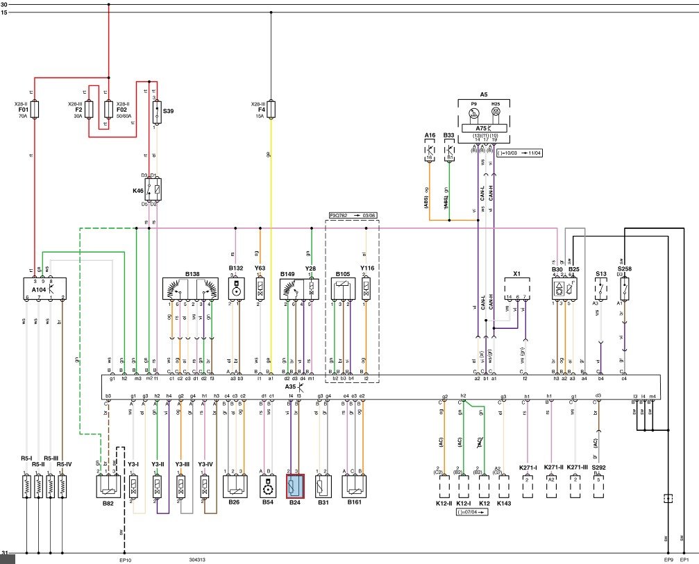

Is there anywhere I can get a detailed wiring diagram for the renault trafic 2 (2005)...1.9dci 101HP. F9Q 760 engine.
I'm having trouble with the coolant temerature sensor circuit showing open or short to +12v
Ive fitted a brand new sensor so I've ruled that out...Im assuming its something in the wiring itself.
I could do with a decent diagram to show the complete coolant circuit to possibly find the fault.
Thanks

Re: Wiring diagram
Whats the reg or VIN & i'll see what i have.

Re: Wiring diagram
Hi Wheeler..
The Reg is YT55 FBA...
If you need the VIN i'll get it for you tomorrow.
Thanks
Thanks

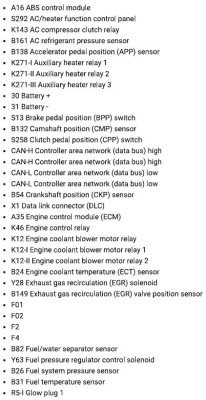

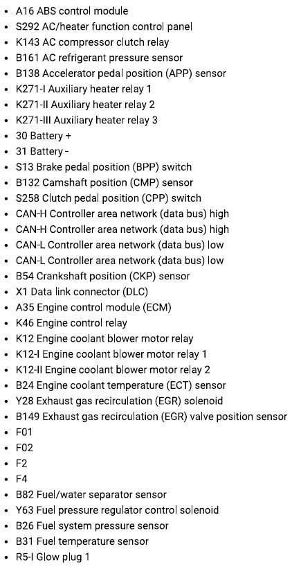

Re: Wiring diagram
Hi Wheeler
Do you have any other info on the diagram...ie a key to the components shown.
I'm not exactly wiring diagram literate but if i can identify the different parts i'll have half a chance.
Thanks
Thanks
wheeler
- Posts: 7932
- Joined: 21 Sep 2002, 19:07
- x 1056

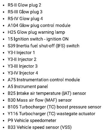

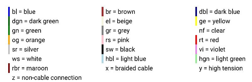

Re: Wiring diagram
Sorry, i only put the component code for the CTS as that was the circuit you are interested in. Here are all the component & Colour codes.
