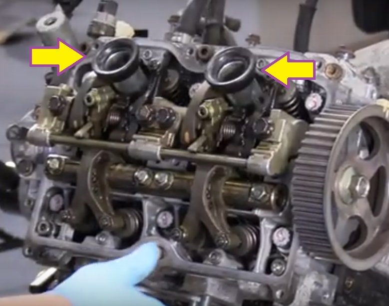

A "misfire" thread with a successful conclusion, now there's a rarity. Well done Mick/Jim a thorough job and those new seals look the part. Not an obvious contributory factor but maybe even the primary factor causing the misfire and I am permitting myself a small bask in reflected glory for my pointing out the possibility. with a little help from a bloke from America on youtube :-D
NewcastleFalcon wrote: 12 Jul 2024, 12:19
May also be something straightforward, and a common occurrence on Subaru Boxer engines (yes not first hand knowledge but a bloke from the USA on youtube!), these eventually fail causing oil in the spark plug hole and resultant misfires.
Spark plug tube seals (underside of valve cover)

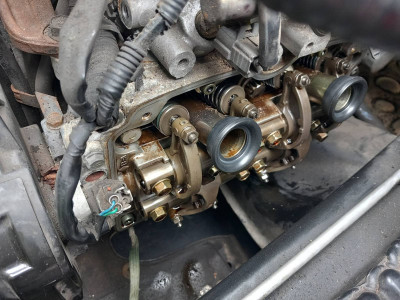

In situ
Job done at Maverick Manor!
