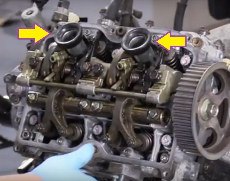

A "misfire" thread with a successful conclusion, now there's a rarity. Well done Mick/Jim a thorough job and those new seals look the part. Not an obvious contributory factor but maybe even the primary factor causing the misfire and I am permitting myself a small bask in reflected glory for my pointing out the possibility. with a little help from a bloke from America on youtube

Still puzzled over why one plug was working loose!!?? My ES9J4(S) V6s get oil in the plug wells (Jim would have observed this) - both from leaking cam box/tappet covers (no gaskets), and from an ageing filler plug sealing ring.
They seem to keep firing OK (although they are upright, not horizontal, so the connector would only be in an oil bath if the issue was ignored for an extended period), and I've never known one to come loose!!!

A bit of a puzzler for me too Alec, now the wells are dry I'll keep an eye on that plug and see if it gets loose again. When I removed the rest yesterday none of them were what I would describe as loose but nor did they need much pressure to undo them so it maybe that my torque wrench was faulty when I changed them a few months ago, especially as it exploded yesterday!
