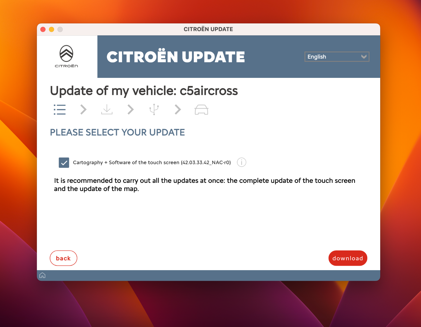

Thank you for the info. I have tried but without success. When I put USB in the car nothing happens. I have tried with different versions of map (12 then 15 then 16) different USB... Strange thing is that when I do via Citroen update app it immediately recognize that I need to update software plus cartography and USB is recognized but it offers Software version (42.03.33.42_NAC-rO) that car already have? Software is installed but maps keep failing to instal. Can you check what version of the Software is shown for the VIN Number VR7**************[VIN obfuscated, can be read by forum staff]? You said that the maps are from 2018 but i dont know if you can check the software version of the infotaiment system on some server?
Any help to solve the issue is appreciated.

Thank you a million for the help. In the end, I managed to update via the Citroen app and the main problem was my Mac computer:) When I prepared the USB via the Citroen app on Windows it installed both Software and Maps smotlhy. Currently, I have software version 42.03.33.42_NAC-r0 and map version 10.0 (Which is a significant improvementl since the map version was 6.0 :-D ). My VIN Number is VR7**************[VIN obfuscated, can be read by forum staff].
