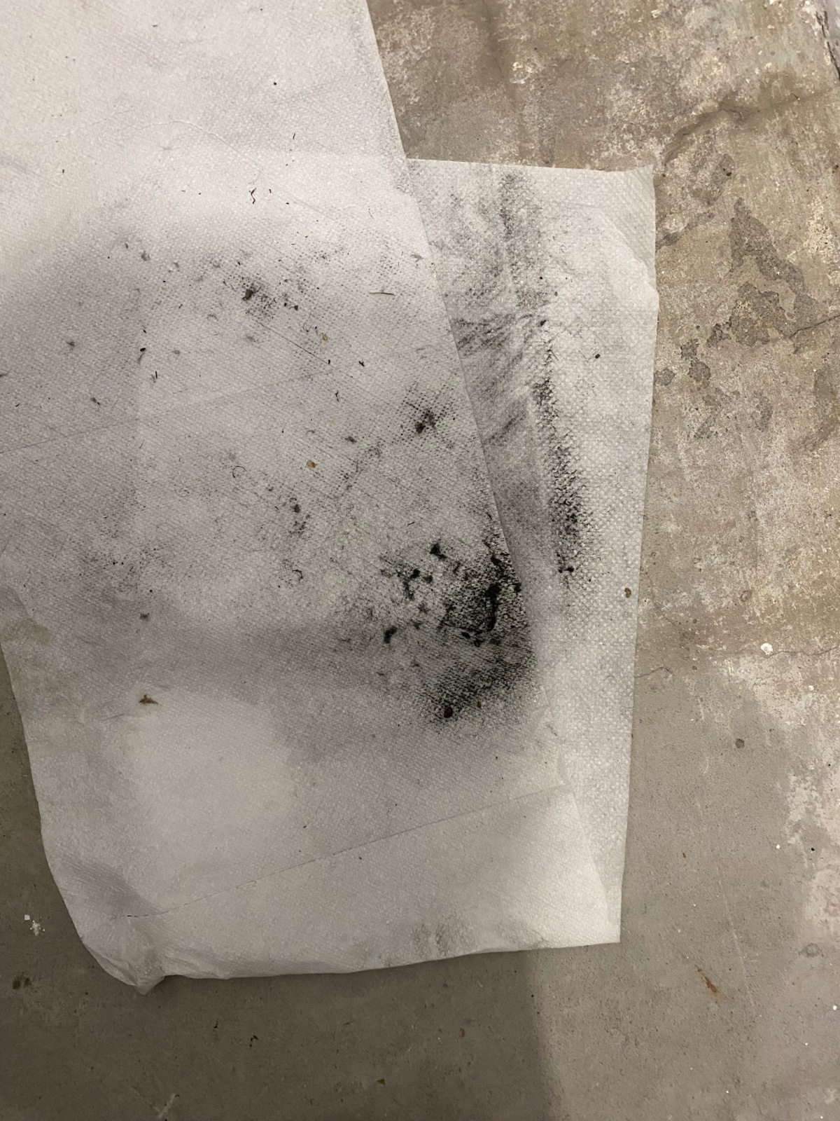

Thanks. I cleaned the MAF sensor. It was quite dirty. Since then, there is no twitching at low revs.
Also, I don't see it smoking heavily.
156er
Posts: 23
Joined: 15 Jun 2023, 04:32
x 1
Re: Fault codes
Unread post by 156er »
x 6954
Re: Fault codes
Great - just be very careful as the MAF wire is very sensitive and should be cleaned with special MAF cleaner. Never touch the wire.
Thanks for the update.
156er
Posts: 23
x 1
Re: Fault codes
It was a special maf cleaner.
