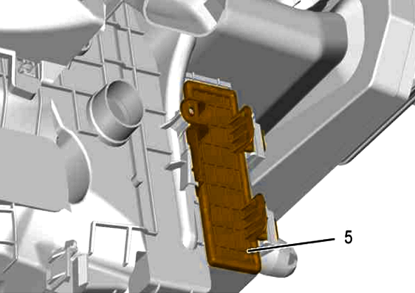

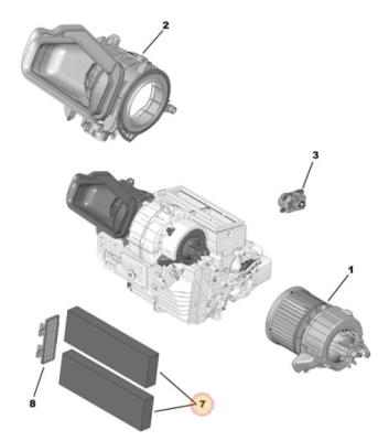

Cabin Filter:
(7) Cabin Filter, 3 Options:
OEM Original Carbon Filter (Particles & Gas), part: 9804163480, £50.96
Cheaper Carbon Filter (Particles & Gas), part: 1612920480, £21.07
Anti Allergenic (High Performance Carbon, part: 1616959280, £63.65
On a LHD this on on the right side, so can't see it being different for a RHD. I believe you need to remove driver side centre console trim (remove centre console side trim cap to reveal screw). You'll need to find the cover as below and remove this to extract and refit the 2 filters. There are 2 plastic clips (tabs) to release the cover.

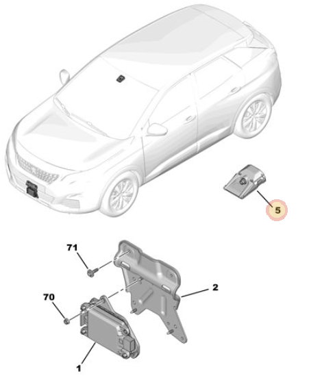

Can i get the oe nr for the front dash multifunction camera for lane assist.
Thanx alot
x 6956
(5) New OEM Multifunction Video Camera, part: 1679619080, £620.42
Exchange Multifunction Video Camera, part: 1692666580, £456.48
Remember, in addition to the camera, on this vehicle you also have ARTIV (Distance Control Radar) installed into the front grille. Sme vehicles have camera only based system, others use both camera and ARTIV unit, so you have both.

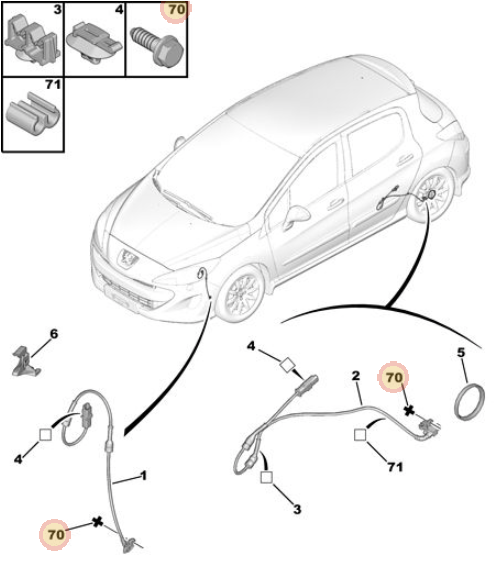

VF3**************[VIN obfuscated, can be read by forum staff] my vin ,This could be a minefield of an ask , need a 10mm bolt for the abs sensor possible part numner , thanks Marc.
:-D
x 6956
(70) MUL TH Screw with Washer, part: 692297, £2.38
