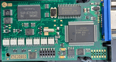

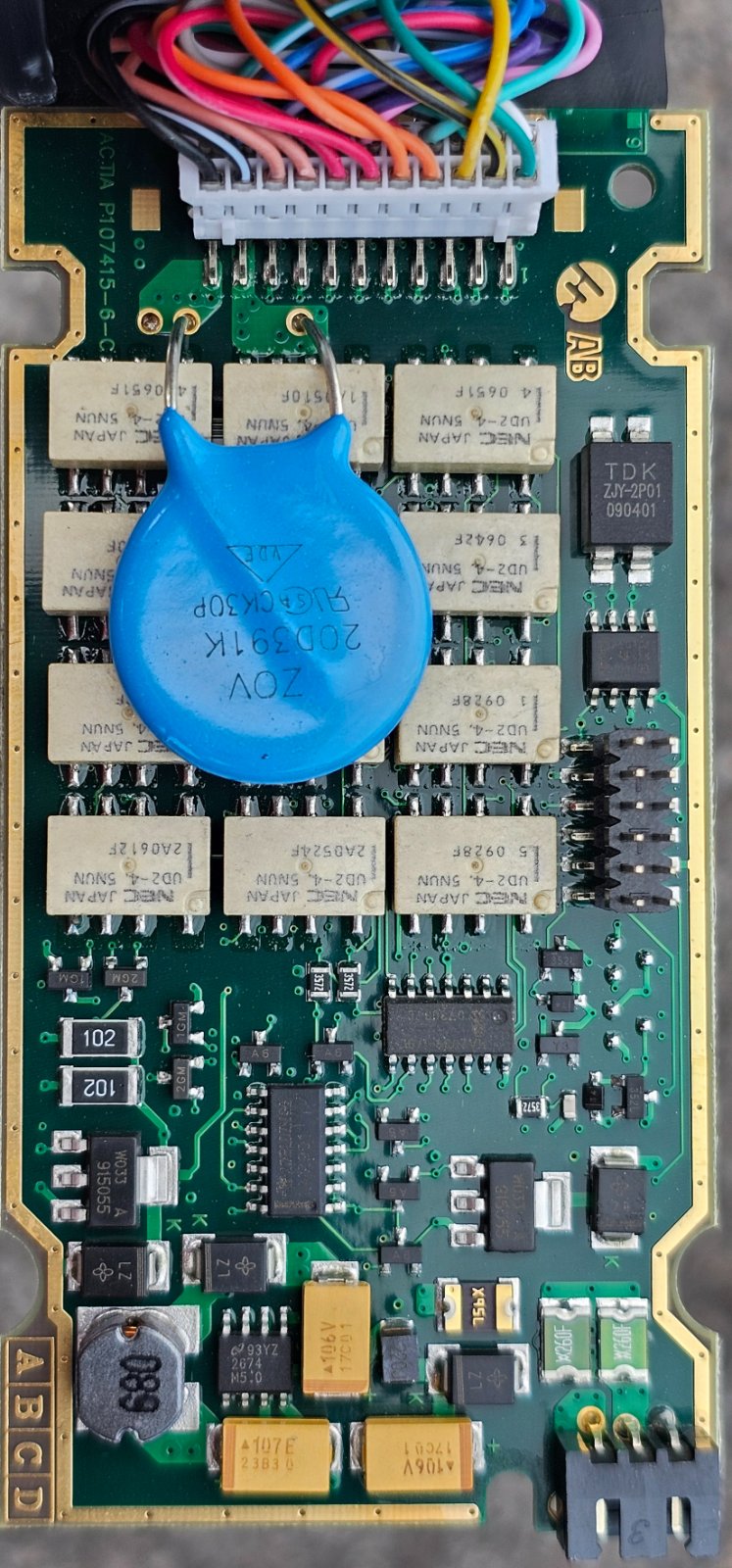

Did you get a chance to have a glance at those pics Marc?
I know you're a busy man so not rushing.
Just had a thought, when I'm home I better check diagbox version. Used to be 7.57 but I did wipe and refresh so not sure if it's a lower version now

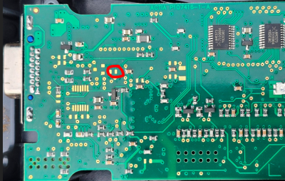

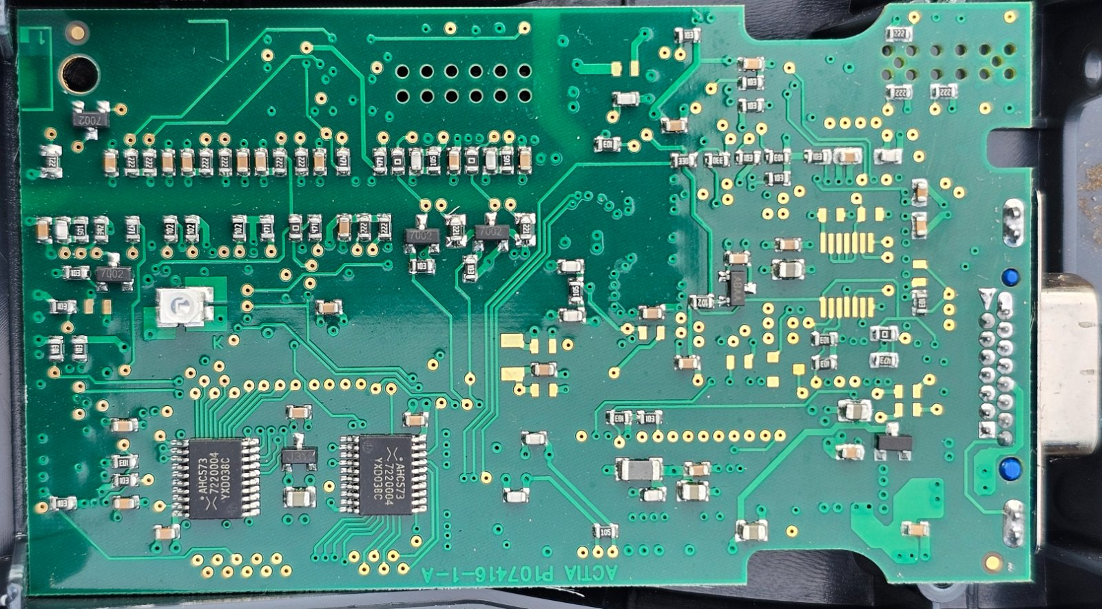

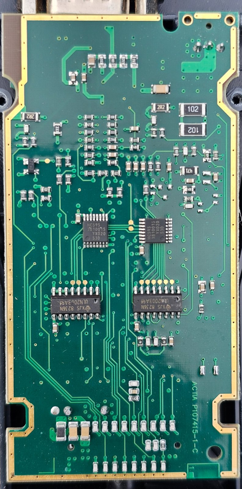

x 6955

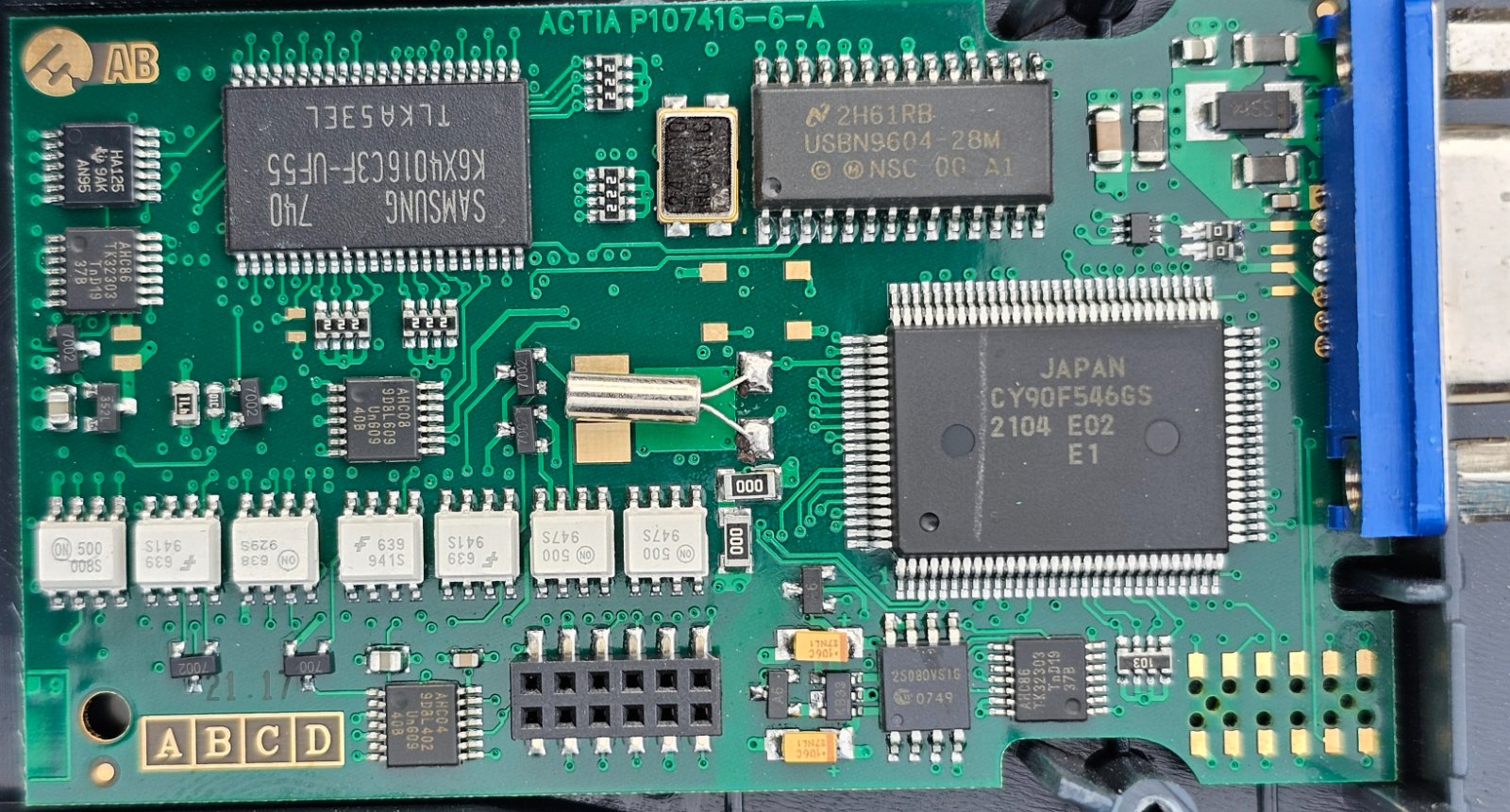

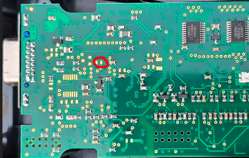

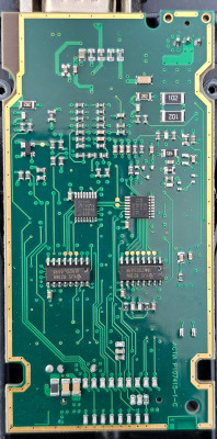

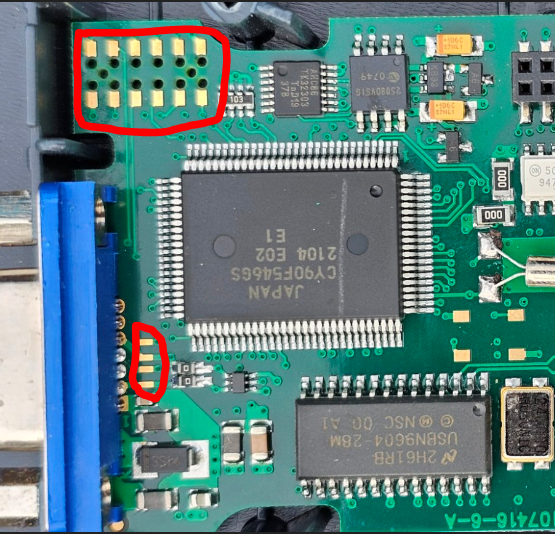

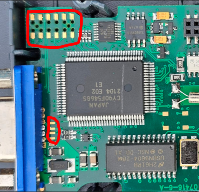

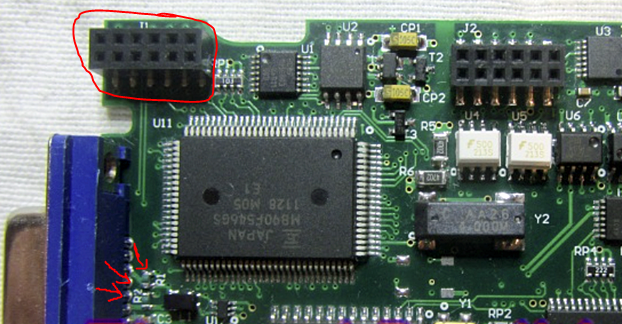

Re: ABS not activating (no codes). System bled.
Ok, so a mixed bag here, as in some places it looks to be ok, but on other boards there does appear to be missing parts:
On this board there seems to be a connector missing and some missing components where I have circled.

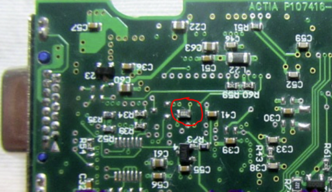

This is where there is supposed to be a 10k resistor that is missing on the left and where it should be on the right:
So although a slightly different board, there does seem to be some missing components, but not as many as I've seen on other boards that are missing way more.
x 6955
I've added some comparisons on the 2 areas that I picked up on ^
