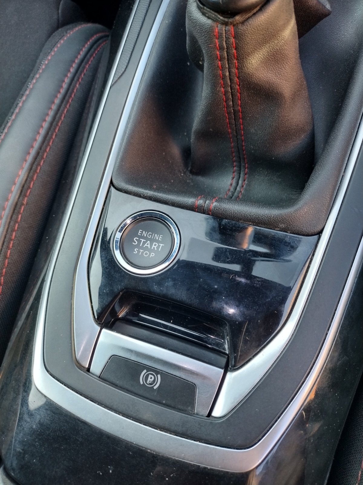

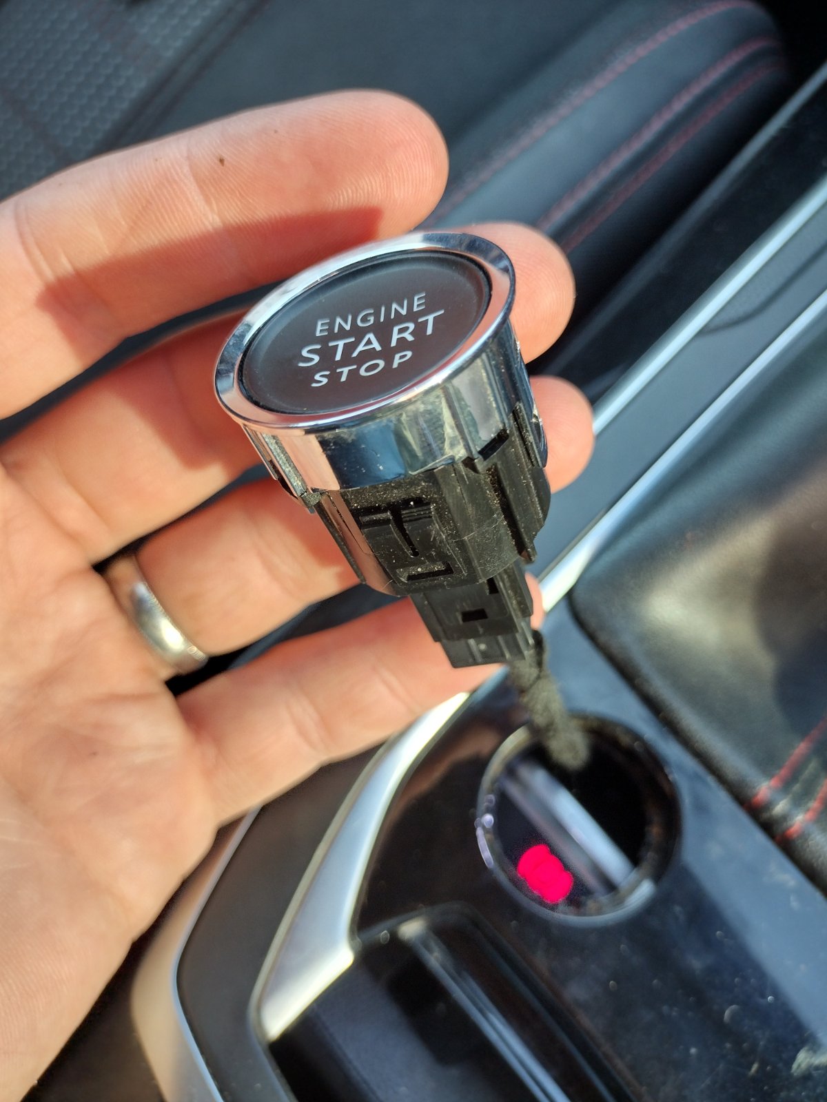

Start button, (eBay, £16.39, ex- Peugeot 208) arrived today - very quick delivery: bought yesterday , arrived today! (Has had a trip in a boat too as seller was Newry: Northern Ireland)

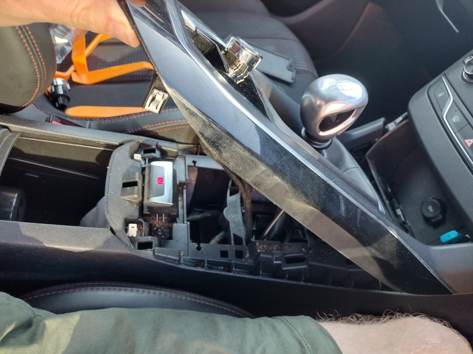

Pretty simple installation (once I had worked out how the gear surround comes off! eBay images of this bit did the trick)
Trim off
Trim off

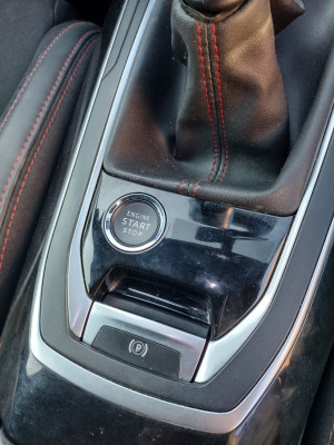

End result
End result

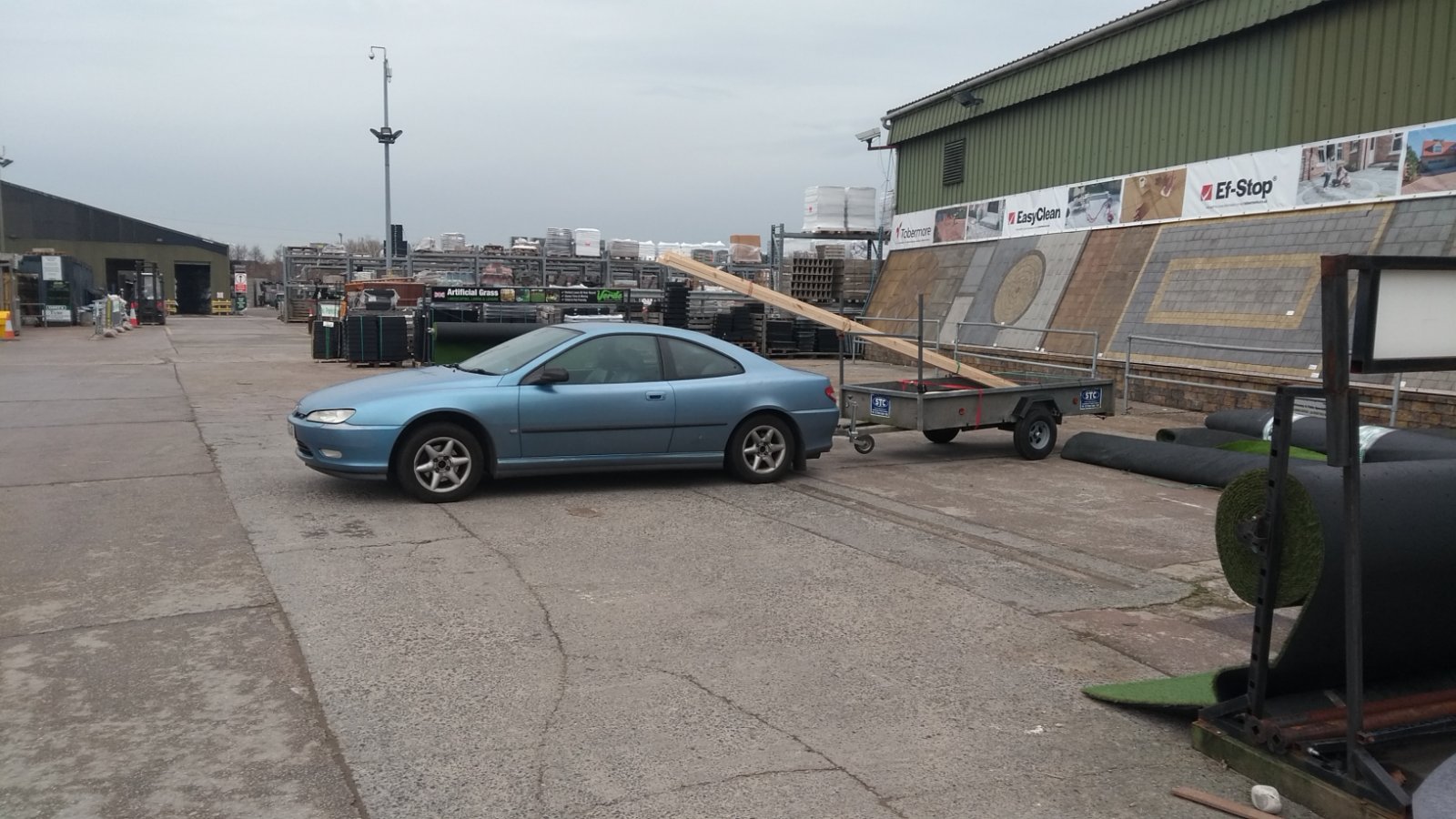

2.0 Coupe in towing mode:
download/file.php?id=42243&mode=view

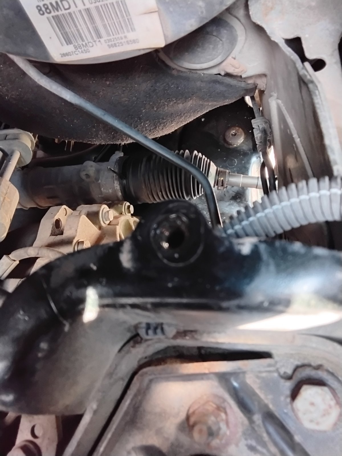

Just jacking your thread for your view on this Matt if thats ok with you, ive used a big cable tie on the steering gaiter boot, but do have new clips coming this weekend.
If this tie isnt good enought then i will change for new clips whe i get them.
Look down at the gaitor
:-D
Posts: 5358
Joined: 25 Apr 2022, 09:03
x 2362
Unread post by MattBLancs »
Huskyxantia wrote: 02 Aug 2024, 15:43 Just jacking your thread for your view on this Matt if thats ok with you, ive used a big cable tie on the steering gaiter boot, but do have new clips coming this weekend.
If this tie isnt good enough then i will change for new clips whe i get them.
No problem with the thread jacking at all, opinions from me and hopefully others can confirm (or let me know if I'm talking a load of old cobblers!!)
I've not had much interaction with steering racks beyond outer track rod end replacement, but my understanding is the boot you've changed is a "keep the dirt out" device, unlike say a Citroen ram boot which has some LHM inside it (and so has a drain connection for this to be routed back into the system).
As such, I don't think there is much pressure build up inside the boot, so would expect the big cable tie to hold it together fairly well.
I have seen rack boots with a "link pipe" running from one boot to the other. I guess this is to allow pressure to travel between boots as one "accordion" is squashed down, the opposite"accordion" is being pulled out.
Hopefully I'm on the right lines!
Other thing - if you've got proper clips on the way, I'd likely stick them on when you get chance as at least it's as the designer intended (even though the cable tie may not be any worse!) :)

Chipping in on cable ties, I ran my C5 2.2 for 3 years with the boots cable tied and had no issues at all. As long as you make sure you do them tight and you don't use ones that are biodegradable - yes you can get them! - I would say it will be fine!! :)

So my plan is im going to put clips on , there jubilee type so there shiuld be enought room for a small rachet to do the job , where theres a way there a squashed hand between the subframe and steering rack :rofl2:
