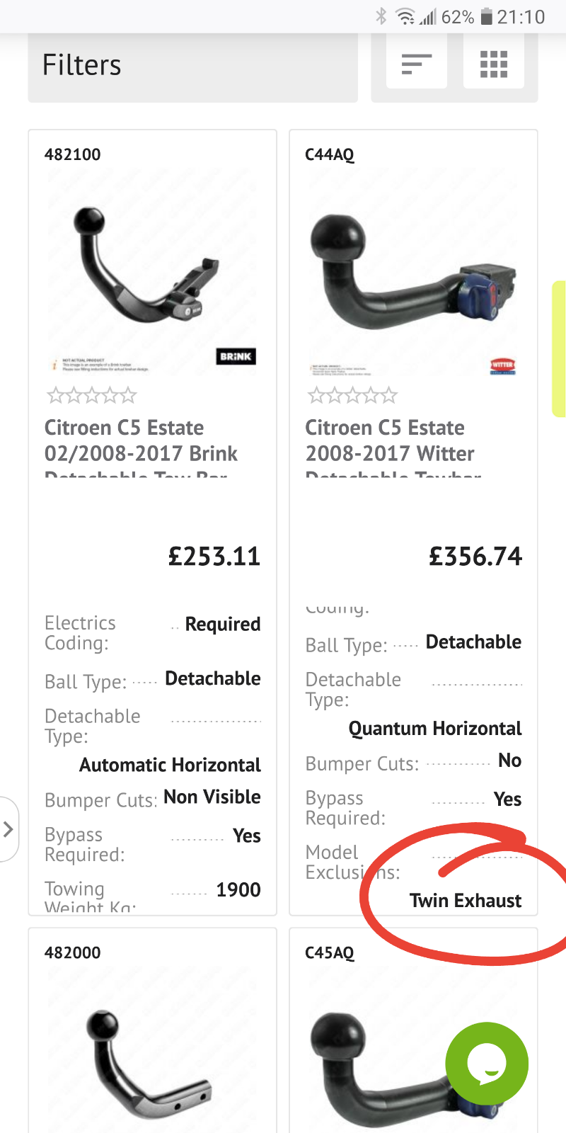

Hi. I’m trying to get a towbar for my 2010 Citroen C5 Tourer 3.0 V6 HDI. Every place I’ve tried has asked is it’s twin exhaust model and the hydropnaumatic suspension and rear parking sensors, which it is and then I’m told no one makes one to fit. Can anyone advise me where to look to get one, it’s to tow my sons Moto X bike. Thank you.

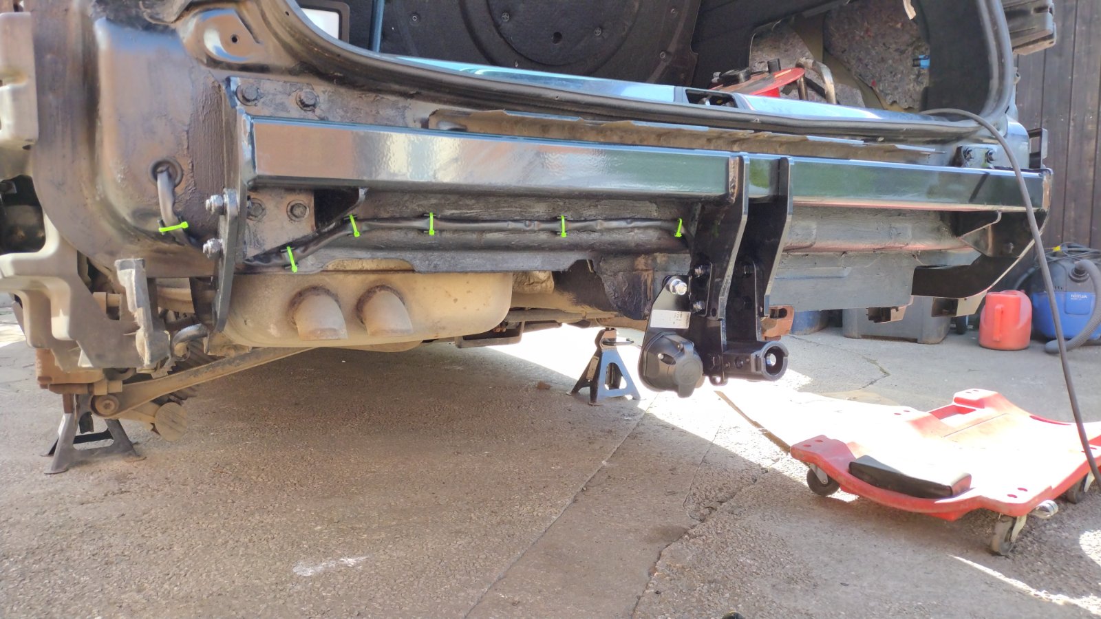

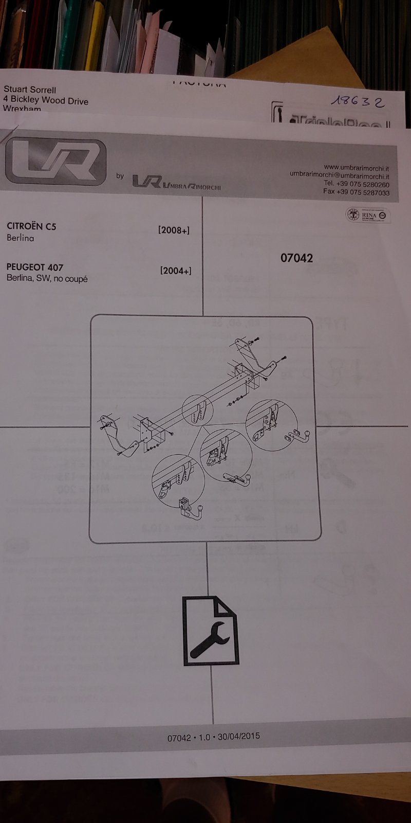

I've recently fitted this towbar to my 2.2 HDi X7 tourer. Yes is single exhaust, but you can see how far above the exhaust the structure of the towbar sits. It replaces the bumper crash bar.
How are the twin exhausts arranged? I'd be surprised if so far up into the structure - the cable run (with sexy green cable ties) is fastened to the edge of the boot floorpan, so unless it has a different boot floor on yours I can't see how the exhaust would block towbar installation.
I need to (pick, then buy) a better towbar wiring kit (came with a "universal" wiring kit i.e. 7 pin socket and meter and a half of multi core cable - I'd rather something "plug and play" so it's likely I'll take the bumper off again to route that. If you want any measurements taken just let me know.
Towbar is cheap detachable item, off eBay, direct from Italy. Can dig out the details if interested.

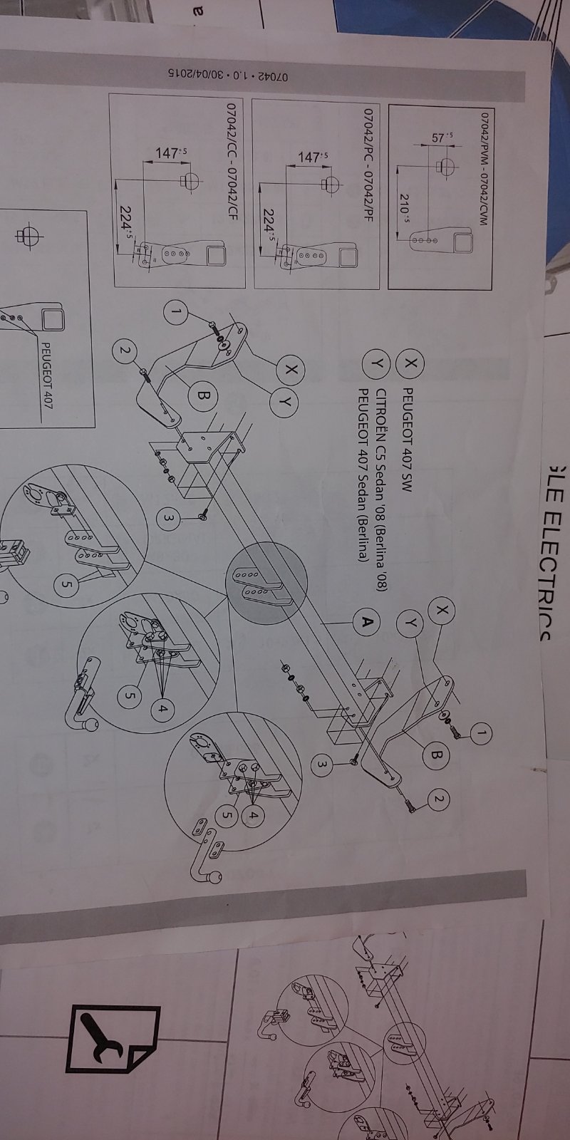

Hi Matt, the kit I bought for my 2.0 HDI was9428 F7 /F8, the basic one it includes the towing ECU. - just plug and play, well almost you have to tell the can it's fitted. I still have the fitting instructions if anyone wants a copy just PM me and I will scan and send a copy.
As for installing, I didn't remove my bumper just the lower panel and it fixes to the bumper bolts, but I surely the twin exhaust body is the same,

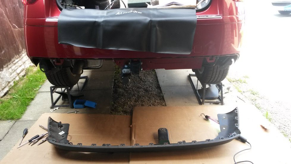

Thanks Stu for showing how you did it. I didn't realise that lower panel was (easily?) Removed.

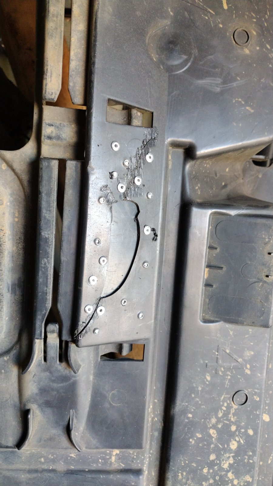

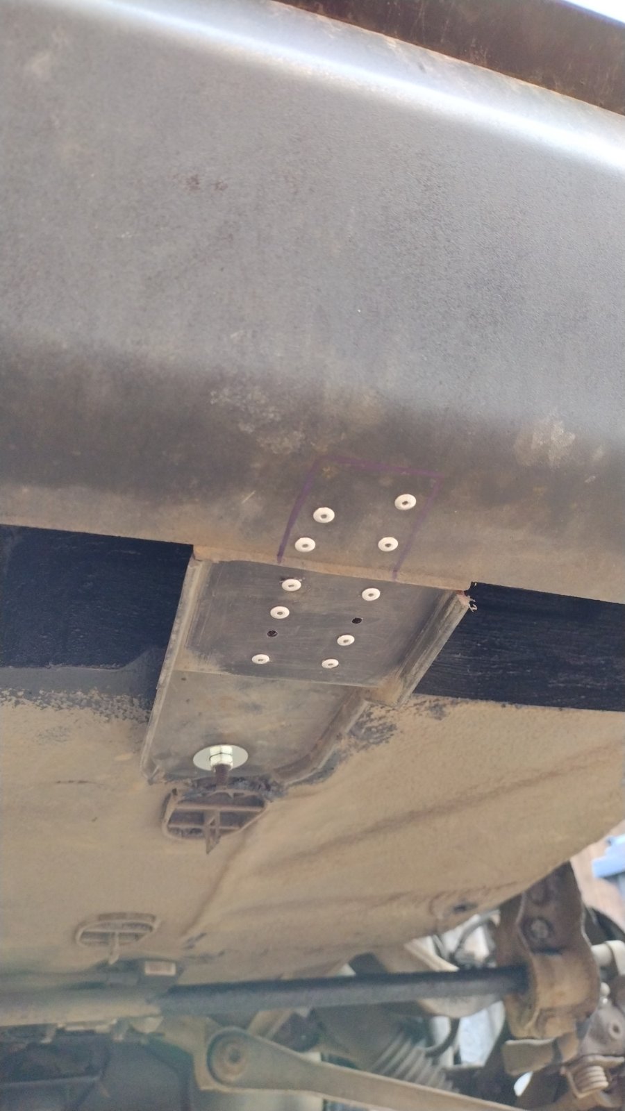

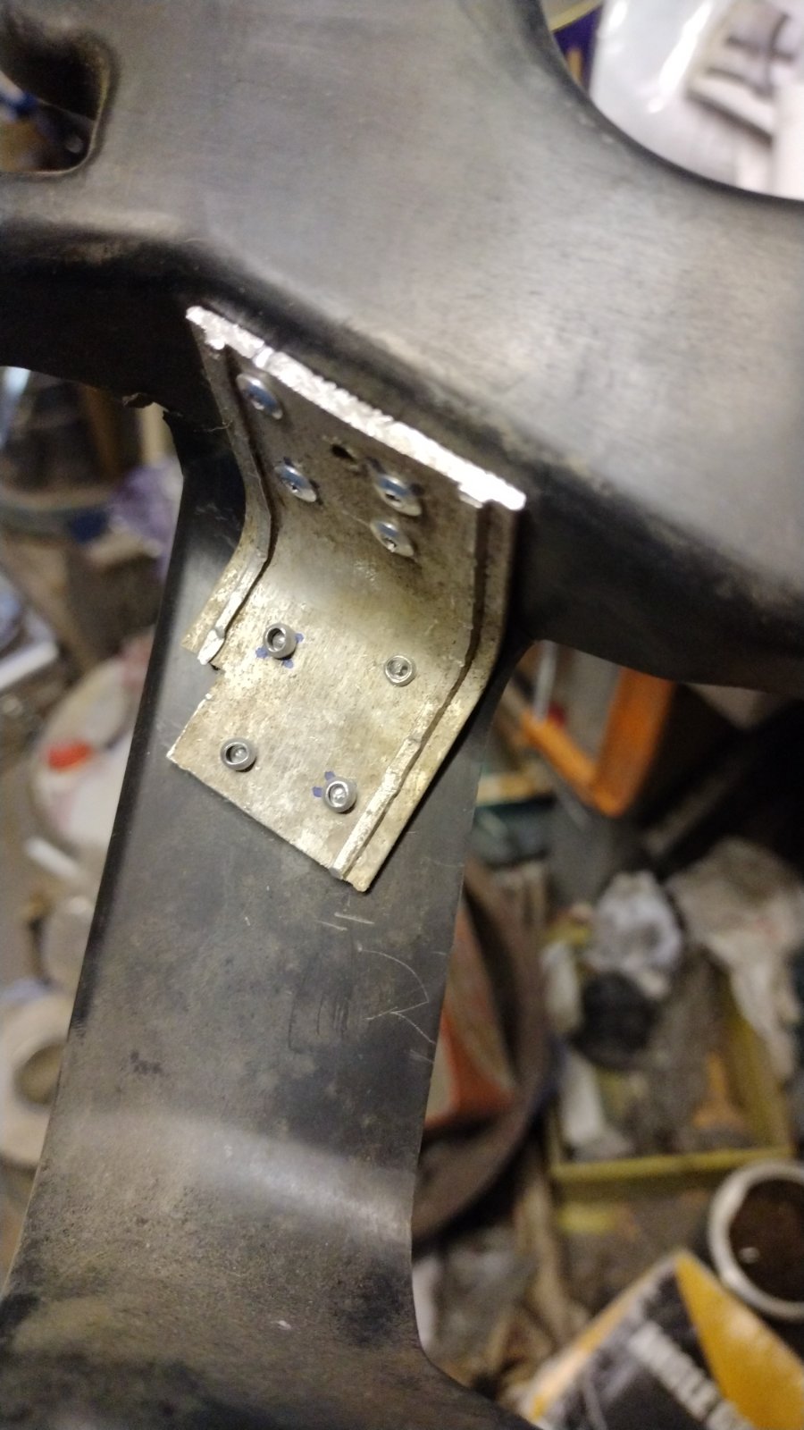

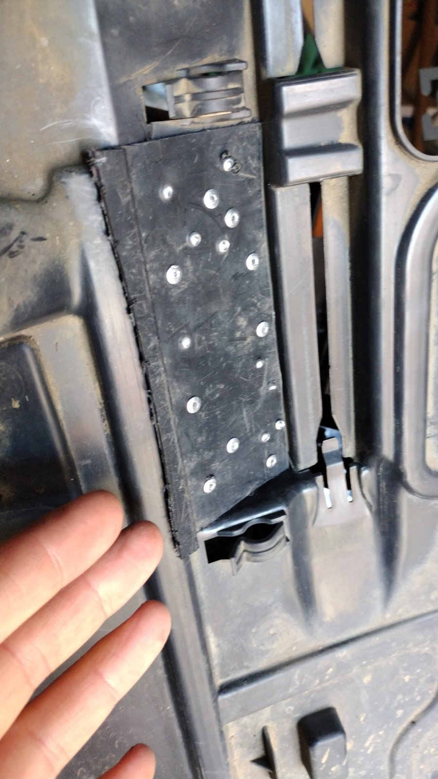

I took the full bumper off as pictured above and pleasantly surprised - pretty straight forward really.
The little "flap" of plastic (pinned by a M6 stud and a flange nut on the spare wheel well) was unattached at the bumper end on mine. Also there's a plastic support structure either side behind the bumper - mine was cracked in two, so not offering much support.
Both fixed with pop rivets and offcuts of (ex broken recycling bin lid!) Black plastic and some aluminium. So worth removing the bumper to access and fix these. Can you tell why any "quick job" tends to take me a while!?

Actually, I am misremembering. Rear bumper flap was also aluminium to reinforce it. It was further forward the bin lid was repurposed:
Matt

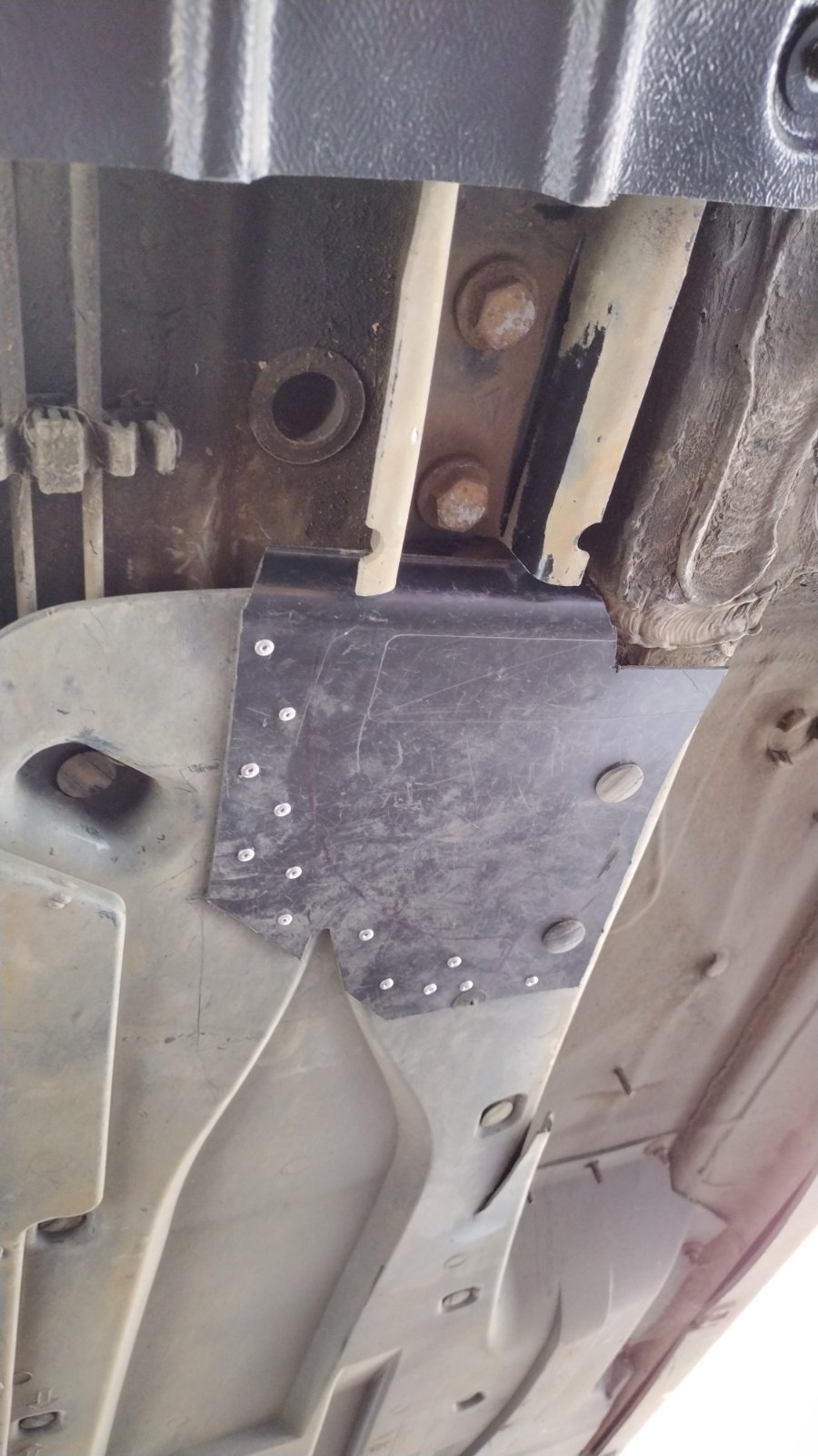

I was asked to post this pic in here, which I had originally posted in a thread where someone was selling a 2.2 towbar. The pic piqued matt's interest as it shows the remnants of a towbar that is present on our X7 v6 HDI....
I don't know how helpful that's going to be, but I'll be lifting our X7 on my two poster in a couple of weeks to do some hydraulic work, so could take more pictures if needed? Just let me know if there's anything specific you want to see?
