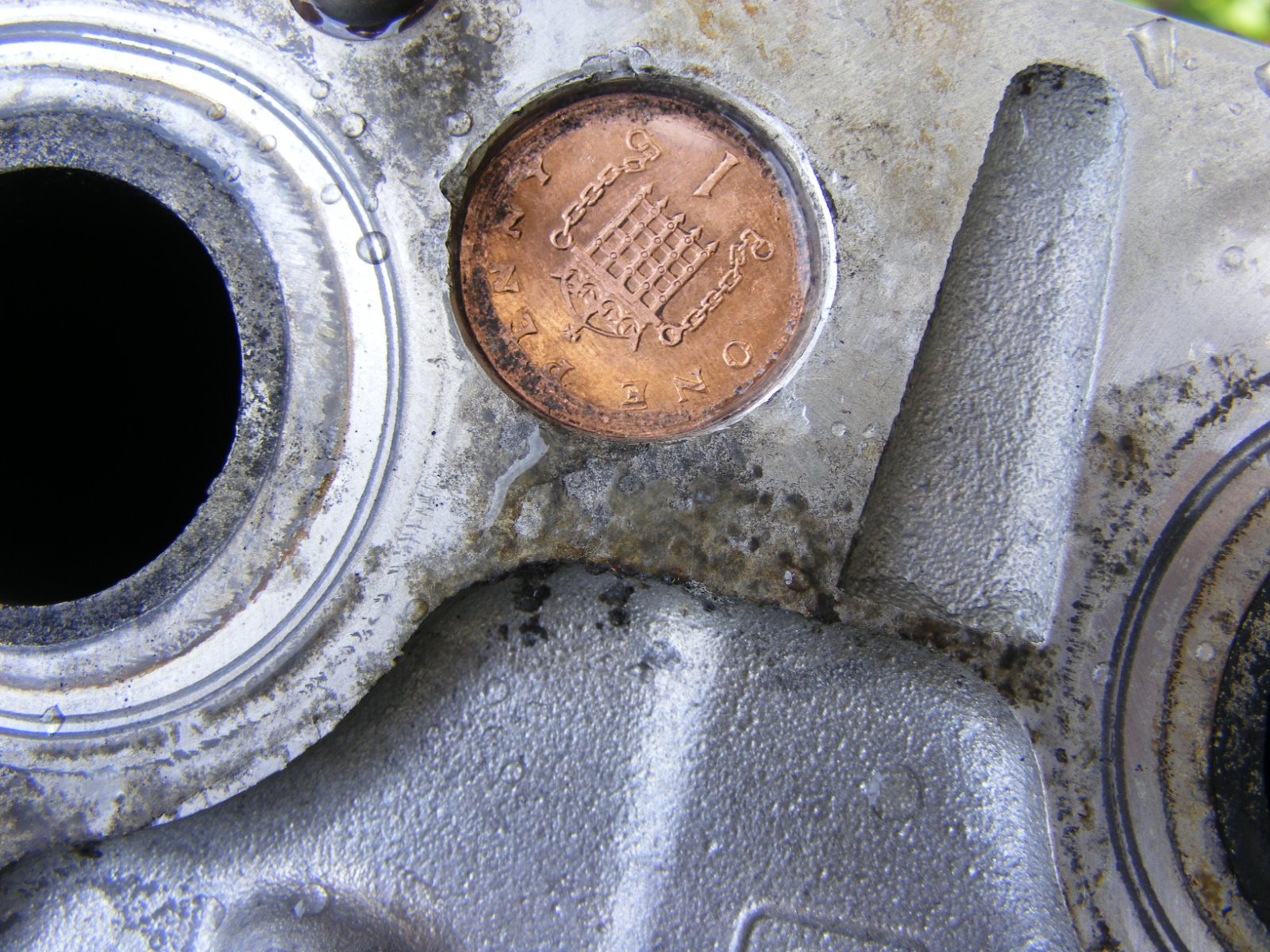

And the old skool enginering speaks for itself too , all coolant levels are alsways on the mark thanks to this
