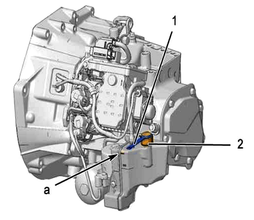

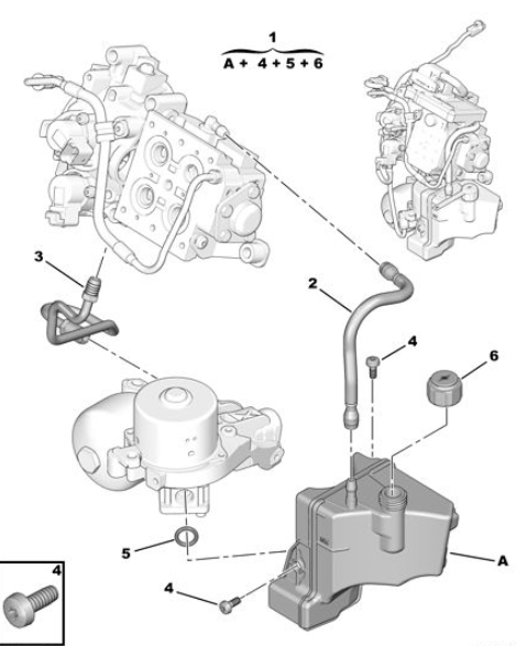

Here are the diagrams showing the relevant parts:
(2) Is the actuator Electro pump.
You can see the filling point where the cap is shown at (6).
The special oil is Magneti Marelli / Selenia Oil, part number: 9979A4, £52.25 per litre.
Again, as mentioned before it is essential to depressurise the system first with a diagnostic tool before checking the oil level and topping up to the max mark. Do not attempt this whilst the system is pressurised or you will over-fill it and when it is re-pressurised you will damage the system.
Fill via the cap (2).
Fill to the maximum mark (as "a").
Connect the diagnostic equipment to the vehicle’s diagnostic socket.
Switch on the ignition.
Select from the diagnostic tool menus:
Select: Depressurisation of the hydraulic circuit.
- Check the level of oil contained in the piloting actuator hydraulic reservoir.
- The oil level must be at maximum (as "a").
- Top up with oil if necessary
- Pressurise and bleed the hydraulic circuit
