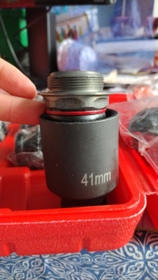

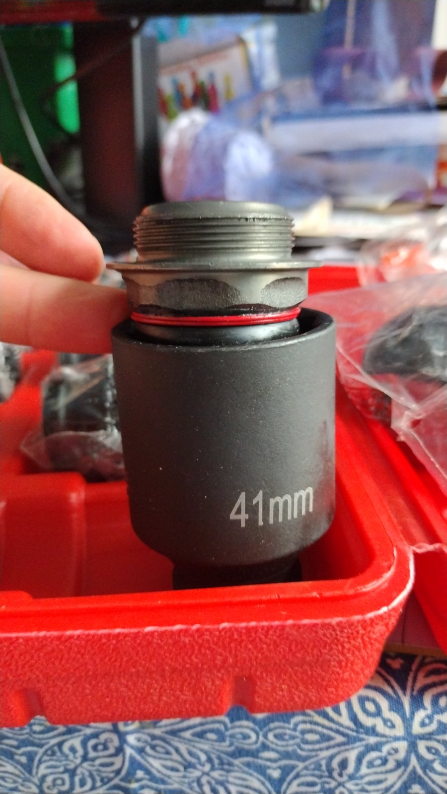

It's one of those days today, here is the new bottom ball joint fully inserted to the new 41 mm "deep" impact socket. Note the lack of depth!

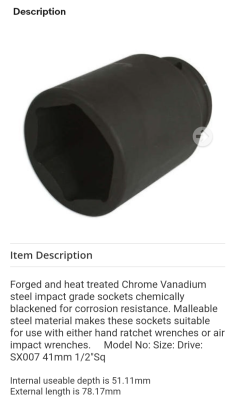

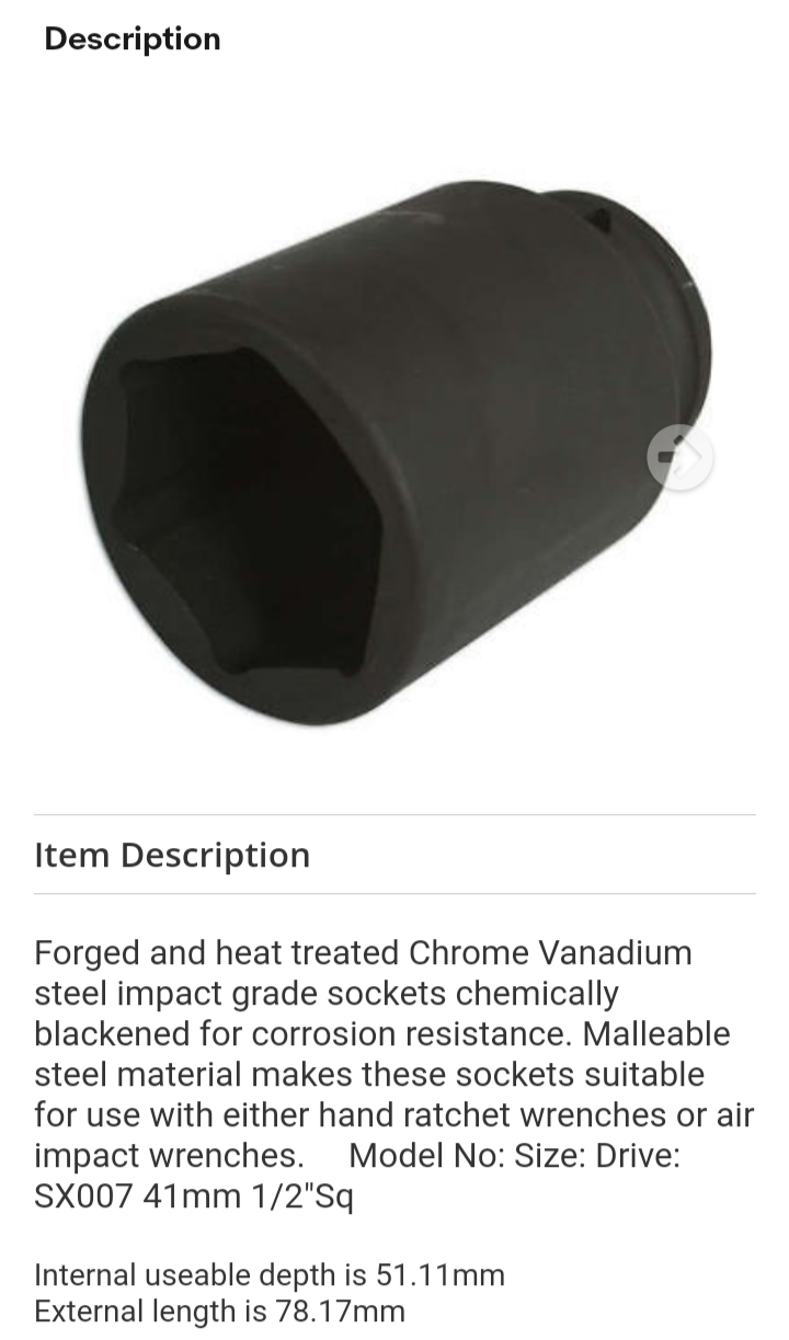

Hmmmm, the above says: Useable depth 51.11mmMattBLancs wrote: 09 Jul 2024, 15:10 specific "ball joint sockets" instead.
Such as: https://www.ebay.co.uk/itm/180733075517
£18.09

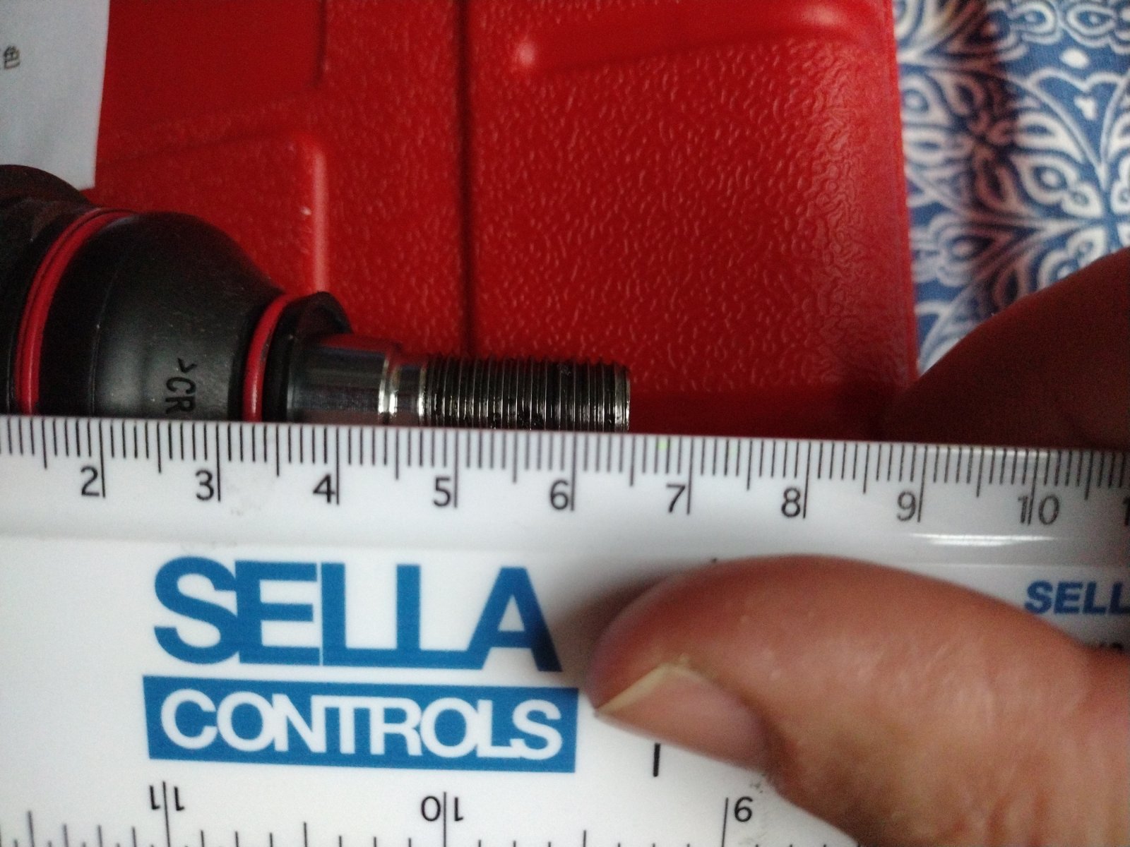

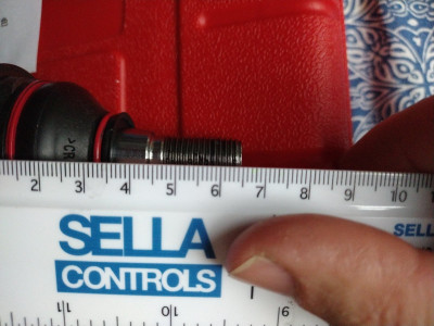

Where as ball joint: Crudely more like 65mm to sit on the flats.
Keen not to punt another £18 on a socket to find it's not deep enough. Not found another supplier confirming the internal depth.
