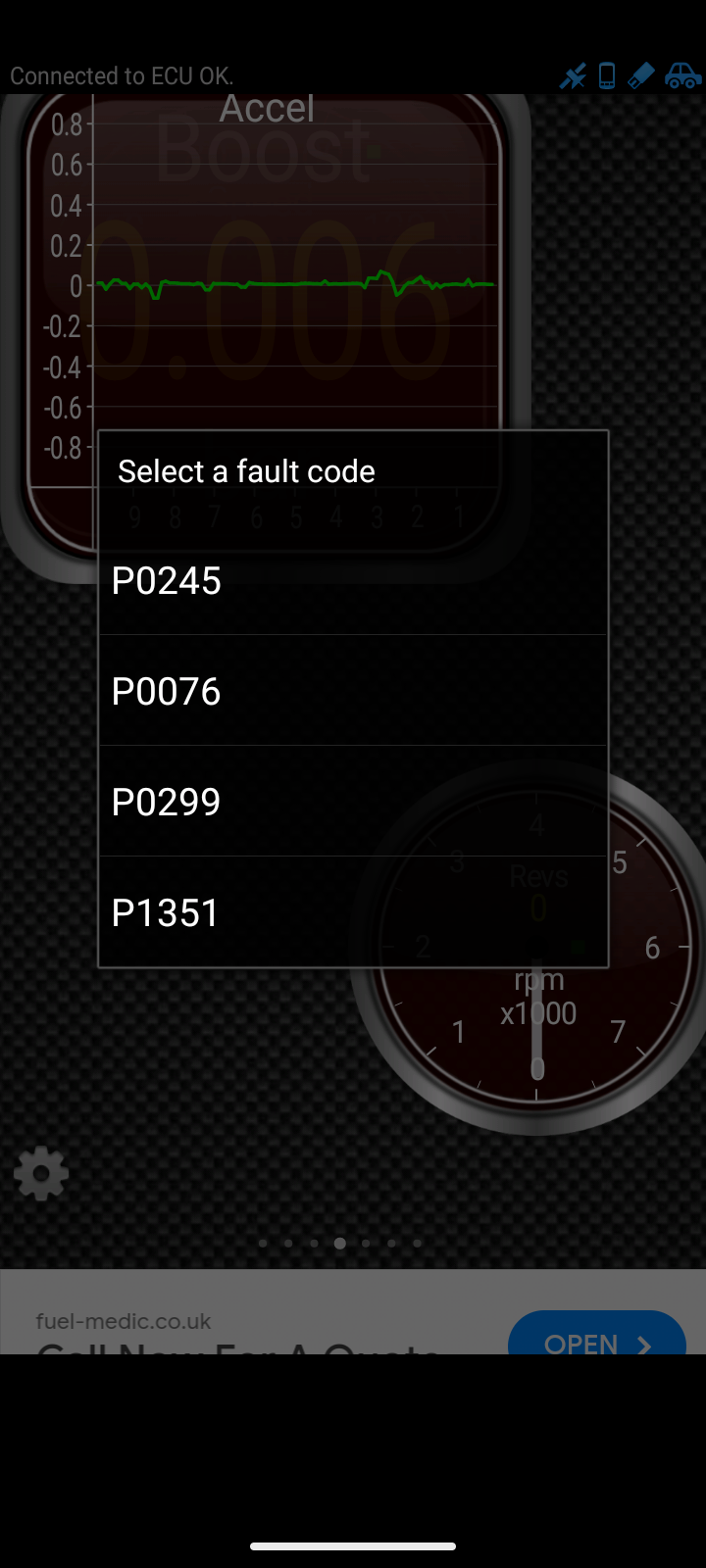

Quick wipe of the codes with the Bluetooth OBD2 reader and torque app. Snip of logged codes.
Engine management light didn't return on trip in, but C5 feeling a bit "flat" at moment.
Will get DiagBox on the go soon for a read.
Also try and read up on Euro 6 adblue related issues and decide if I could live with a car looking perpetually filthy (i.e. a white one. In particular this contender: https://www.autotrader.co.uk/car-detail ... ion=Manual. )

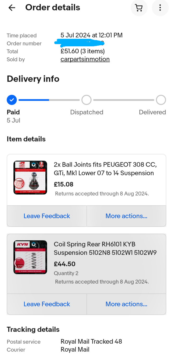

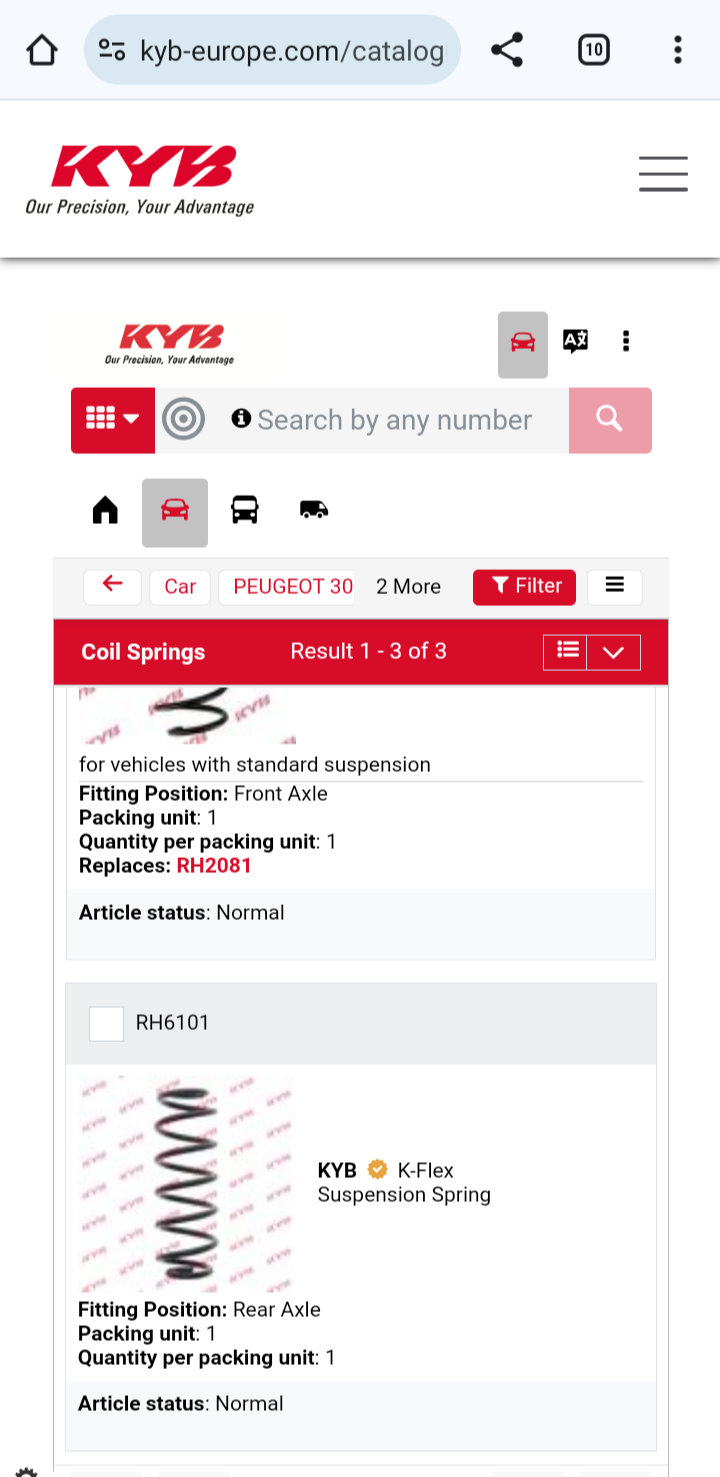

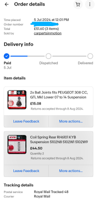

Part numbers checked on KYB website (rear 308 SW springs: RH6101)
Car Parts In Motion, cheaper through eBay than on their own website!?
Springs worked out at £22.25 each, then buying two dropped it to £21.14. then a voucher for 10% off knocking it down again to £19.03 each.
Same seller I've bought a pair of Febi Bilstein front ball joints, £15.08 for the pair, the above voucher taking it down further to £13.57.
Totally up the above gets me to £51.63 but eBay has charged me 3 pence less, £51.60, who knows, but suits me!

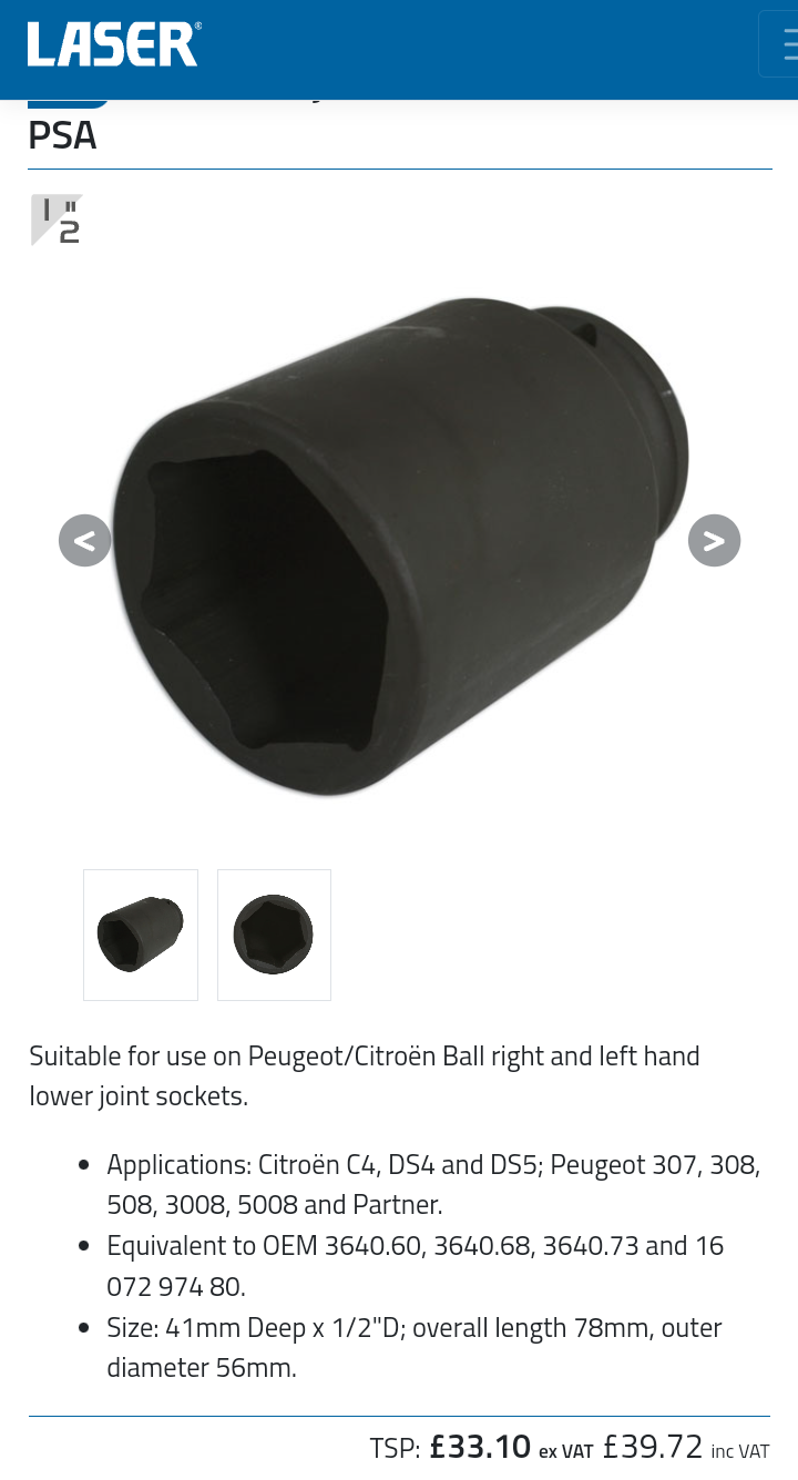

Can anyone confirm: Google suggests I need a 41mm deep socket for the ball joint task - is that correct?
I'll have to get under the car and get my Verniers at it, nothing anywhere near that big, certainly not in deep format.
https://www.ebay.co.uk/itm/155183944240
(£8.88 half inch drive)
Halfords
https://www.halfords.com/tools/hand-too ... 12526.html
41mm £11.19 on trade card
Or could get a 10 piece set, including 41mm, for £25
https://www.ebay.co.uk/itm/364899793008
B&Q (in their new "pretend to be eBay/Amazon" mode)
https://www.diy.com/departments/us-pro- ... 390_BQ.prd
£8.85
Halfords
£8.85

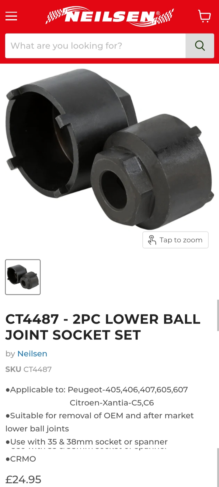

Armidillo
- Posts: 477
- Joined: 28 Apr 2020, 02:18
- x 274
So do the 308 ball joints look different to the 406?
I presume you've already got the special tool with the 4 lugs, which in turn requires a 35 mm deep socket to turn it?? Mine does 406 & 605 ball joints, plus Xantia & XM (and no doubt others).
- Posts: 5325
- Joined: 25 Apr 2022, 09:03
- x 2347
Yes, all change!Armidillo wrote: 05 Jul 2024, 14:34 So do the 308 ball joints look different to the 406?
406 / 605 / (just checked and discovered whilst grabbing a picture) Citroen C5, C6 and seemingly Xantia 405, 407, 607 = special tool with 4 prongs.
308 (seems full list is: "Citroen C4, DS4 and DS5. Peugeot 307, 308, 508, 3008, 5008 and Partner" ) = a big hex, 41mm. Odd partner listed but not Berlingo!
