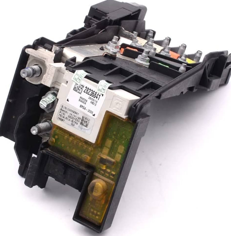

The BPGA (I've corrected the acronym in my last post) is the French designation (Boîtier de Protection Général des Alimentation, but yes, is the power supplies protection unit.
This is the unit, not to be confused with the engine fusebox in the same location.
BPGA
BPGA

Re: DS DS5 no electrics
Thanks Marc,
Could there be a particular fuse that I could check that might cut the power or does the battery supply go through the BPGA before the fuse box ?
to me it seems more than just a fuse as, there was a clicking noise just before I placed key in port and then nothing after.
More like a relay failing ?
