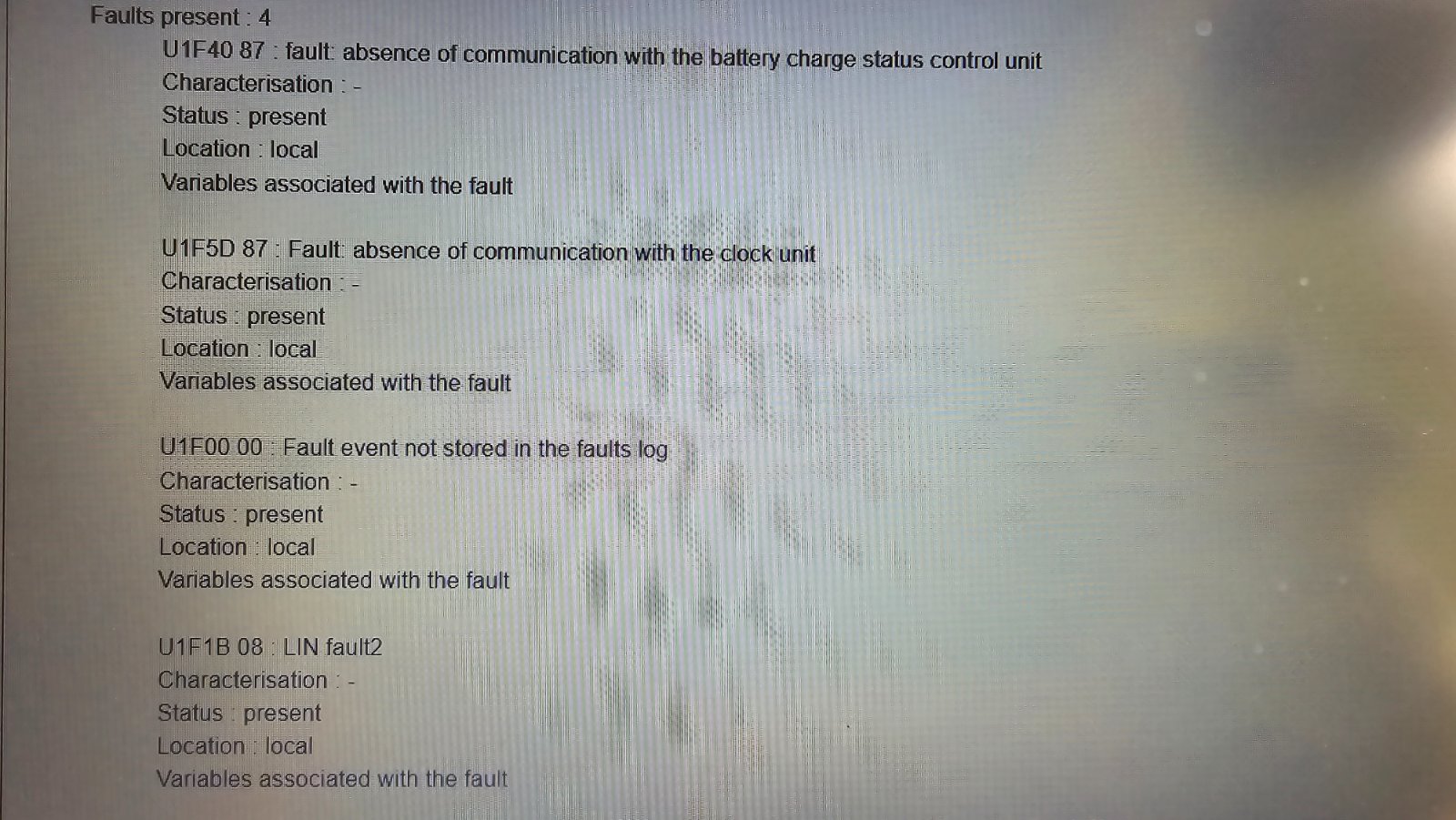

This is a strange one). After 3 weeks of not using my Ds7 1.5hdi I started up the engine. It was cranking bit longer than usual, but fired up. I moved it a bit, switched off, put a battery on charge and after some time on the next start:
1. Clock didn't pop out
2. Have your engine repaired pop out
3. Tyre pressure monitor start blinking
4. Start and stop (amber blink, than solid)
Now is driving ok, but still clock wont pop out, and got engine repair reminder every time. Checked with Diagbox, there was some other faults accompanied with loss of power(probably long cranking) even immo fault). those one are present
Ok I believe that start stop absence is caused by faulty battery charge unit. Does battery charge unit can be damaged during a starting?
How bout a clock? Anyone had something similar? As far as I know clock is steered by screen (touchpanel)

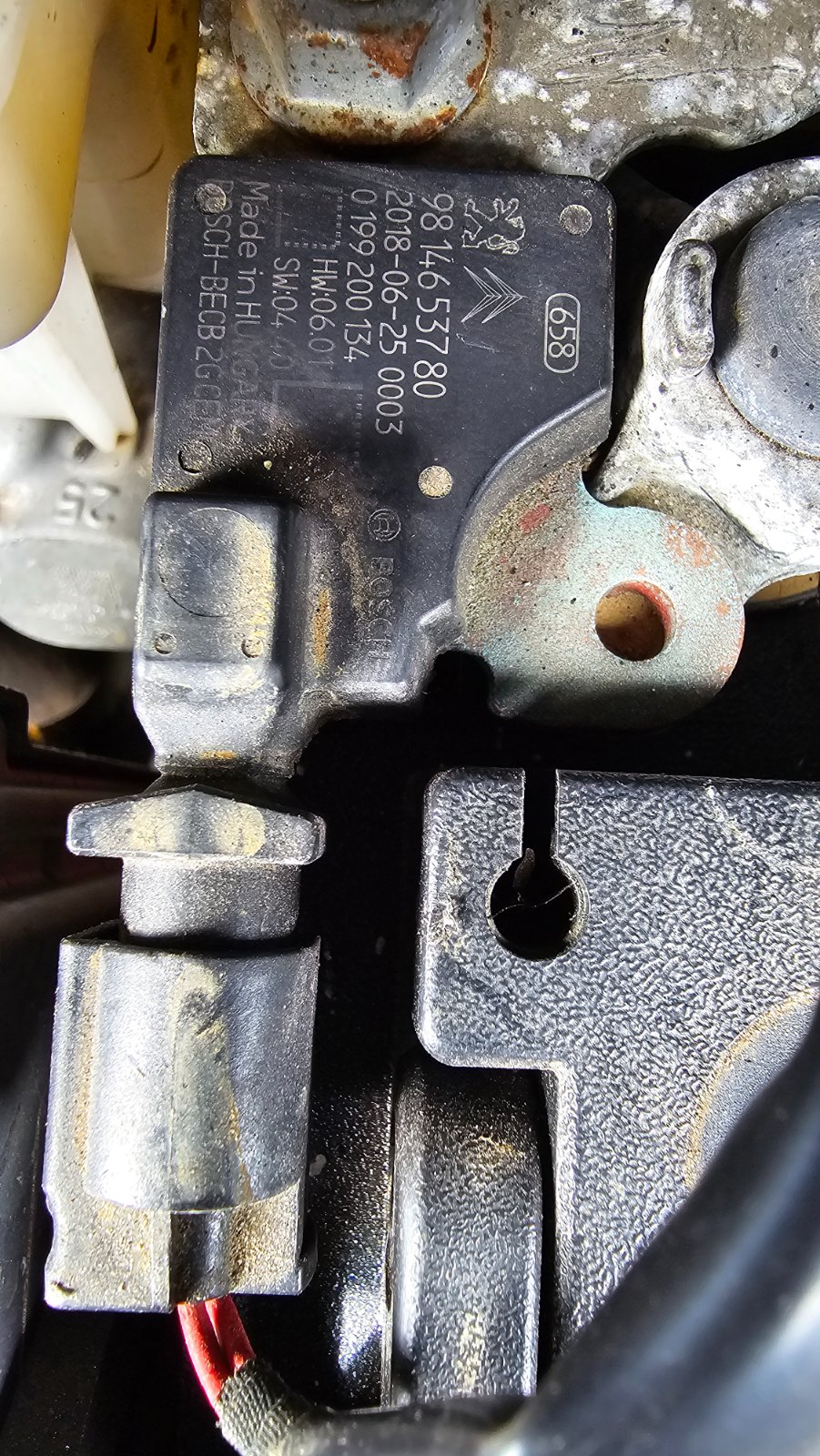

Did a bsi reset, clean clamps, did rescan and still the same. I am gonna change battery charging unit. In my opinion this causing a lin fault2. If this unit is broken there is no connection between bcu and bsi. New one cost around £100.

Yes Diagbox did first fault U1F40 87 absence of communication witch battery charging unit

I'm still gearing towards the main battery being discharged. The weakened supply state can adversely affect systems, so leave it charging overnight or longer and see if this helps.
Fault Code: U1F40 87
Description of Fault: Absence of communication with the battery charge status control unit. No communication with the battery charge status unit (Between 1,6 and 2,4 seconds).
Conditions for Fault to clear:
  • Return of communication for between 1,6 s and 2,4 s.
Downgrade Modes whilst Fault is active:
  • Change to energy economy mode 5 minutes after cutting of the engine
  • Switching on of the warning lamp and/or warning message Economy mode active message (Ignition on and engine stopped)
  • Flashing of the battery warning lamp for 7 seconds (Ignition on and engine stopped)
Symptoms:
  • Certain vehicle functions are unavailable
Suspect Areas:
  • Supply of the battery charge status control unit
  • LIN
  • Battery charge status unit
  • Supplies protection and management unit

OK. Get to the bottom of it. It was a problem with artiv radar plug. Broken 2 wires. I bet any money that was a can wires. After repair all faults gone. problem solved
