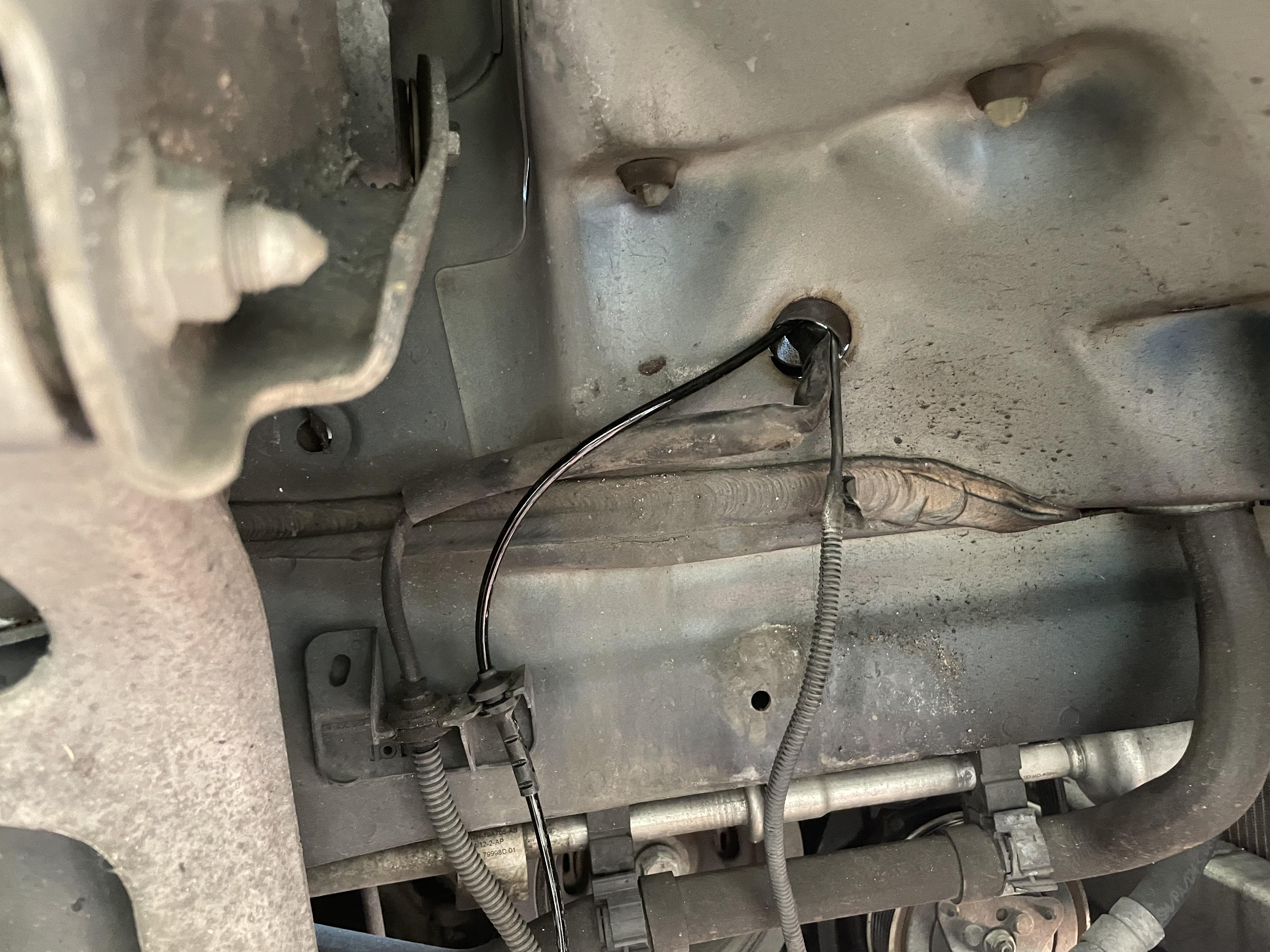

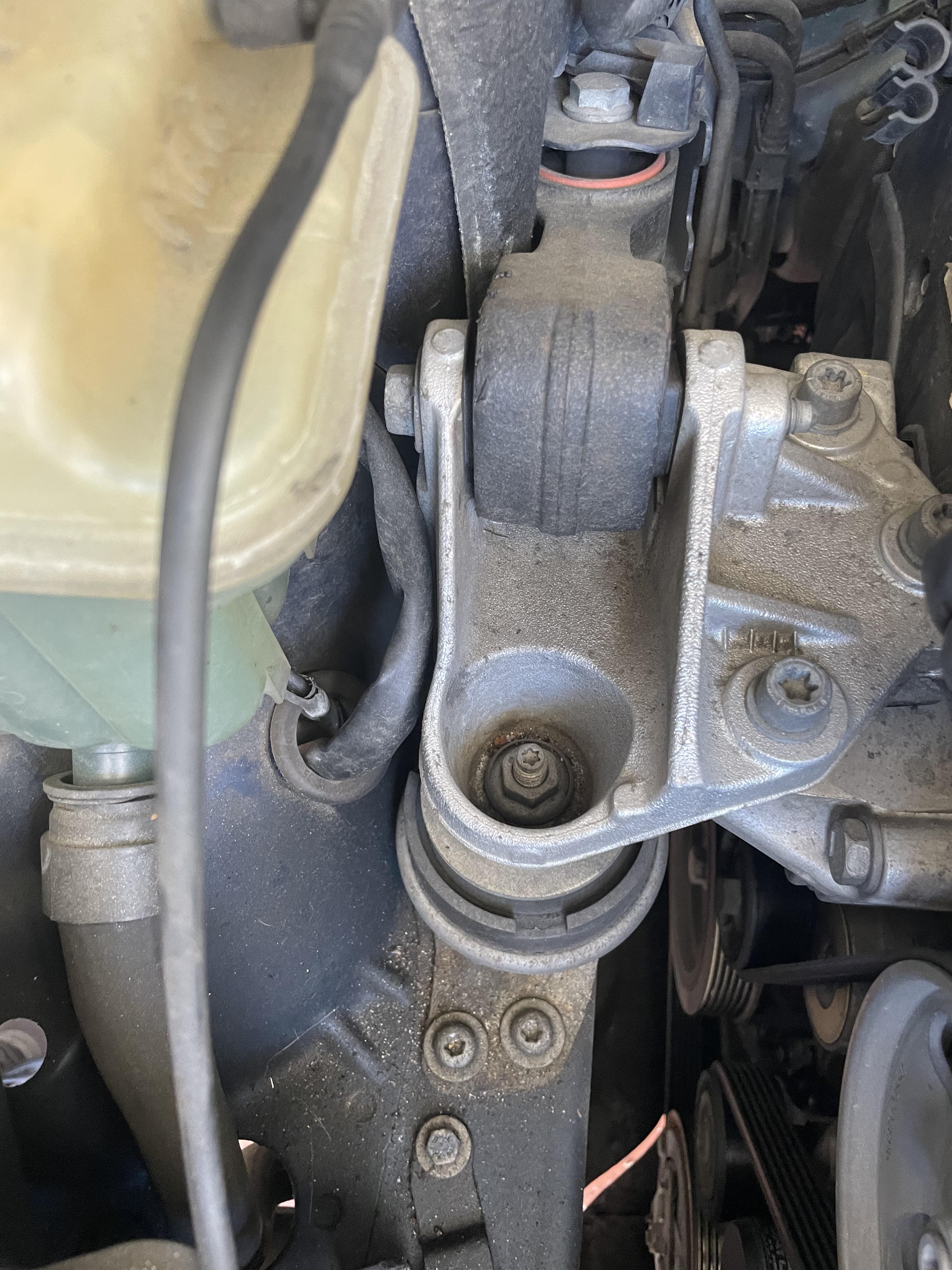

I got around to changing the sensor. The right side sensor was near the wing, just by the expansion tank. I'm leaving a couple of pictures, it might help someone out.
The sensor comes into the engine bay by an opening near the expansion tank.
It attaches to the connector at the wing. The abs sensor cable runs under the expansion tank.

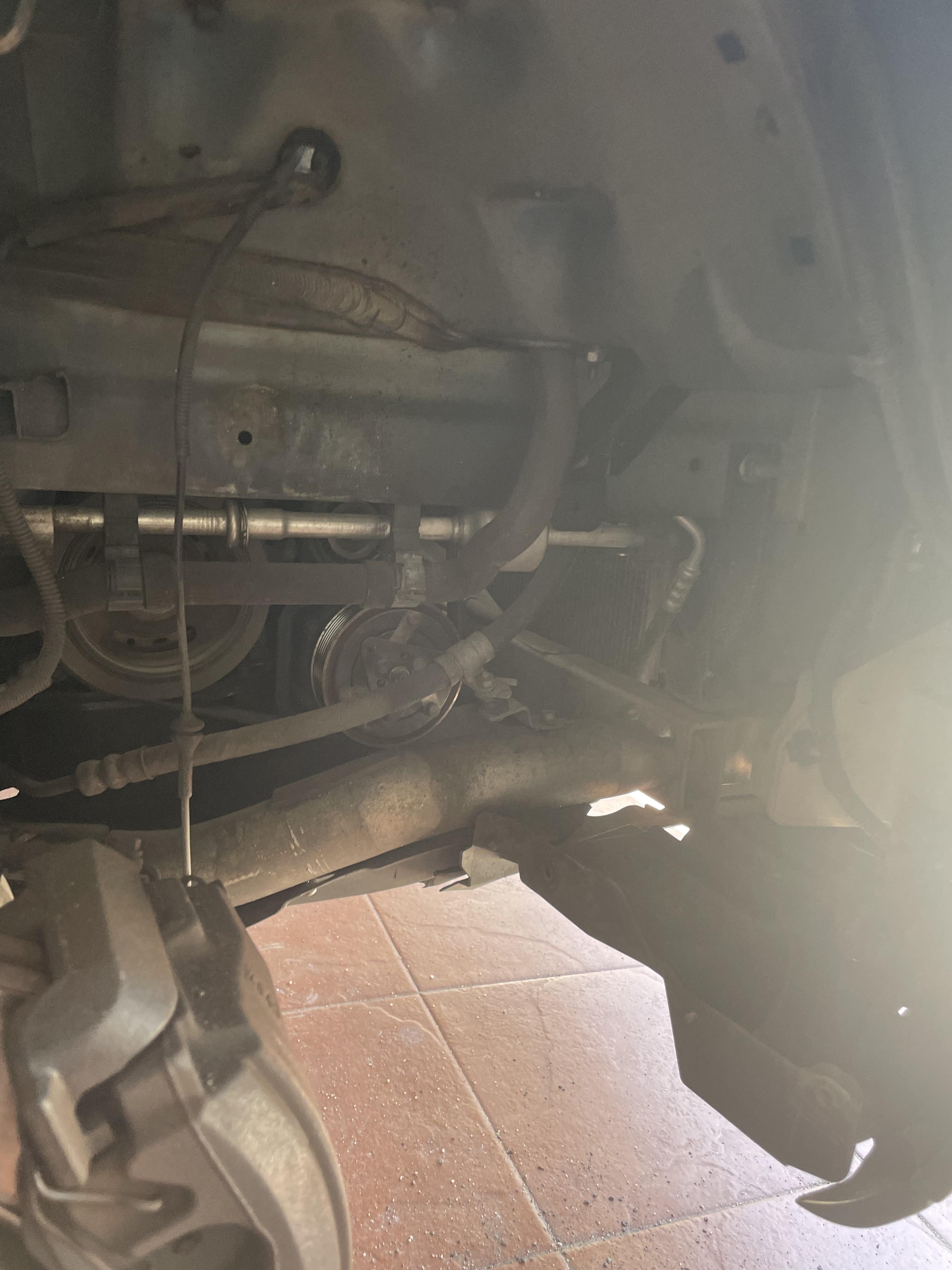

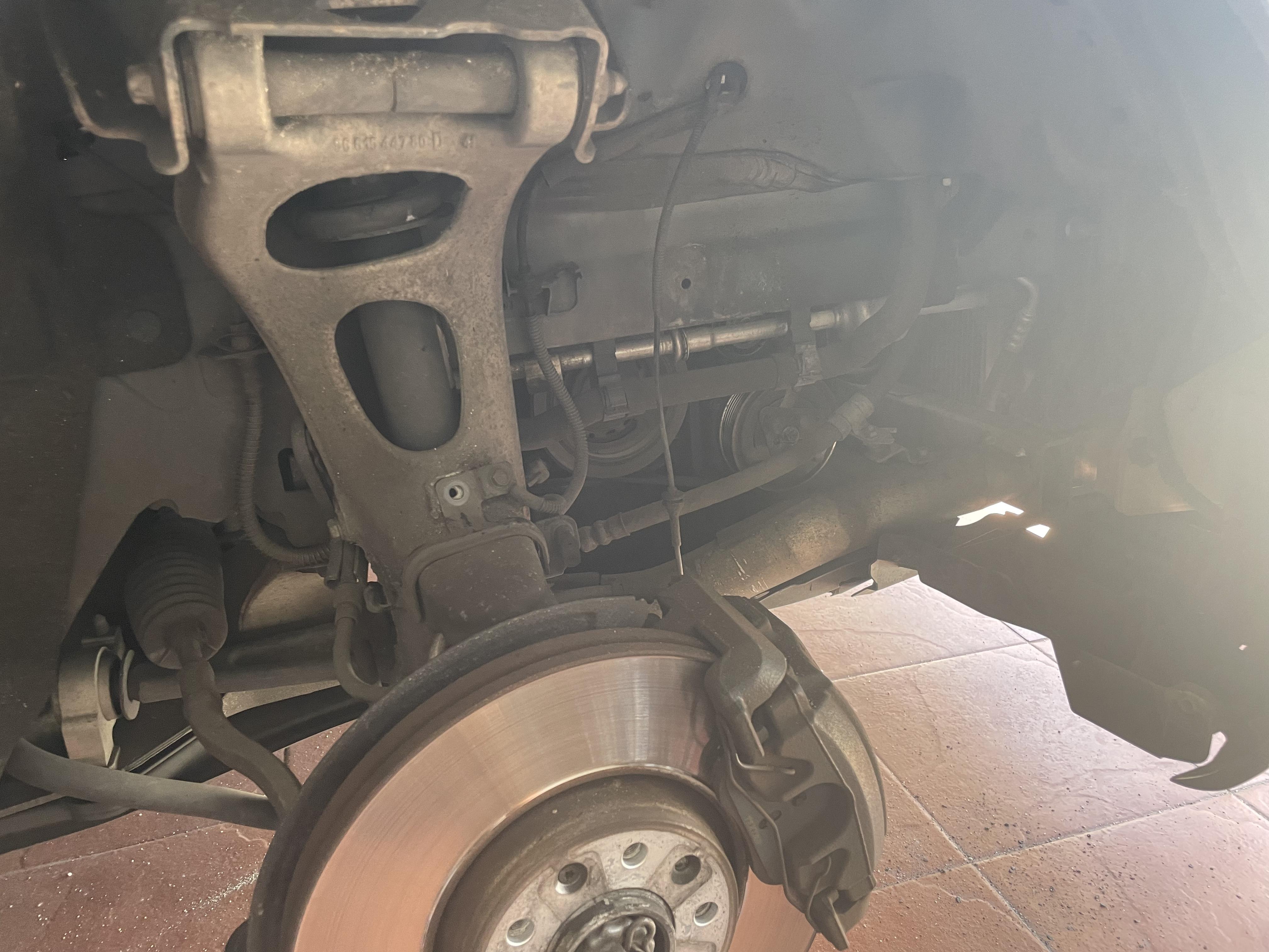

It's pretty straight forward to remove the sensor, it's only held by a screw, however I had to remove the wheel trim so I could reach the opening into the engine bay.

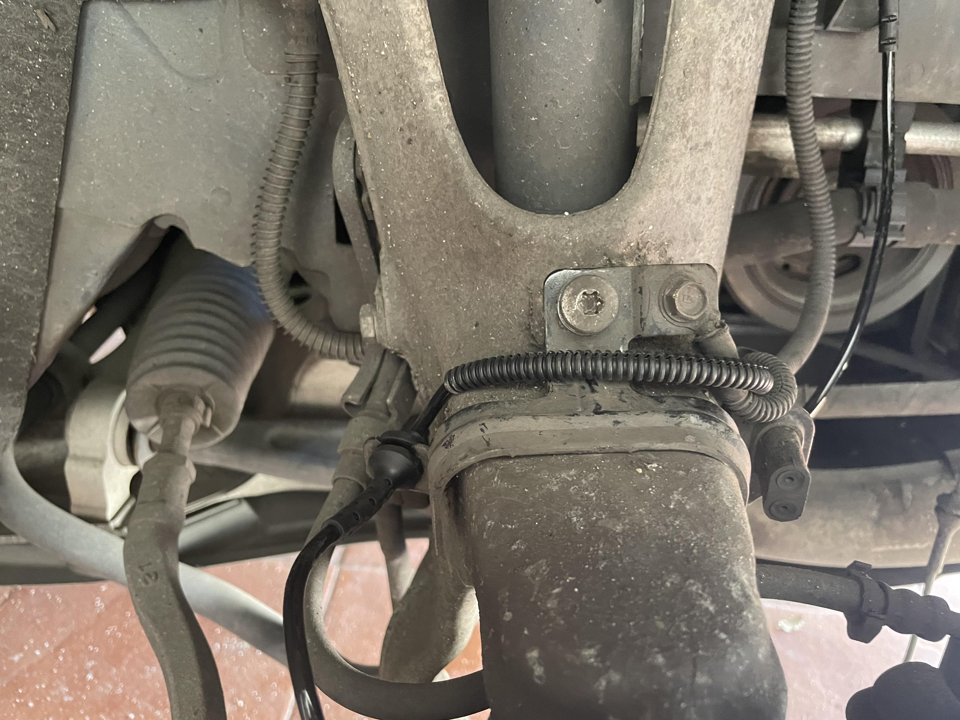

Running the new sensor is pretty straight forward, just run the cable and push the plastic bits into their proper fittings. I also had to remove the bracket shown in the picture.
