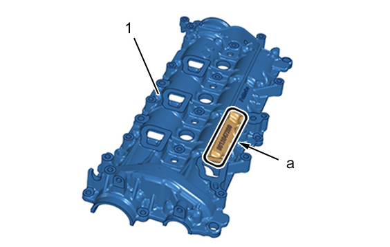

Locate and note the part number engraved on the camshaft carrier (1) (at "a") using a mirror .
If the part number is 9812647280: The internal combustion engine is fitted with a 7 mm camshaft drive chain: Carry out repair .
If the part number is 9830580480: The internal combustion engine is fitted with a 8 mm camshaft drive chain: The internal combustion engine has been modernised: Do not apply this document; Carry out in-depth fault finding.
N.B. : If the camshaft drive chain is noisy and the internal combustion engine is fitted with an 8 mm camshaft drive chain, send a dealer issue detection incident (DID I)
