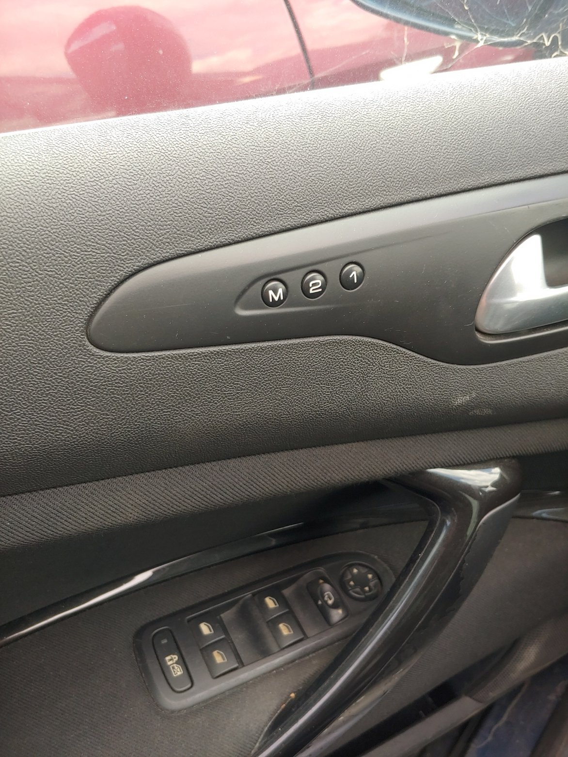

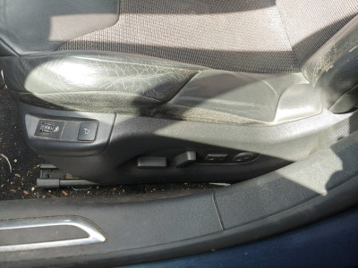

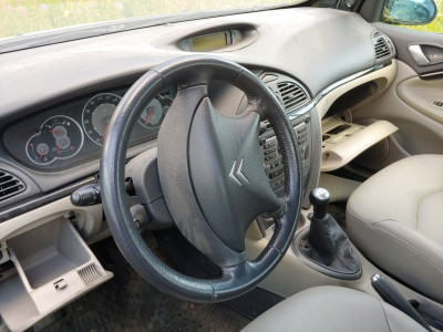

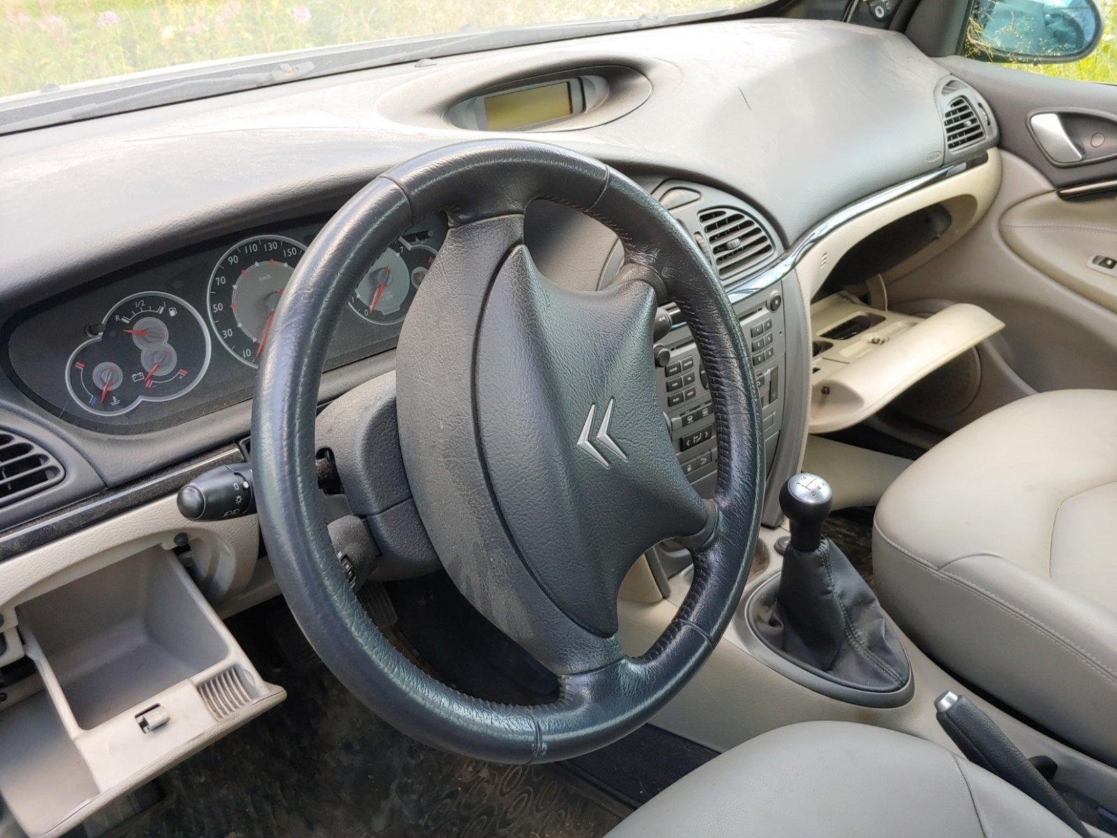

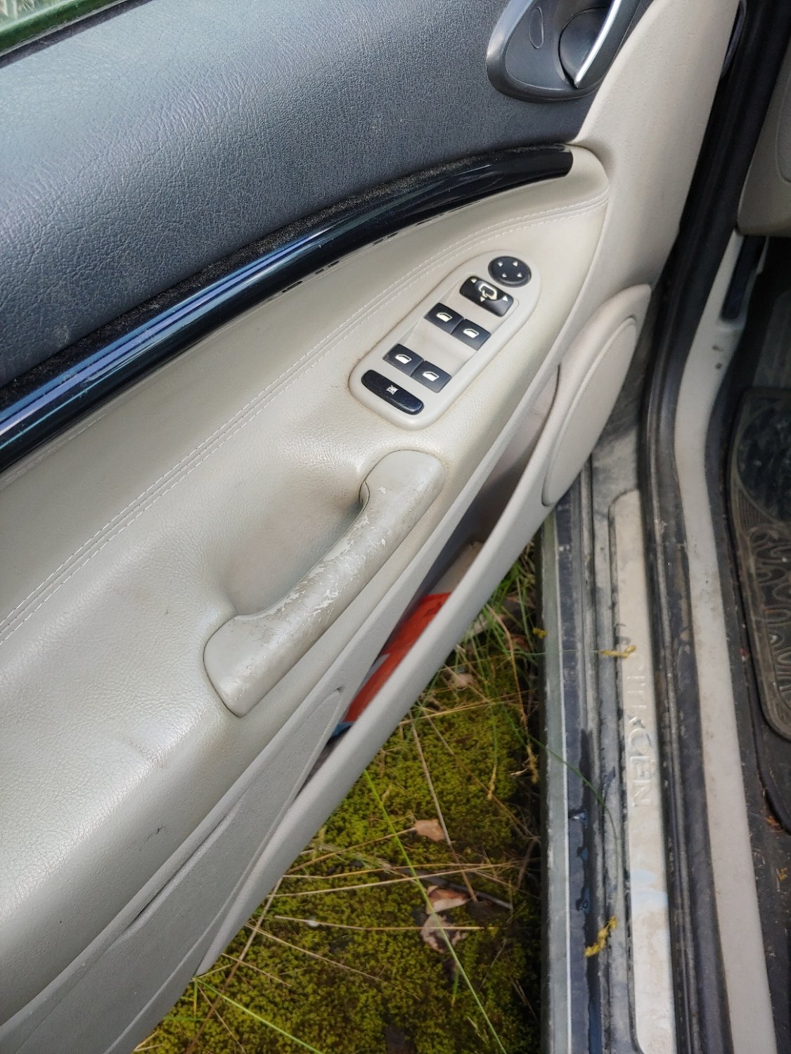

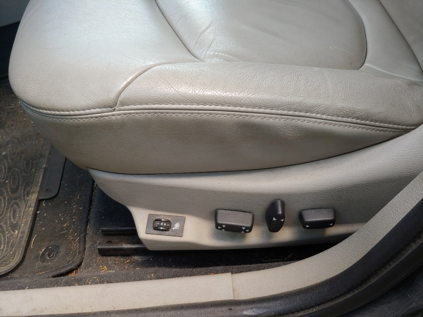

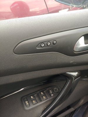

I'm asking since the Mk II (facelift) has beige leather seats, while the MK III has black leather seats that I like better and fits better with rest of the dark blue/black interior in my C5. The MK III also has memory buttons behind the door handle and airbags in the seats which might complicate things.

Forget a C5 Mk III, they have completely different systems to MK I / MK II models, including different control units and door modules and wiring, but the MK I and NMK IIs were pretty much similar.
