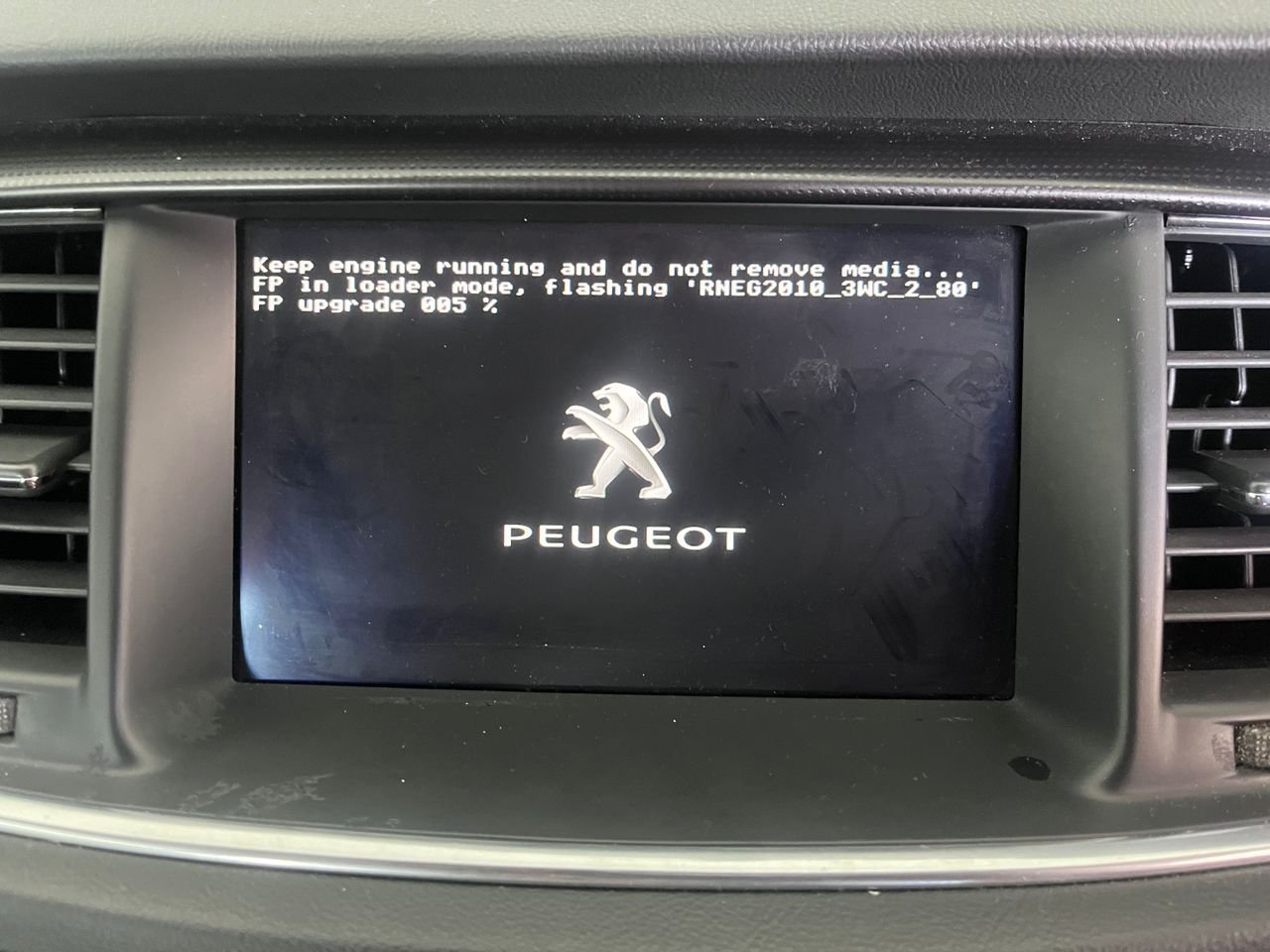

Hi. I own a Peugeot 508 2012 and my radio unit stuck in boot loop since last 2 months. I came across this thread/forum and did exactly as mentioned procedures. New SD card replaced, loaded the 2.86 firmware version on a pen drive. When i insert the pen drive for the first time after SD card replacement, my radio unit displays this.

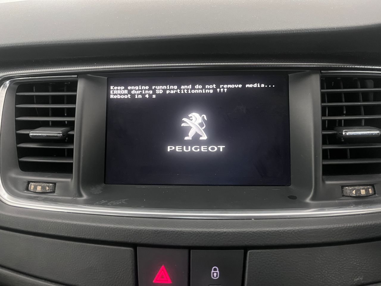

After that, the process continued and error prompted 'Error during SD partitioning' and starts reboot as the picture below
Both are Original and new SD cards are Sandisk 8GB.
Any help on this?
Any help on this?

Re: How to Replace the Internal MicroSD Card - RT6
I would first get a 16Gb micro SD card as you'll need this anyway with the later maps. Don't get an all dinging all dancing Micro SD card or you may have compatibility problems - get something of a similar specification to the original , but just a larger size and do not format it or put it into a Windows PC or it will populate the card with files. The Firmware will do everything that is necessary
