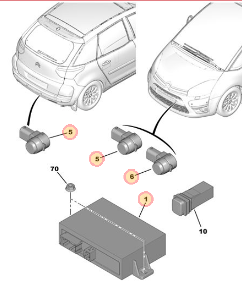

So your build date is 12785 (10 November 2011). If your car were originally to have had Front and rear parking assistance, then it would have been fitted with this unit:
(1) Parking Assistance ECU, part: 1606373980 (no longer available from Citroen), £557.12
(5) Sensor, part: 6590A5, £155.70
(6)Sensor, part: 1611735580, £169.51

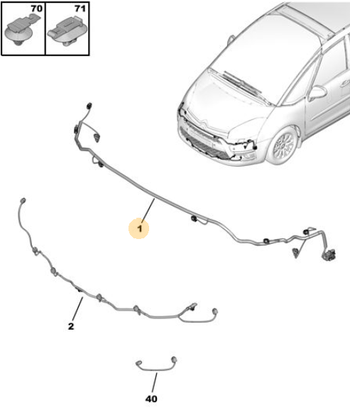

1. Is there any chance for the wiring harness to wire the front sensors back to the parking assistance ecu to be in place or do I have to get creative with this?

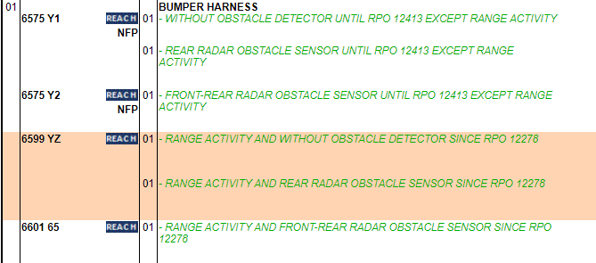

1) You won't have the correct harness.
Your harness is listed as 6599YZ for vehicles with or without rear parking sensors for your build date.
The version for vehicles with front and rear parking is 660165, £162.73
2) The ECU is located in the rear left side of the boot panel.
3) The odd sensors (6) on my previous diagram, I believe are the outer front sensors used for parking gap space measurement and that's another thing you won't have on the dash - the control for activating this.
