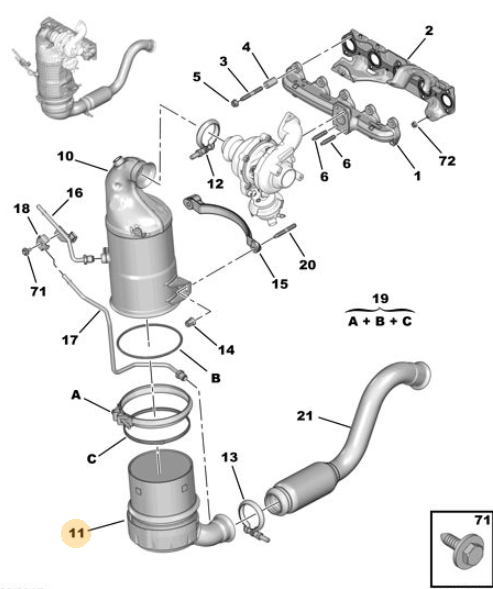

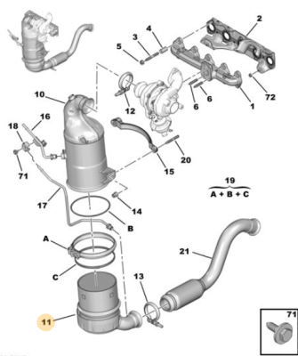

Hi Vic
Yes, according to the factory build specifications it should have one as just about all diesels did from that period going forward.
Not sure where you or others are looking - but if you are expecting to find it at the rear or mid-section like other vehicles, you won't see it, as it's part of the catalytic converter assembly, in the lower part, shown below at (11), and is in the engine bay, probably a vertical assembly, like mine

I've just had a look & it deffo seems to have the bit you show as 11which I thought was just the CAT. This then begs the question; does it require any addditive & if so where do I find the reservoir & if there is one how does one know what with & when to top it up?

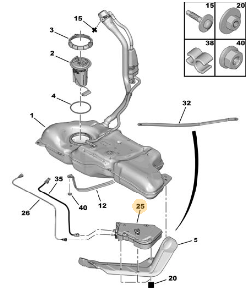

Here's the reservoir shown at (25). It is next to the fuel tank, protected by a heat shield. It is gravity fed and this vehicle requires 'Powerflex' additive specifically.
Normally you will get a warning pop up when the engine ECU determines that the additive is calculated as being low (there is no physical measurement / gauge).
If topping up, a minimum of 1 litre must be added, but it can be topped up beyond that. You will also need the additive counter resetting using Diagbox / Lexia afterwards.
