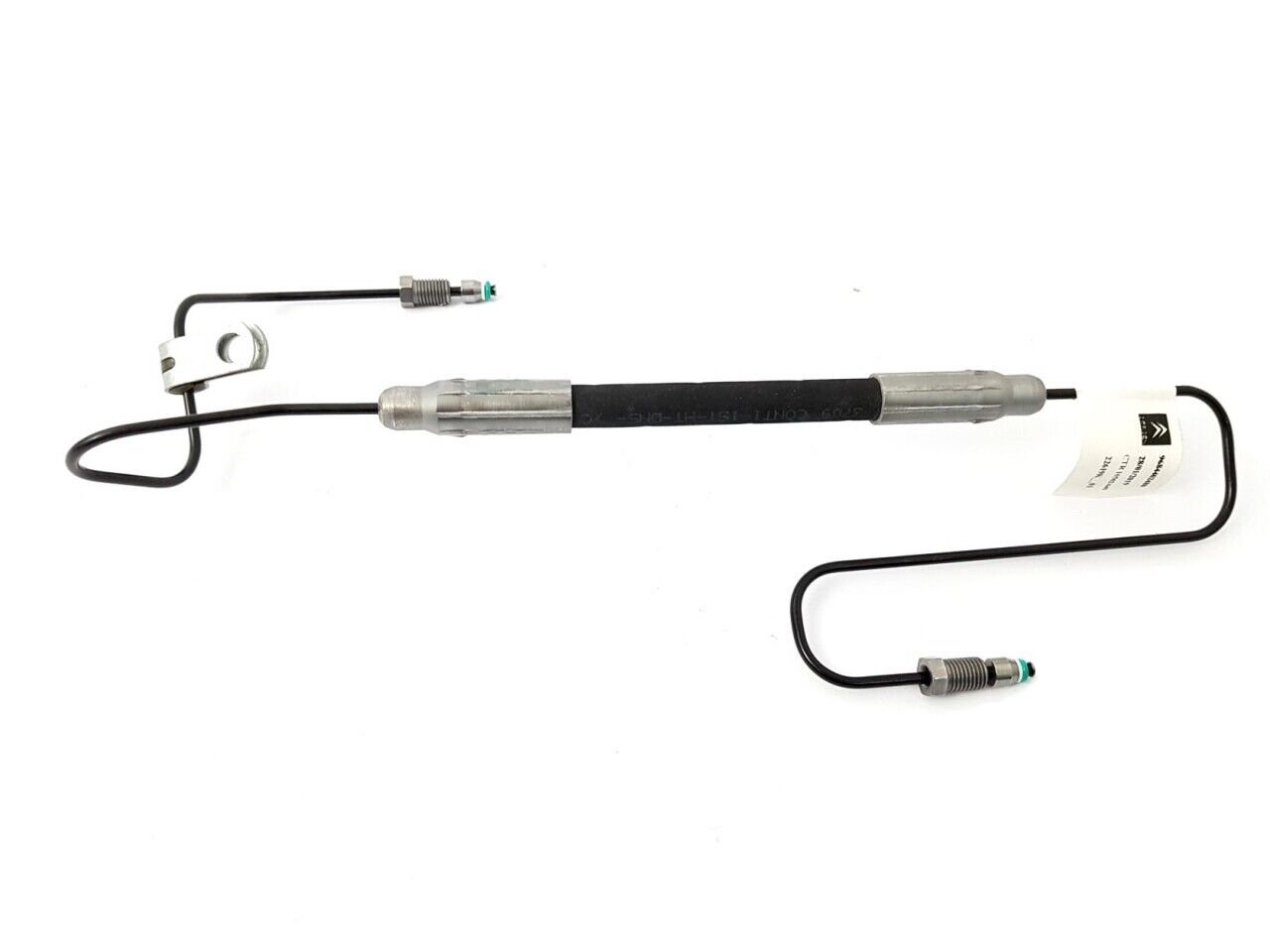

Cars are being scrapped because people can't get hold of the 5270VP hydraulic pipe which takes LDS from the long front to back pipe to the centre spheres.
I may have a source of these and of the pipes out to the struts and repair sections for the long front to back pipe.
Is anyone interested? I'm on the verge of buying what I need (from abroad).
The attached photo is of an original pipe, not the replacement. Cheers,
Mark

Hi Everyone, I have just come across this site while searching for a replacement hydraulic pipe part no 5270VP.
I note that in April a gentleman advised that he was trying to source these pipes from abroad.Has the search been successful?
If they are not available does anybody have a scrap one that can be copied. I was contemplating making some adapters to screw in to the female fittings on the car & then using a standard hydraulic flexible pipe to connect them together.
I have spoken to a MOT tester & he advises that this would be perfectly acceptable & would pass an MOT.
Your Comments welcome & any further advice. Stephen

I managed to get one of these into the country...
https://przewodyhamulcowe.com/przewod-h ... p-678.html
...and it fits absolutely fine.
I don't think they post to the UK though. I managed to get somebody I know in Poland to buy it and then it was like a game of pass the parcel by half a dozen people in the company I work for to get it across Europe

Hi Lenny
I am currently looking at other options but if all else fails would it be possible to import any more through your network of connections? Would you have the scrap one from your car for me to copy.
Thanks for your interest STephen

I have still got the old one but I was going to keep it for a spare as it wasn't actually in bad condition once I'd cleaned it up. The worst bit was a slightly mangled union as I had to resort to mole grips.
An MOT tester pointed out that it was looking corroded last year but although the black coating was flaking off the actual pipe was fine. So it's had a coat of epoxy and bunged on the spares shelf.

HI everyone who helped, I have managed to source a replacement pipe 5270VP from the manufacturer's in Poland, the biggest problem was getting it to the UK. It is a well made item & was fitted last week & is all satisfactory.
I hope this gives confidence to source items from abroad. Stephen
