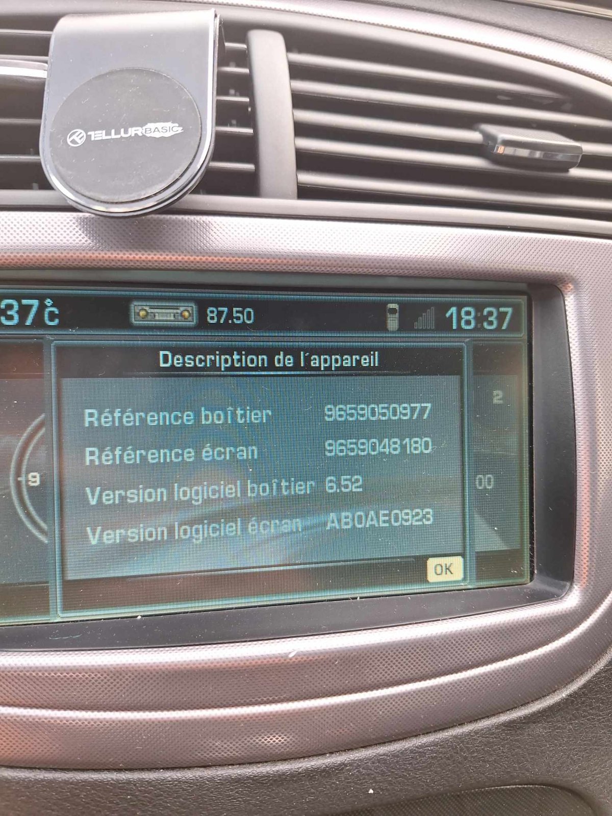

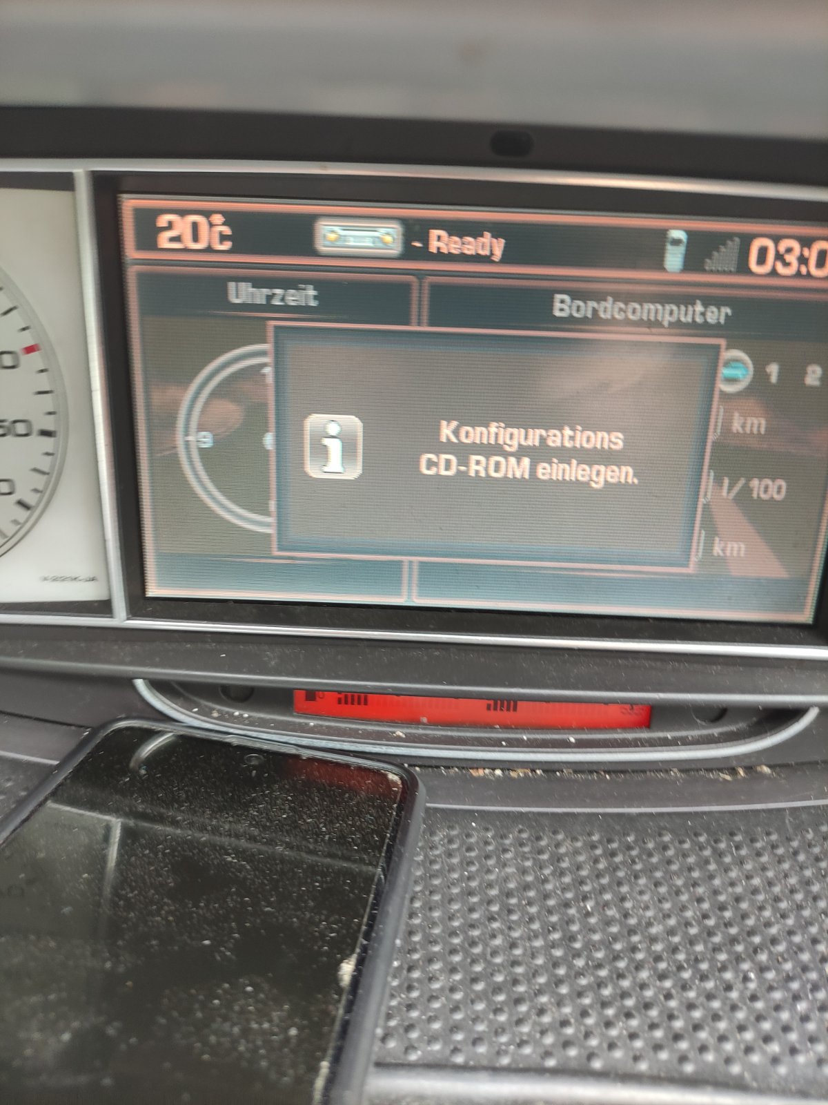

I have the same problem/request as above users. I have only "foreign language" in my case it is German. Could you help me to upgrade it to english?
I post a picture here:
- x 6956
Re: Change language RT3
@balintkelemen14:
You have a VAN system, so need a different firmware: - Check your Private Messages

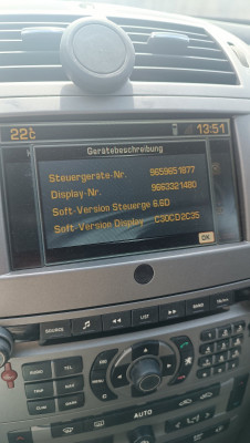

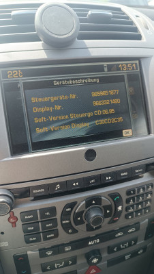

Hello users I have a Lancia Phedra 2007 and I would need the ISO - CD for this system.
Steuergeräte-Nr. 1400978777
Display-Nr. 9663922380
Soft-Version Steuerge 6.63
Soft-Version Display C30CE0C35
Thank you for support
Samuel
Samuel
- x 6956
@LanciaTCR: Samuel, check your Private Messages.

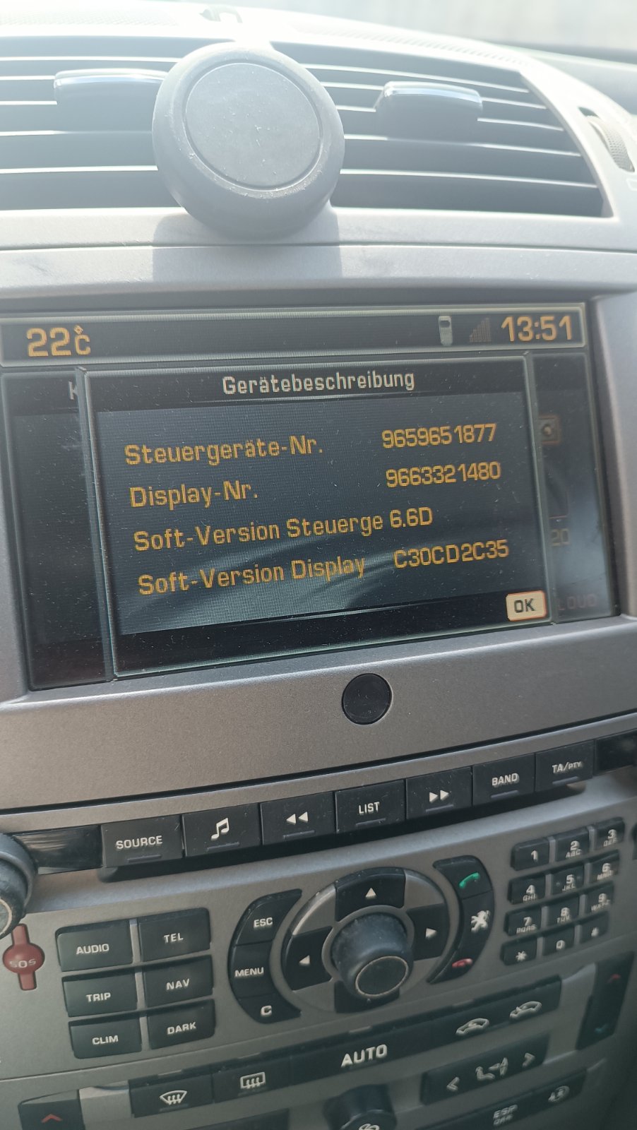

Hello guys. I have a peugeot 607 2005, and i cant find anywhere the CD to change language to english, can someone help ?
- x 6956
@Dustix: Check your PMs.

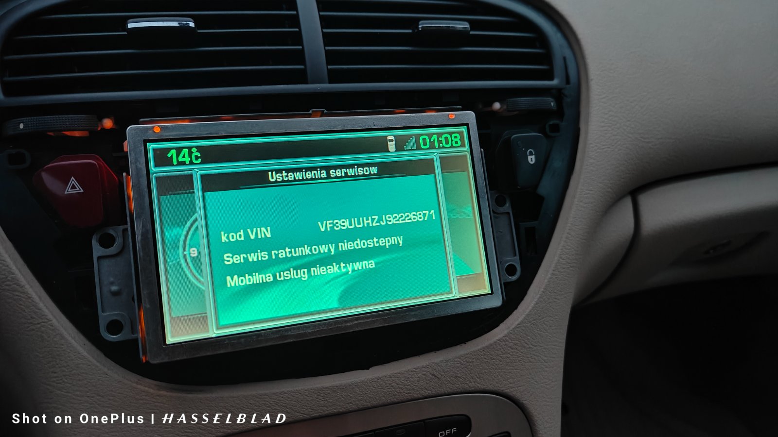

Hi everyone,
Could someone please help me with a link or how to get hold of a CD to change the language in my display from Polish (stuck) to at least English or best of all Swedish. I would be so grateful
I have a Peugeot 607, V6 Diesel 2,7 l, 2007
Kind regards
Håkan
Kind regards
Håkan
- x 6956

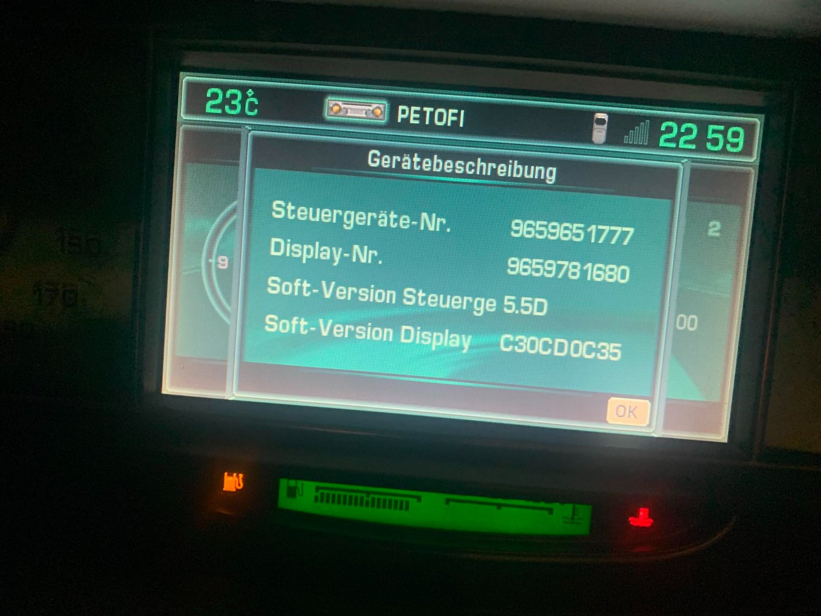

You'll need to let me know which system you currently have CAN or VAN interface. Does the current system software you have start with 5 or 6 (see the above images from other members). Provide this and your VIN and I'll see if I can assist.
Klarre69
- Posts: 2
- Joined: 03 Jul 2024, 10:10

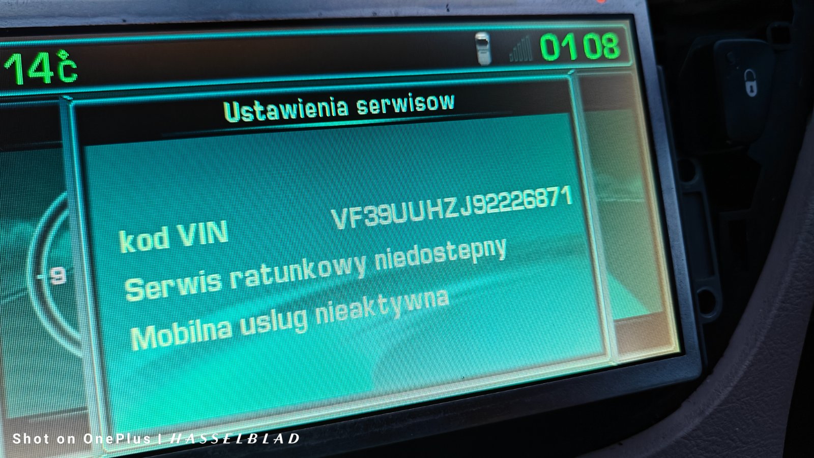

I really have problem with the Polish language and finding my way in the menus... The software version is very hard to find for me. But the VIN is on my picture now.
- x 6956
Ok, so you have the full CAN version. Check your private messages.

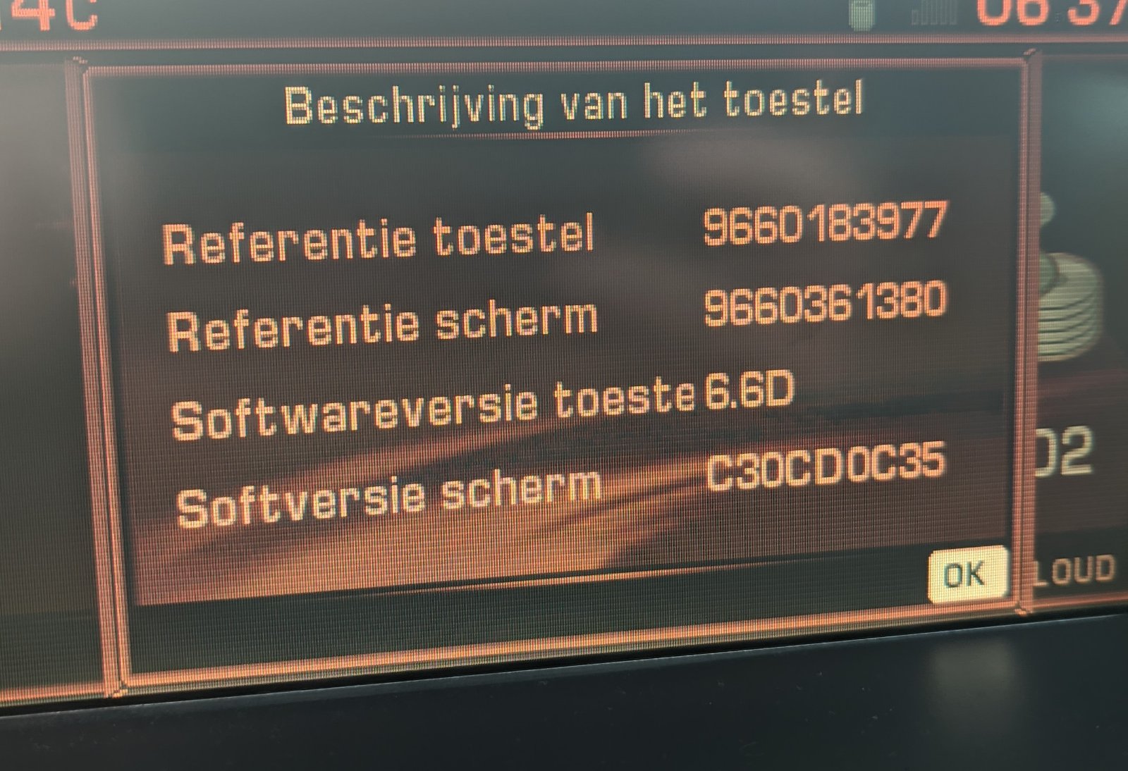

I'm an new Citroen C5 Exclusive 2006 owner from Estonia and need to change language to English. Any chance you could send me needed iso for CD?
Really need to change Dutch to English
- x 6956
@thenight: Re: your PM, I do read most posts, but we are all volunteers here and I have a life of my own too, so can't always provide instant responses....
You have the CAN version, so this is the ISO image CD, from which you will need to burn a CD-R from:
RT3 CAN Firmware ISO
1) Do not burn at more than 4X Burn Speed as this can cause file corruption.
2) Be aware that Windows may not burn the image properly - suggest using Daemon Tools or Nero.
3) Use a CD-R and finalise the Disc afterwards.
4) When updating, always keep the engine running (to prevent economy mode kicking in during the update) - so don't perform this update in an enclosed garage or confined space (poisonous gasses).
5) ALWAYS Remove the SIM Card in the RT3 before you begin the firmware update (an incoming call can brick the system during the update).
Important! The CD will be ejected several times throughout the update - do not be tempted to eject or remove the CD, switch off the car or do anything while it is updating.
The system will switch itself off and eject the CD several times, restart and carry on. Wait until it has completely finished, so be prepared to wait.
