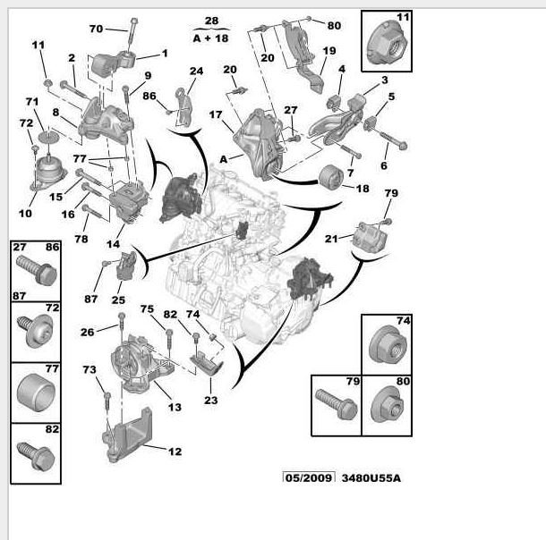

Morning :)
Does anyone have the part numbers and maybe an exploded diagram of the engine mounts, especially the rear one on a 2009 C5 X7 138 HDI FAP please?
I'm picking up some car ramps today so I can get underneath properly and see if/what the damage I may have done when the engine dropped after changing the lhs motor mount - big oopsie.

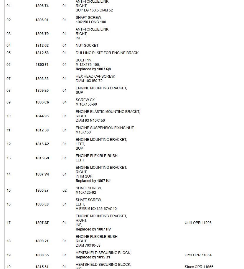

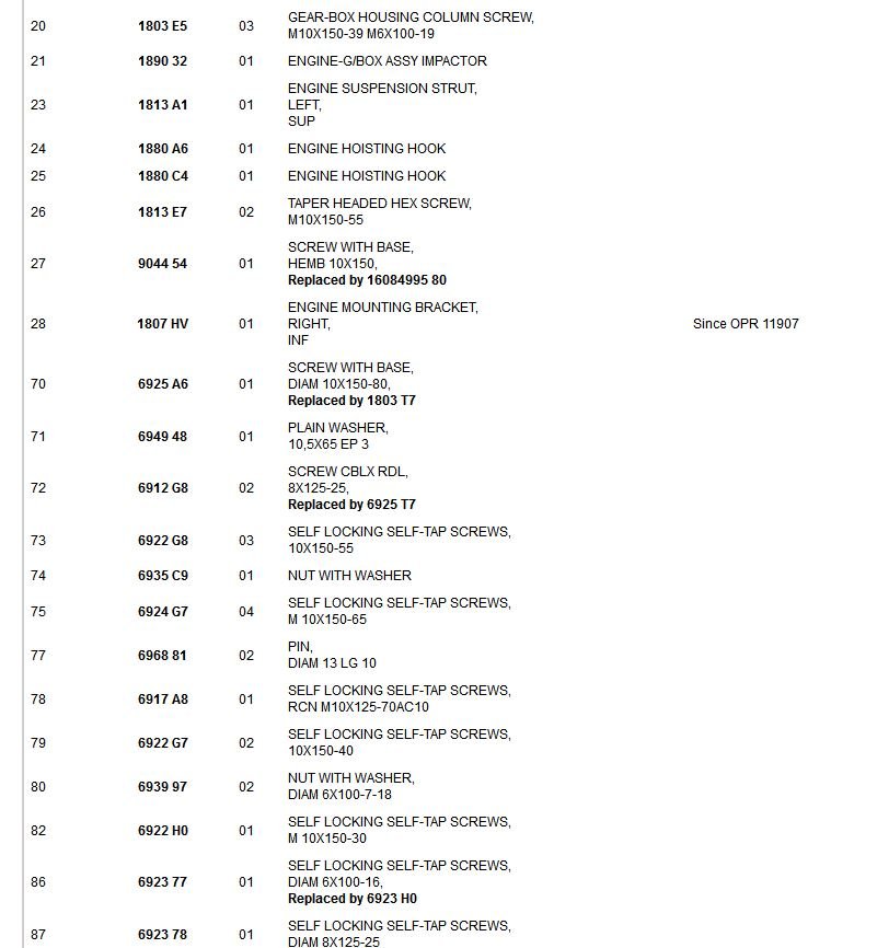

x 6945
Re: Part numbers/diagram for engine mounts - 2009 C5 X7?
steveclv wrote: 10 Jun 2024, 08:43 Morning :)
Be aware that the diagram posted above by 'Stickyfinger' is for an automatic X7 only with DW10BTED4 engine, not a manual and secondly, is 10 years out of date, so there have been some part numbers superseded.
It therefore should only be used as a guide if applicable to your specific vehicle. Some parts are no longer available either.
