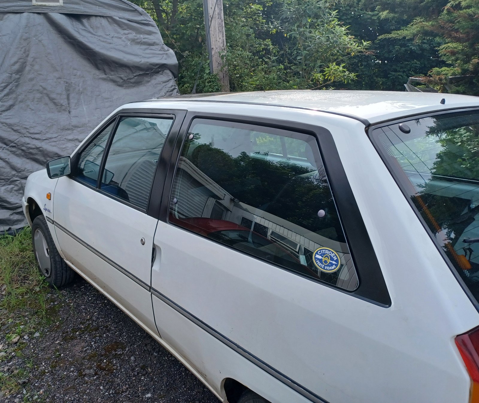

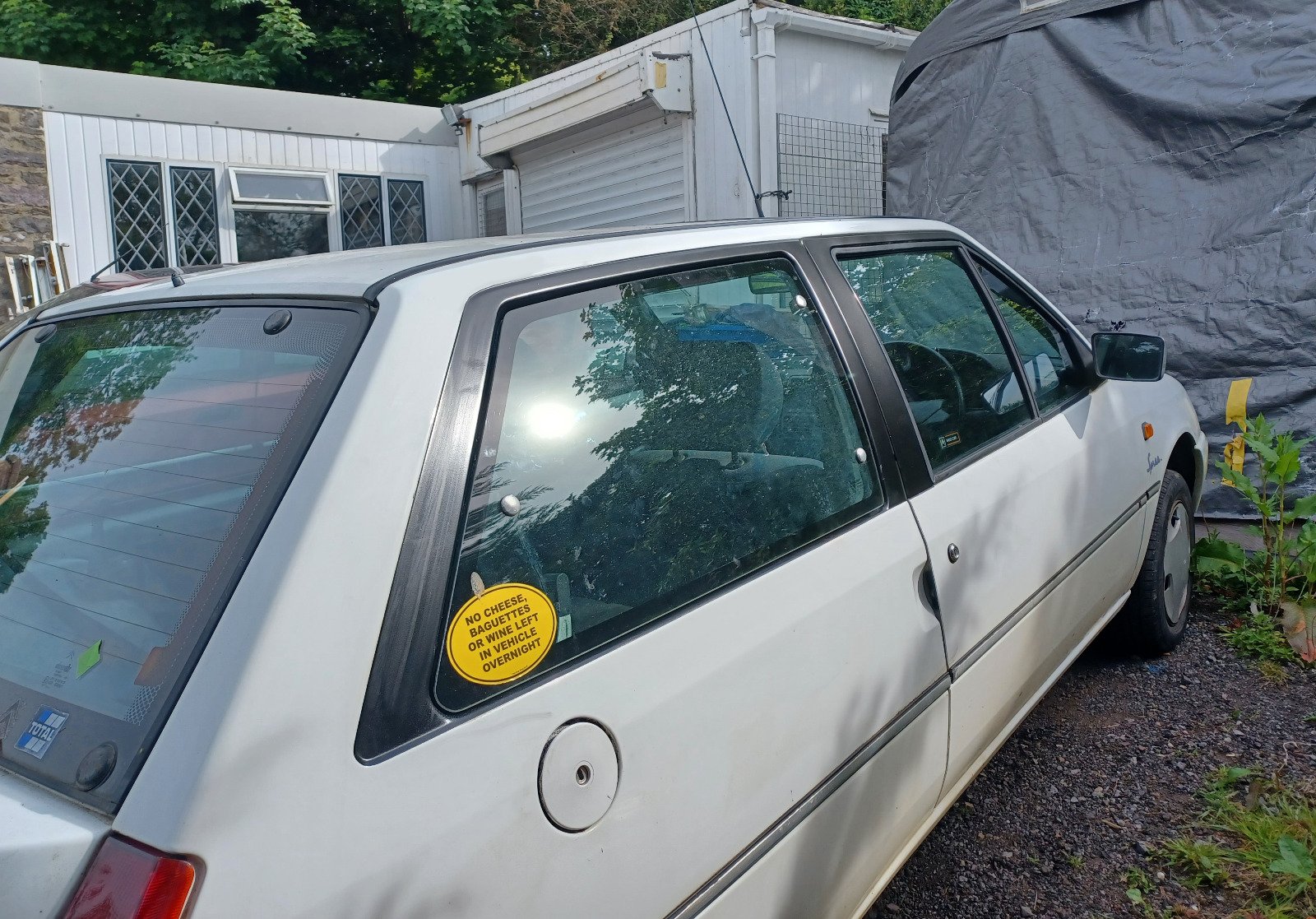

All done now.
I treated and painted the right side in the same way as the left.
Opened the seams with a thin screwdriver, used a thin scrapper blade to aid the capillary action to get the rust killer liquid in, filled those seams with ACF50, wiped off excess, painted with zinc primer, gray primer, Satin black to finish as a Mk1 type "flying roof......... filled the window seals with Bilt&Hamber S50 box section wax (thin) , used finger pressure to close up/tighten the seals, applied B&H S50 to the seams and then fitted the seals. Cleaned up the S50 that was pushed out with petrol on a rag.

Re: I am an Activaist-v6 and a 2.1Estateerr
Excellent work Alisdair, now Jim knows how to do it

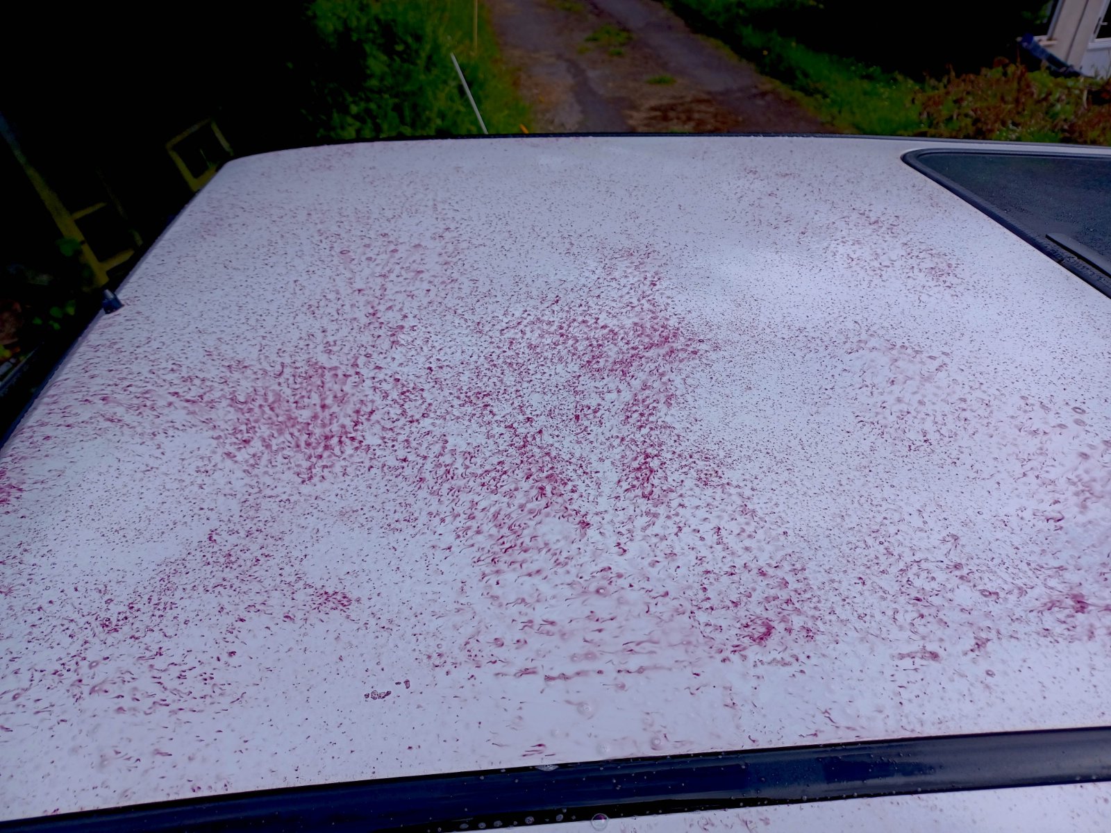

Bilt & Hamber Fall-Out remover.
Each speck is a tiny particle of metal from the grinding/sanding I did on the window seams....always amuses me just how much "dust" it makes and how far it travels in the air. It ruins paint and glass and is best removed. This was AFTER a jet wash !....it sticks like glue to paint/glass as it corrodes and you really cannot see it as it is so miniscule.
Double bubble cleaning also completed.

(I've next to no detailer type qualities!) is that "fallout" the sort of thing that "claying" the paintwork lifts?
- Posts: 11836
- Joined: 28 Mar 2013, 21:05
- x 1996
No, it is a liquid spray, it activates ferrous metals, lifts them and allows it to be washed away.....also used to clear brake dust etc.
Clay Bars are used (only after a VERY good wash down or two and rinse) to cleanse the surface of micro contaminants by trapping them in the fine clay as it is moved over the surface (wetted with water). The results of a good clay bar application are remarkable and are imperative before a machine "cut & polish".

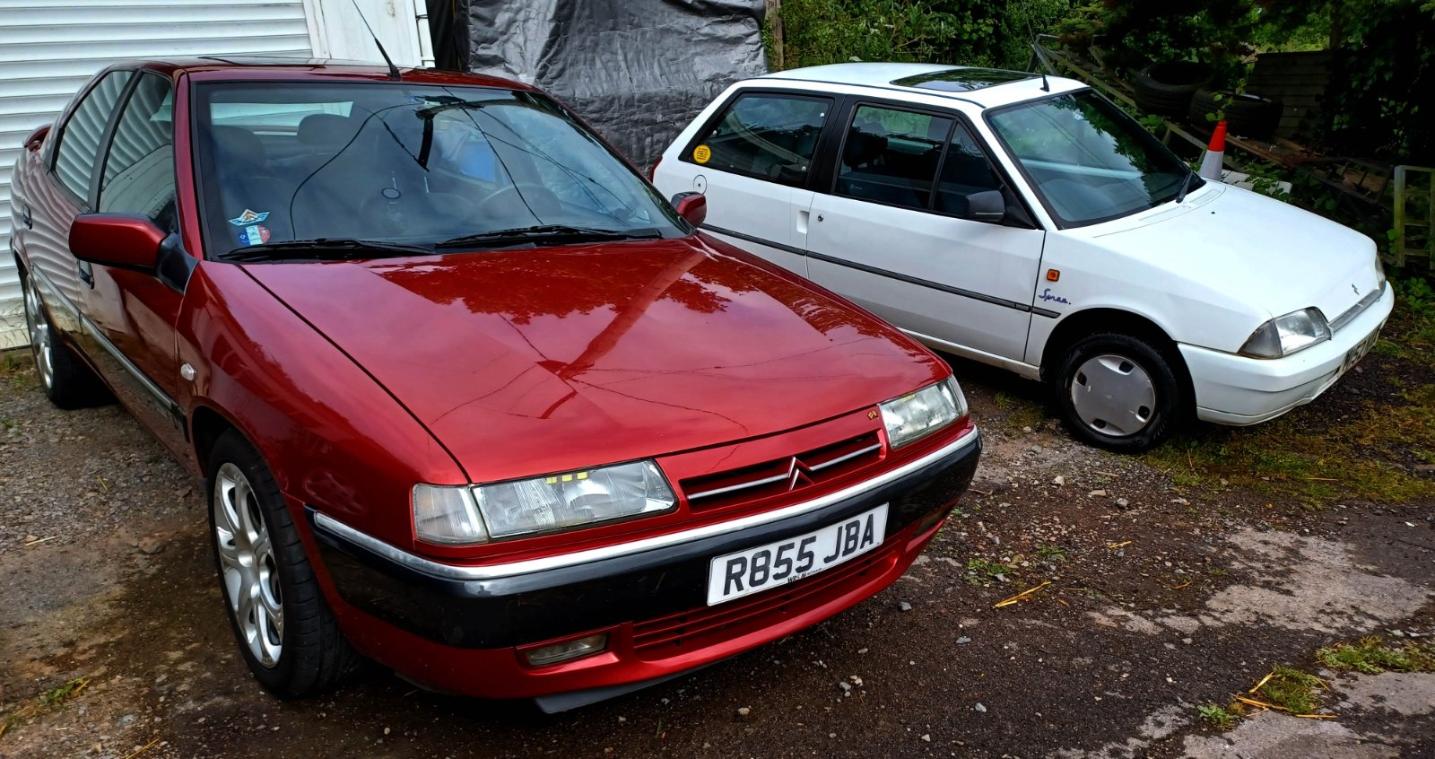

Re: I am an Activaist-v6,a 2Ltr TCTeerr and an AXerr
Field Recovery version of the AX
Needs a flashing amber light on her roof

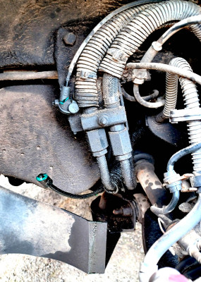

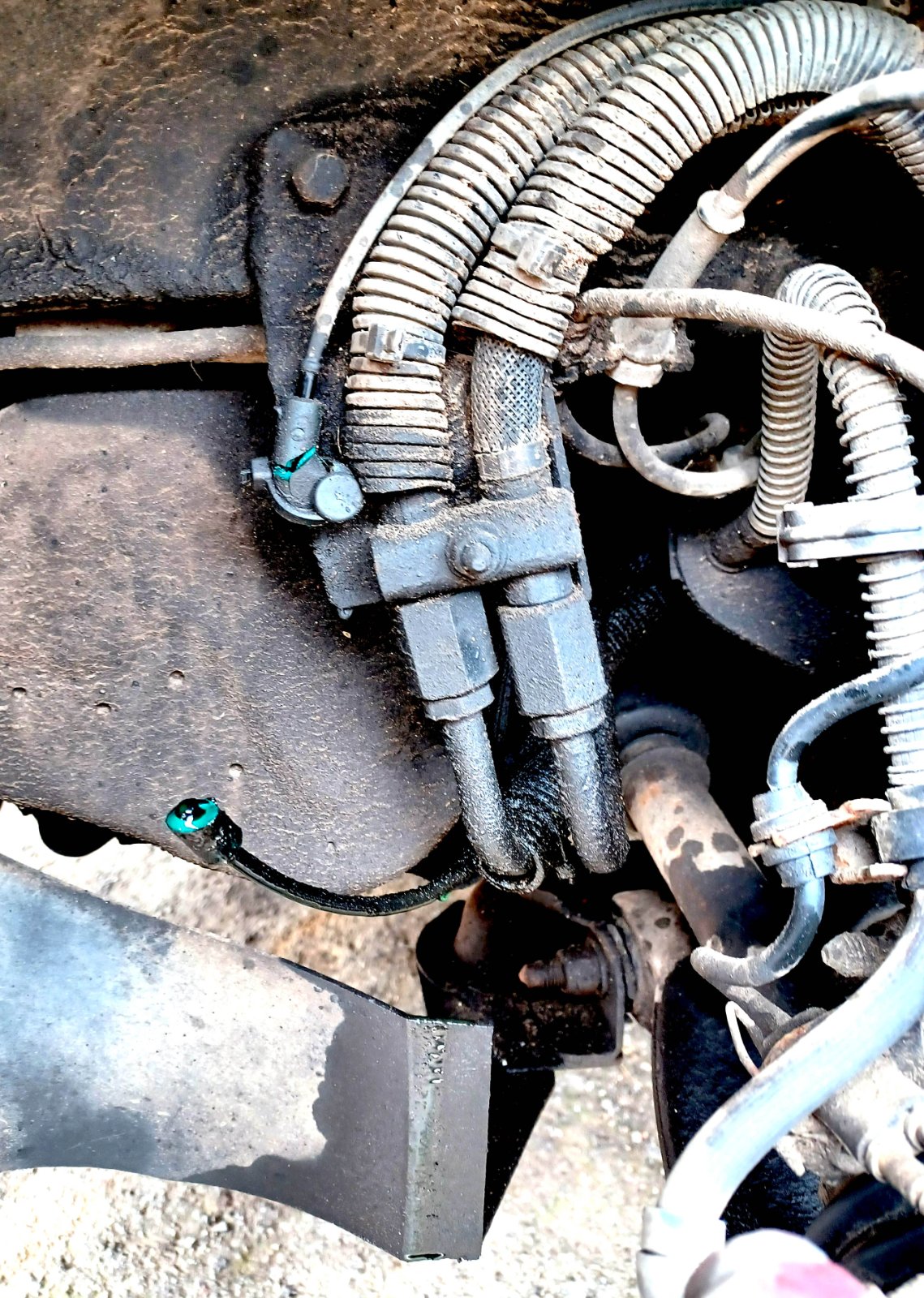

I wondered why my front wheel was wet...... now I know, return line from the front Active ram
Simple fix, I just replaced the disintegrated 2-Way connector
- Posts: 55087
- x 8391
A nice easy one to resolve for a change Alasdair

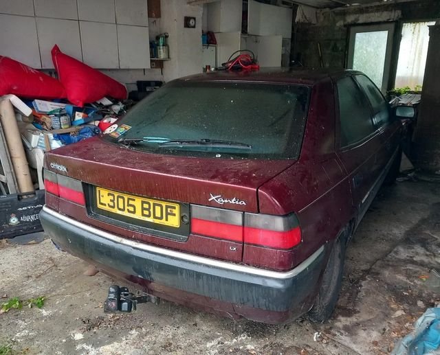

Gu@@er !... I have done it again !
Added "Old School" to the fleet. 1993 "sinker" Xantia 1.9td Lx.
.....not moved for 10 years, well it does now !
A few basic checks, topped up with water and with jump start cables attached away she went with almost everything found to be in working order. Rust-free so far in the normal spots..
Runs smooth (for a dirtyD), raises and lowers with speed, no leaks from Oil/Water/Suspension (yet
)....even the spheres are good !
Sinkers are quite rare old things now. It was owned by a ex MOD engineer so has been quite well looked after mechanically.
A small "scrape on the front right wing and a little "clip" to the leading edge of the rear (side) bumper at the wheel arch....both "fixable"
More to follow when I get it back to my place in a few weeks time....and YES, it is going to be DRIVEN out of its resting place and home AS IS !.........just for the fun of it

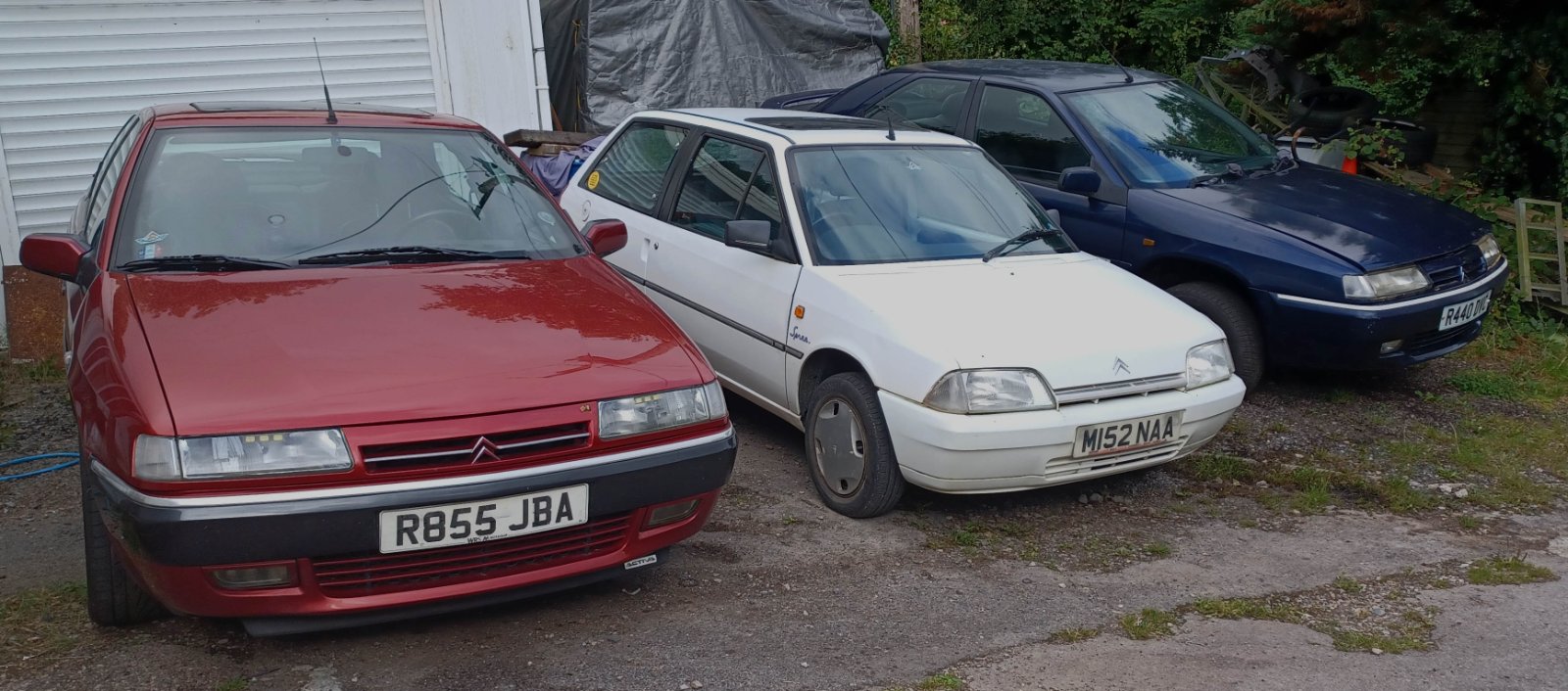

Tri Colore
Finally have a set

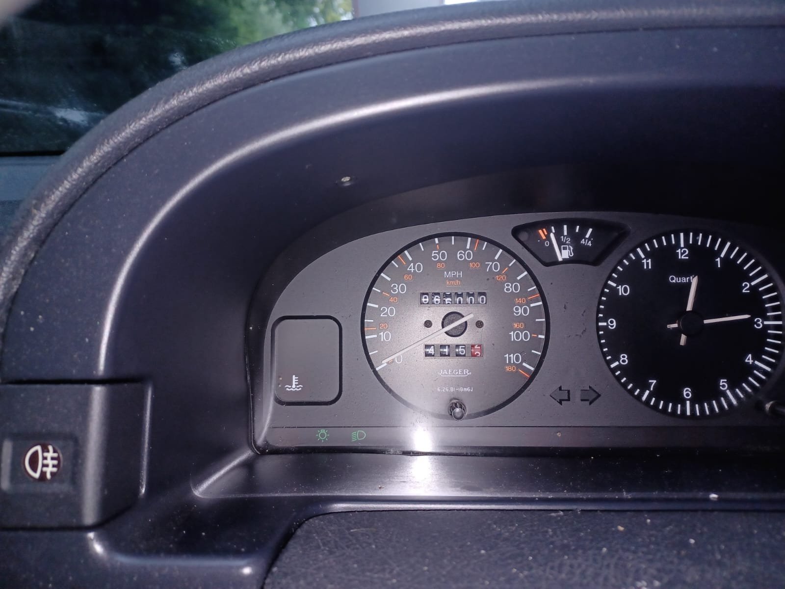

A Milestone reached for my AX.....and in 666 miles I think I will need an Exorcist
Caught it just before it changed to 66001
