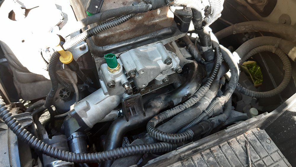

In some near point (end of the week perhaps) , I have to replace leaking thermostat housing of Citroen C3-mkII 1.1 engine. I think is TU1A engine. About 60-ish horses and one monkey riding the beast.
The body look like that:
and it is made from some aluminum alloy. The thermostat body is plastic.

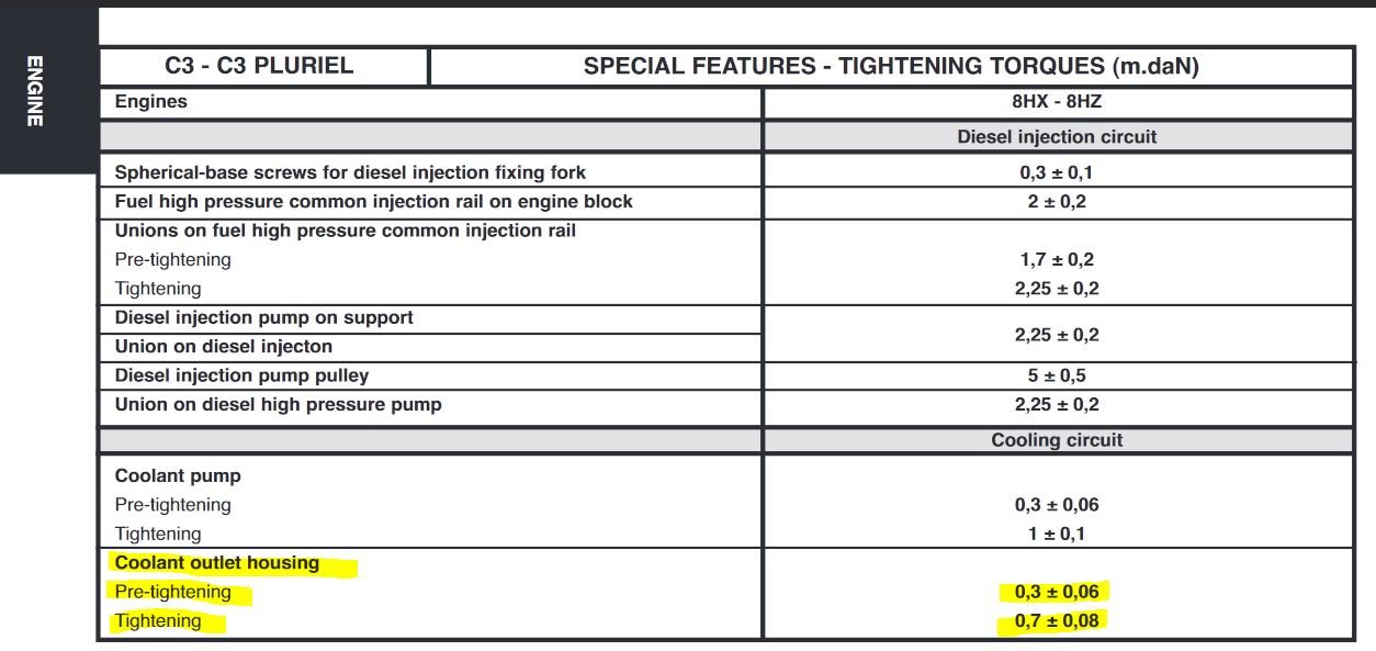

My question is about the bolts tightening torque. In the replacing manual inside the Citroen database it only show the order of replacement.
In some other manual related to C2/C3 found that one:
Unfortunately my small "regular" torque wrench start from 10Nm up to 25Nm and my electronic adapter I think is from 5Nm up to 200Nm (if I can trust it..)
So, is that 8Nm true? Even the plastic valve cover torque is about 10-13Nm.. Sure, some lock compound will be applied but anyhow that seems quite light tightening..

8Nm is 70 in/lbs. If I recall, the bolts are only M5, over torquing them may damage the threads in the cylinder head
Engineering spec for M5 bolt is 8Nm.

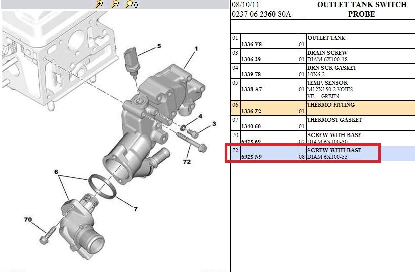

In the first post I mentioned that the housing body is made from Aluminum and I doubt a bit that the bolts are M5 because the holes for them in the body are 8.3mm in diameter.
They are just perfect for M8 to pass through, and if indeed they are M8 - then 8Nm should be quite low in my opinion..
Together with that part in the package arrive some soft polymer gasket for the body. No RTV or silicone should be applied in that case.

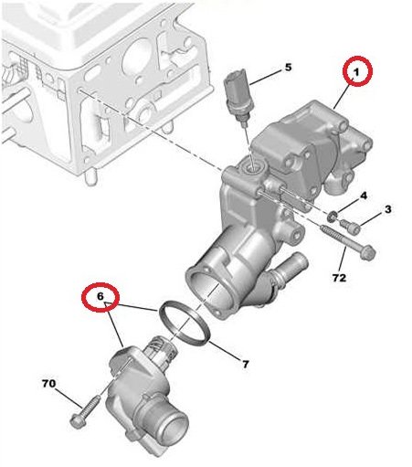

You`re right, the thermostat outlet is plastic with already rubber O-seal mounted. It screws are M6 in size and because is plastic make sense to be tighten about 7-8Nm..

You where right! The bolts are indeed 6mm...
Then it make sense this 8Nm quoted torque , but for me it make nonsense why the holes in the casting are made 8.3mm
Thanks for the participation!

As the table says there are 8 of those bolts clamping the housing and I guess they (PSA) are going for large(ish) numbers of bolts at a low(ish) clamping force rather than a few bolts at high clamping force?
Just for the kiddies playing at home, the thermostat housing has two separate chambers. Of course there is the cylinder head coolant outlet chamber. But also A chamber that covers the end of cam shaft and the camshaft retaining clamp. So the housing has to seal against oil and coolant.

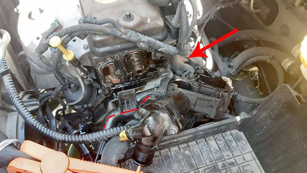

The original unit been made from plastic and there was small gap contour made where the RTV to be applied. As bonus seems oil and water been in contact because crack on that plastic shell.
Just for the protocol, that pipe marked with red marks is kind`a on the way and is difficult to work on the part. To get it a bit sideways one must remove the bolt that hold it to the engine block (red arrow) but to access that bolt the starter motor must be away..
Sure, I did not remove them..
The new one is made from alloy and come with a gasket. There isn`t any special area that the RTV should fit:
The bolts I tight with 10Nm on my not so precise torque wrench.

Yes, that's the water pump inlet from the radiator. There is one screw on the back of the engine block. You can also remove the inlet manifold to get to the screw too, but not fun.longgo wrote: 17 Jun 2024, 09:10 Just for the protocol, that pipe marked with red marks is kind`a on the way and is difficult to work on the part.
Someone went to town with the RTV!!longgo wrote: 17 Jun 2024, 09:10 The new one is made from alloy and come with a gasket. There isn`t any special area that the RTV should fit:
From the factory the alloy thermostat housings are sealed with RTV. From the factory the plastic housings have an integral rubber gasket. If you buy an after market version, well, you get what you get I guess.
But either way the plastic housing shouldn't need RTV!

Personally, didn`t bother - just slightly push the pipe, the rubber hose was removed and after removing the old unit, put the new oneozvtr wrote: 18 Jun 2024, 12:53 You can also remove the inlet manifold to get to the screw too, but not fun...
Well..it was with some sealant despite should be with rubber gasket. The new part contact surface was made straight.ozvtr wrote: 18 Jun 2024, 12:53 From the factory the alloy thermostat housings are sealed with RTV. From the factory the plastic housings have an integral rubber gasket. If you buy an after market version, well, you get what you get I guess. But either way the plastic housing shouldn't need RTV!
Not as water pump for example, or some cover that have small groove on it where the sealant will fit. Maybe on the OEM part is a bit different..
Anyway, both pictures are from the process and so far so good.. The car still move around..
