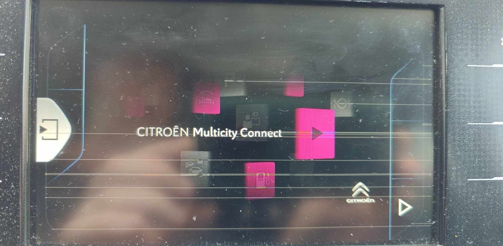

I have a Citroen Grand Picasso 2015 which have started to exhibit artifacting issues on the touch screen.
I should mention that I have installed an android auto box (ebilaen brand on aliexpress) which has been running just fine for over a year now.

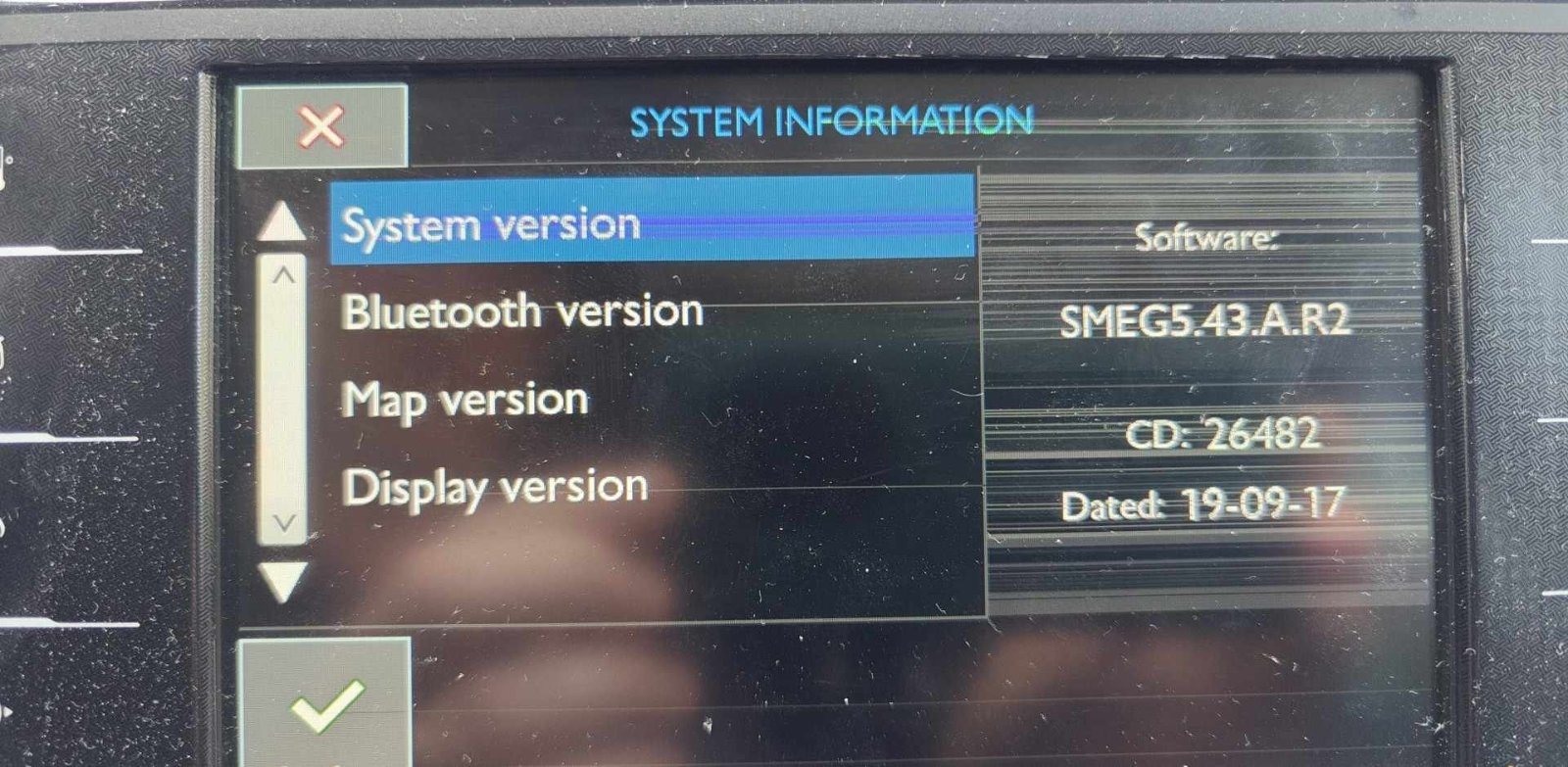

The touchscreen is running the latest software SMEG 5.43.A.R2 (2017).

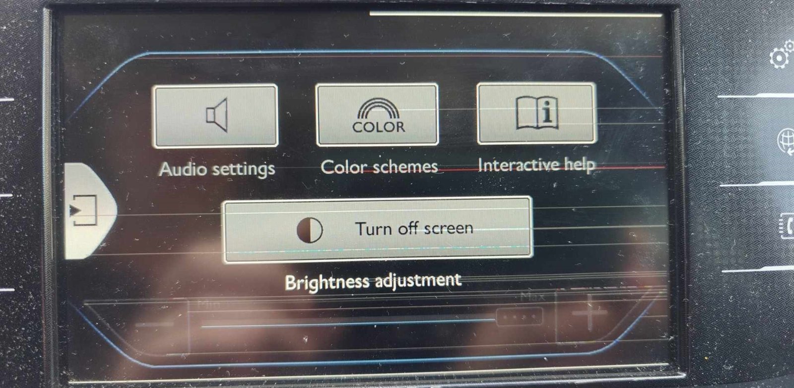

Those very evident horiontal lines appear on every page on the touchsreen and some of them are flickering a bit. They are not entirely static in nature.
When in a fault state I switch to the android auto user interface then 99% of those artifacts are gone albeit around 1% still appear but I have to look a lot harder for them.
The weird thing is that the problems do not always occur on every drive I do. The failure rate is maybe about 30%.
But once it fails I can see this very early on. In fact I can already see the horizontal lines on the citroen bootup logon of the touchscreen, eg. when I start the car in the morning.

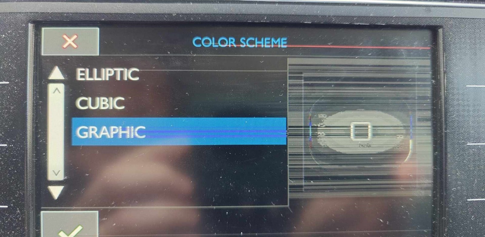

I also tried "rebooting" the SMEG screen by applying another color scheme. Did not help.
