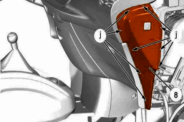

You should then be able to route it down and out of the A Pillar and then into the end of the dashboard, where the ends have a trim panel that can be removed, which will give you access to the inside near where the BSI is located and should facilitate a better access to the fuse box and a suitable earthing point on the vehicle body.
Here's the end panel of the dash:
Just use trim removal tools to remove this, but be careful as this contains the passenger airbag deactivation switch shown below. Just work your way around and then disconnect the electrical connection from the inside to remove the panel.:
That should give you better access to the fuses.
