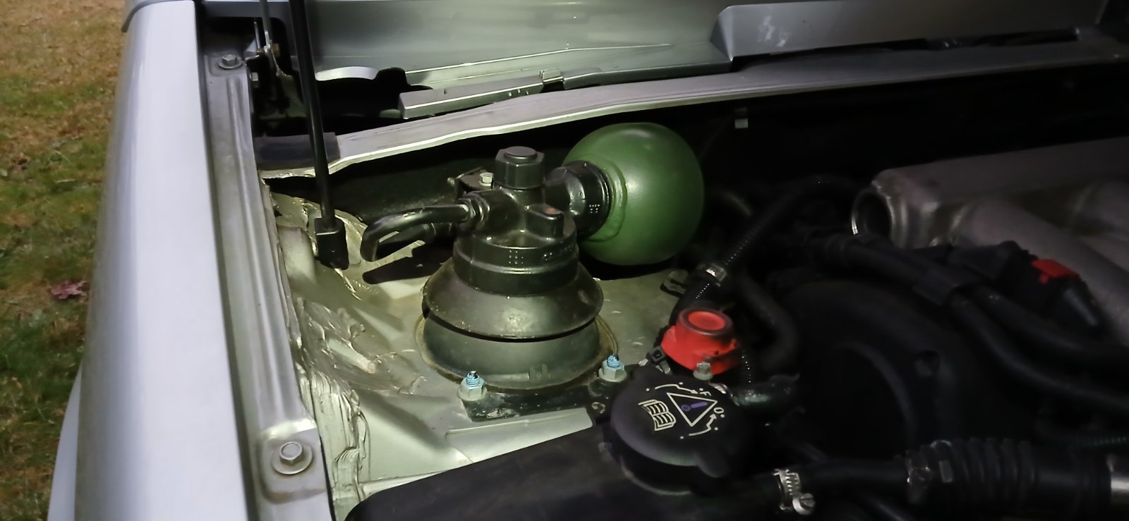

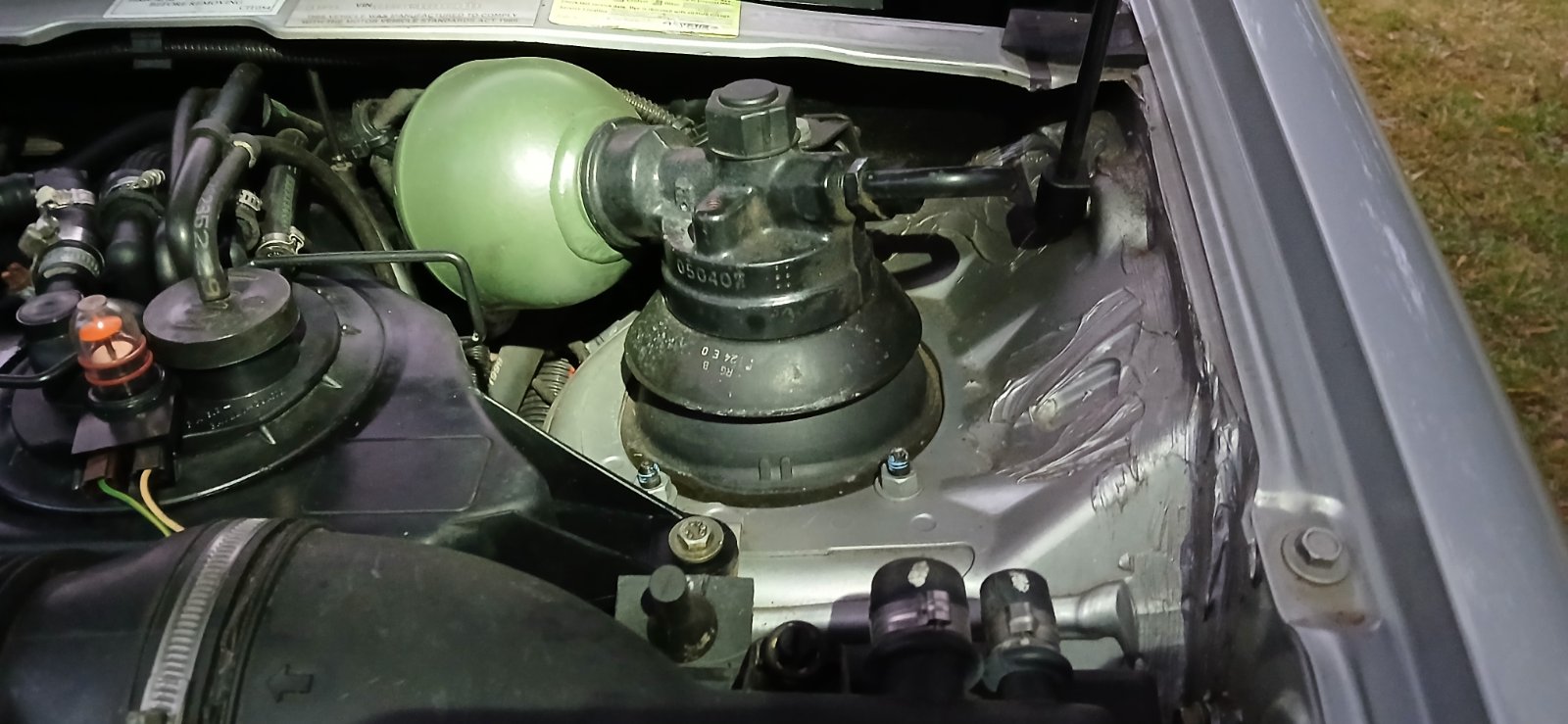

Can you take a photo of the engine bay showing both spheres and the alignment with the firewall seams behind? (With the weight of the car on the struts).

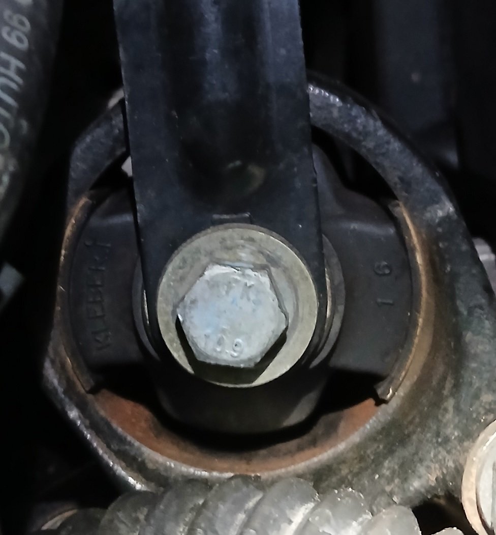

While you are there, check the condition of the rubber of the top engine mount ES9), as they often tear and elastomer.eu can also refurbish those.

Hi Mike
Here is a comment from David S on Aussie Frogs re. change to strut tops:
"The mounts were modified around 1998 by extending the centre tube an inch or so and adding a steel rim around the bottom of that tube to stop it going through the mount. The steel rim replaced what had been a formed rubber rim on the original to retain the gaiter."
It may have even been a bit earlier than '98 - I had a strut top fail on a '97 Xantia (VSX, Turbo CT) back in 2012. It was much worse than this one, but held together. The bonnet survived...
Re photo - sorry, ran out of light, here is the best I could get with phone and torch:
Can't pick any difference - broomstick sits level, so I think I must have caught it at an early stage of failure.
Also a photo of the engine mount - now I look at the photo, it does look like it's past it's use by date (I want to replace all the mounts - feel there is more NVH than I would expect).
