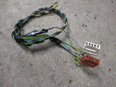

On a side point, during the door panel removal I must have knocked some of the wires out of the electrical block that goes to the back of the window switch and have now also got to reconnect some wires into the grey coloured block that plugs into the switch, see pics of grey block below (not my car just an example).
I know which order the 5 wires go in and what way up the block goes but does anyone know how to open these blocks up to reconnect the wires? Have never seen these connector blocks / plug to switch before but there must be a way of opening them up to reconnect wires?

Just to answer my own question, I have found out how the connector block that plugs into the back of the switch comes apart, see pic below:
Am waiting on the cables for the window mechanism and have got about 4 jobs lined up to do on it, should get it all sorted again in a couple of hours.
