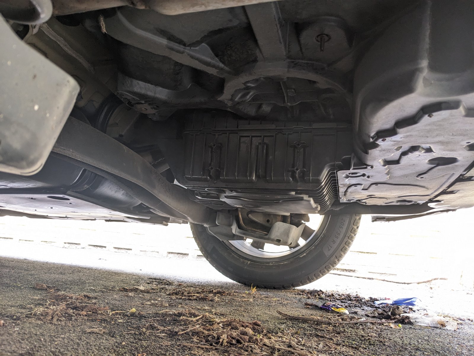

I've checked and I appear to have Tank A (square one)
What is the difference between the two available part numbers for tank A?
New Original OEM Tank, replacement part number: 1682619980, £1022.04
Standard Exchange Urea Tank, part: 1682615480, £817.63
Which one should I be going for?

Basically, the more expensive one is a brand new OEM original unused one. The cheaper one is for a used / reconditioned one that has been repaired.
