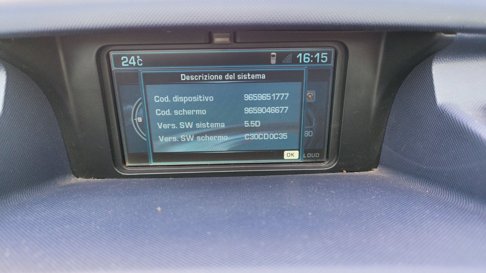

Hello,
Just bought C2 VTS from 2005
VIN VF7**************[VIN obfuscated, can be read by forum staff]......
soft version: 5.52.A-2
Have original CD, but not working, maybe because its a 5.5D version
Thank you

Re: Change language RT3
There are VAN and CAN systems which are not interchangeable. You must use the correct software for the correct version or you risk bricking your unit.
If you don't know which system you have, please post your VIN in full without spaces - it will be automatically masked from public view after submitting your post & will only be visible to staff.

Hello Marc,
Its a VAN. Which is the latest firmware?
I found 5.52 and its ok. Is this one the latest?
Thank you
x 6957
Yes 5.52 is the latest for VAN Bus Systems. Just select language from main RT3 Menu, and insert CD when asked for, follow instructions and system will restart and you should have the preferred language. Eject CD.
