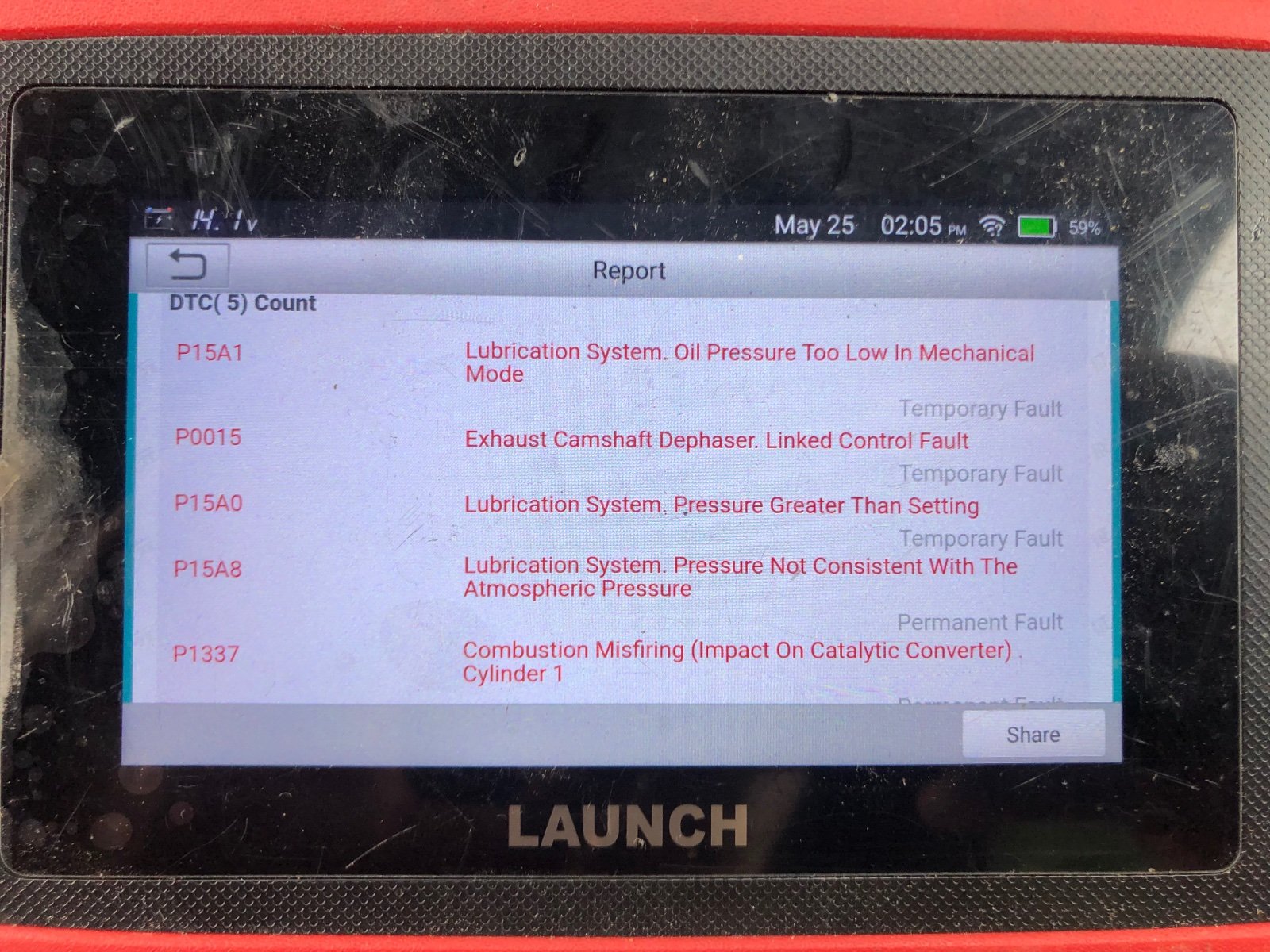

When I first got the car I had attached fault codes present. All of which have now gone after being cleared and test drove, but the smoking still persists.

If I'm reading that right that the car has electronically controlled oil pressure (waaaaay out of my wheelhouse this new of a thing) then the pressure faults (Particularly the P15A8) would have me looking at the oil pressure sensor/it's circuit. Not 100% sure, but if the pressure is electronically regulated then a fault with the sensor could possibly cause extremely high oil pressure if the car "thinks" it's low, and this in turn could cause oil to bypass the turbo seals. (and possibly cause issues with other pressure actuated things such as cam phasers, al la P0015
Failing that, and assuming the oil pressure codes to be spurious/resultant faults then I'd be looking into the cam phasers and mechanical timing (recent cam belt job = potential for mistakes)
The cylinder 1 misfire could be a seperate issue, or may be oil fouling related. If it was my car first thing I'd do would be to pull the plugs and see what they tell me, try and diagnose the misfire issue as a start & then find out the procedure to check the oil pressure with a mechanical gauge (may be as simple as teeing into the sensor port but would want to confirm this)
