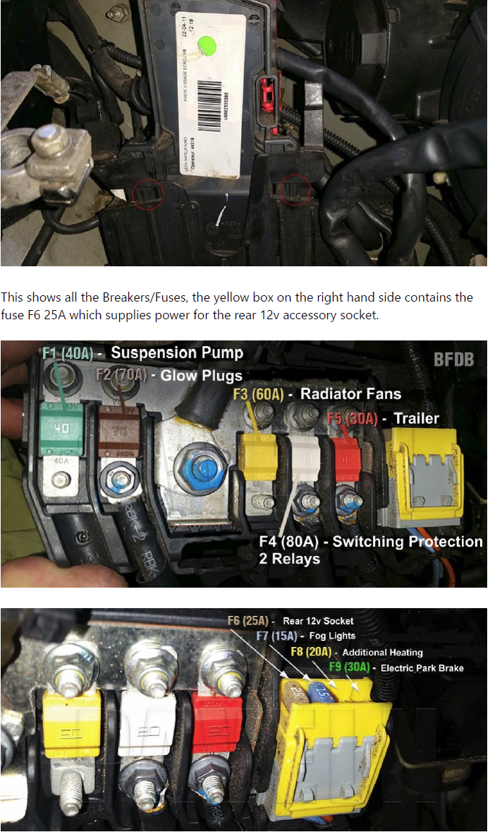

Hi all, today my suspension pump stopped. This day was always going to come!
I raised the car to high to aid in the access of a rear parking sensor - got that out no bother. Lowered the height and carried out some citearobics just because it had been a while since that was done and it will no longer activate the pump.
Already checked the easy things: 5A fuse, 10A fuse - both ok. Connected the Lexia and it had temporary fault - something about comm with BSI. It allowed me to erase that. Carried out BSI reset.
Still dead. There is always talk of another fuse. A biggy, 30 or 40amp - I'd like to look at this next but don't know where that is?
C5 X7 my turn for suspension pump stopping...maxi fuse location?
Graeme M
- Posts: 12537
- x 1477
Re: C5 X7 my turn for suspension pump stopping...maxi fuse location?
They're usually under the engine bay fuse box.
Hi,
At the begining of May I had the issue with the suspenssion. It occured that fuse was blown. It was the one in the box with the red cover next to the battery. I found nice pictures of them which are in the .png file attached.
Hope this would help
Thanks, I see now where that is.. going to have a look.
Thanks, that 40a fuse has blown.. Thanks for pointing me in the direction. Now to find why it blew
The main reason that this 40A fuse blow good be, pollution inside the motor by the brushes.
Yes, I have removed the BHI parts and cleaned the motor internals and dried. It wasn't very bad looking. I have a spare pump from a C5 1 and the inside of that was all black oil slick. I'll return to the job tomorrow and see how it ends up.
Hi Graeme, Sorry your citroen is playing up, there is another thread where someone had that fuse blowing, and was adamant that the motor was clean inside, so I suggested they'd be looking at chaffed wiring between the fusebox and the relay, which is located beside the right headlight near the radiators, or between the relay and the pump. disconnect the multiplugs from the BHI, and check for continuity from the fuse to earth with a multimeter.
Hi thank you! yes I removed the LDS tank, BHI motor/ pump unit, battery and midi fuses housing. I then removed the pump motor brush assembly and found it to be a bit grubby but not full of oily black paste as I expected. I cleaned it with aerosol degreaser and compressed air and checked all 4 brushes moved on their sliders. I also cleaned the motor commutator and with a stanley blade, cleaned any grime from between the copper segments. I also cleaned the magnets as they were a bit grotty but not as bad as the spare C5 pump motor. I put it all together again but ran out of time yesterday so returned first thing today with only the LDS refill and battery reconnection to test it out. It is running fine now but I will keep watch that it does continue to work. If it fails again I think I will certainly look at chafed wiring but I don't think any of the wiring harness has ever been disturbed since the car was manufactured.pi14 wrote: 25 May 2024, 10:08Hi!aerodynamica wrote: 24 May 2024, 23:38 Yes, I have removed the BHI parts and cleaned the motor internals and dried.
