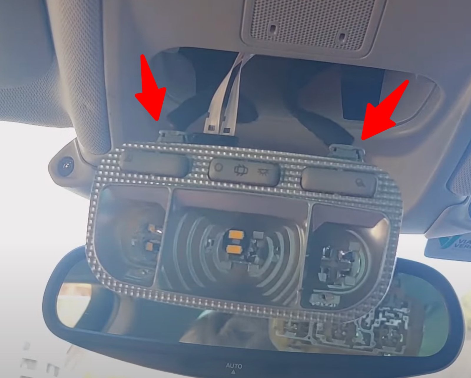

So I am installing a dashcam and it came with a cigar lighter adaptor to a USB C connector but I didn't want the wire hanging down so I purchased a 12V-5V DC converter to USB C from Ali and took the courtesy lamp housing out to locate the DC converter. This is where it got interesting as I am guessing that the lamps are controlled by the BSI so nothing simple LOL
Anyway, in the middle of the lamp housing is a 4 pin connector and then there are two 2 pin connectors, one on each side. The pins inside the lamp housing for the 2 pin connectors go 12V live when the engine is running - any idea what they are feeding?
I spliced into one of them - with the dashcam powered up the DC converter draws 300 mA so I don't think that's going to cause any problems but I'd really like to know what those two 2 pin connectors feed so I have some idea of it's standard current draw.

These are the 2 connectors that I am talking about if that helps.

Re: 2009 C5 X7 courtesy lamp wiring is confusing
This is just a guess but to me it looks like they are probably the connectors for the two outer switches in the panel which, again I'm presuming, operate the map/reading lights? Just a thought?
Thanks Mick - actually they are controlled by the 4 wire connector however I have discovered that the 2 x 2pin connectors go 12V live when the engine is running to feed the illuminated sun visors and so I feel that I am not overloading them with the additional DC converter for the dashcam. It actually makes for a very neat install
