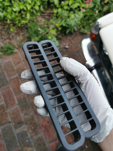

I found another huge amount of rattling was being caused by these grilles in the frame.
I did faff about for about half an hour using several methods to try to shut these up, but eventually just opted to delete them for now. I just couldn't get them to not rattle.
Next step will probably be to seal them in place with some flexible sealant. That's a job for another day though.
Again, a great improvement. Still rattling though. Plus squeaking.

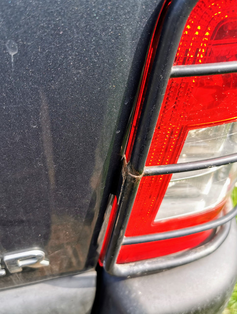

The squeak was very clearly coming from where the tailgate was touching the guards on the tail lights.

To be honest the tailgate is the one thing I'd really like to change on this car in terms of design. It's huge, heavy and unwieldy, and it doesn't really surprise me that a bunch of clips have broken. The split van-style vertical doors on the Caddy were miles better. Required half the amount of space behind me to open (it's only a matter of time I reckon until I smack myself in the teeth opening it), and was far easier for loading the dogs. I've come back to load shopping on several occasions where I've had to pull forward in the space to give me enough room behind to open the tailgate and load my shopping. Yes, the car style tailgate does make it more "car like" in the eyes of the buying public (and it's obviously cheaper) I'm sure - but I'd far, far rather have seen the rear doors of the cargo van version there. Guessing that was never an option though. I'm certainly not aware of ever having seen an MPV variant Parlingo with a split vertical rear door.

Is the body molding different between Berlingo Van and Berlingo Car versions? Or could a pair of van doors be fitted to yours?

I don't *think* the actual pressings are different. Wouldn't surprise me though if there were things like strengthening plates for where the hinges would mount which simply weren't fitted to the car variant.MattBLancs wrote: 22 May 2024, 07:55 Is the body molding different between Berlingo Van and Berlingo Car versions? Or could a pair of van doors be fitted to yours?

If it was a simple swap I'm sure more people would do it! I'd definitely consider it myself as it would be a big quality of life improvement I reckon.

The fixes on the tailgate have definitely vastly improved the number of cabin rattles in the Partner. I've been running round like a headless chicken last couple of days trying to get everything I need to before I head away for the weekend tomorrow, so have done quite a few miles in it last couple of days.
