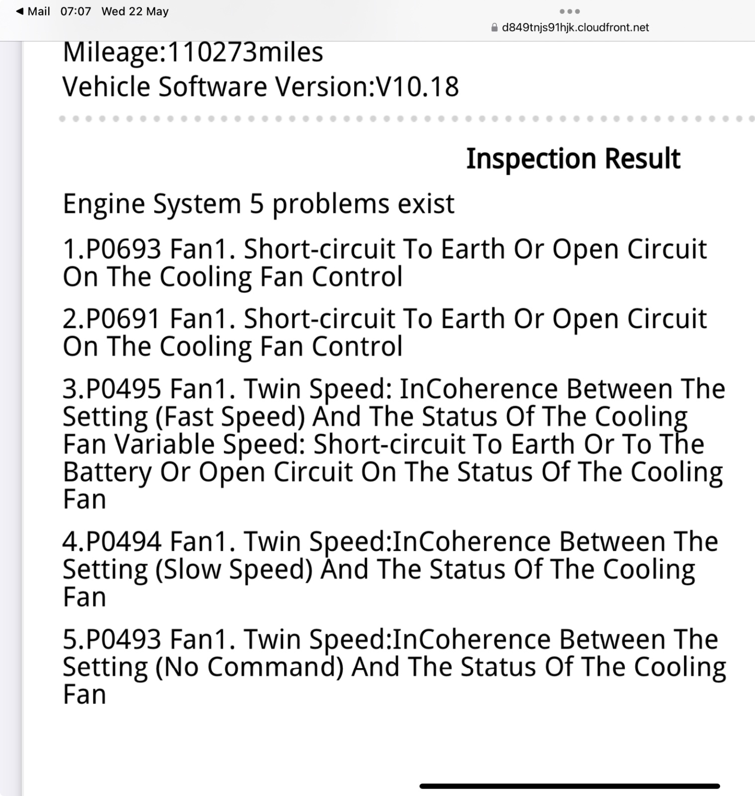

Hi All,
I recently acquired a 2014 C3 Picasso with a few issues.
There are no DTCs coming up on the dashboard, but my ArtiDiag800BT has picked up P0693, P0691, P0495, P0494, P0493 as per the attached report.
DTC Report
DTC Report
All looks to be associated with the fan control side of things and I’ve replaced the 1529 fan resistor unit which was badly corroded and the varistor open circuit. However, after clearing the codes, they reappear.
So, more work to do, but looking at the codes, I’m thinking it looks like a status condition issue with the actual status not getting back to the ECU.
Do you guys agree or am I barking up the wrong tree?
Thanks in advance,
Pete

UPDATE:
After disconnecting connectors from the fan and fan resistor relay unit, ECU, I couldn’t see anything obvious like a corroded pin or loose wire etc.
As I had to go out, I reassembled everything and out of idle curiosity ran a diag with my ArtiDiag800BT, fully expecting the DTCs to reappear after I cleared them.
However, whatever I disturbed seems to have done the trick and everything is working as it should - DTCs cleared! :-D
Occasionally, I actually understand what I’m doing, however, now is not one of those times! #-o
